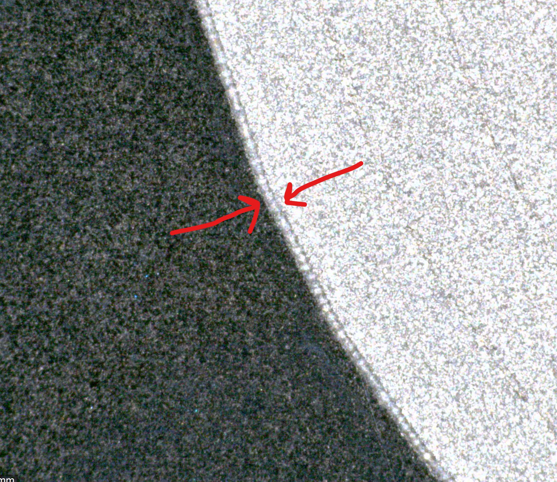

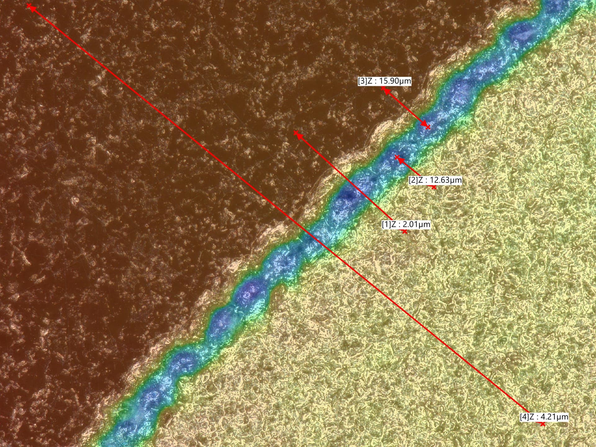

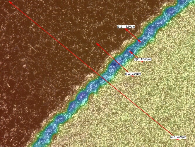

We are also using a 30W galvo for precision laser engraving for an industrial application. In our application, we are seeking to achieve a precise and uniform depth of engraving with good surface finish.
In prior tests, we found a deep valley outlining the perimeter of our engraved shapes. We measured the valleys to be 10-15 micrometers deep, and the depth was proportional to the number of passes. See picture below showing the edge valley at around 12.6 micrometers deep.
We surmised the cause was due to the galvo slowing, stopping, and changing directions near the edges at constant power. This led me to investigate setting the TCON and TCOFF settings, and I used the test designed by dannym to set these values. We ran these tests on stainless.

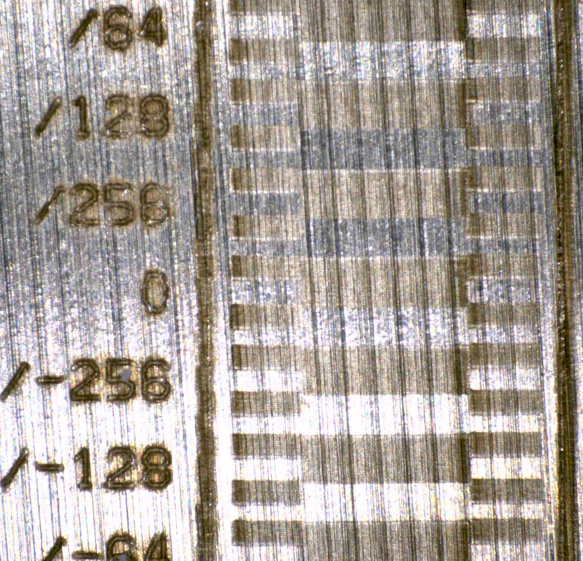

TCON and TCOFF were previously set at -300us and 100us respectively.
Here is test with our original settings:
Here is the test with our updated settings after running the TCON/TCOFF test:

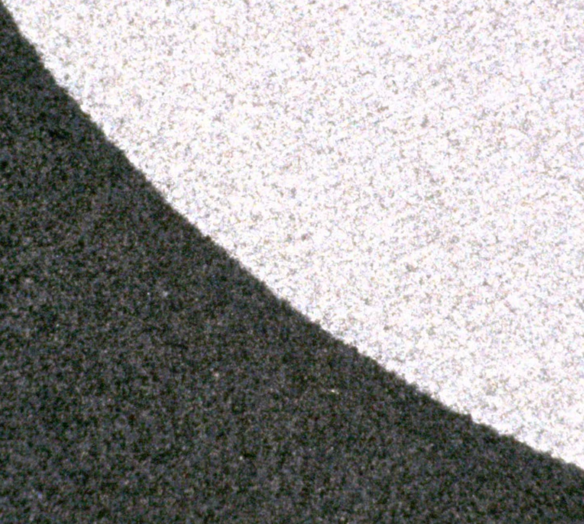

In terms of the result, this appears to have significantly reduced or eliminated the border valley.
Overall this test appears to have significantly improved our edges and eliminated the valley. We will perform more inspections and tests in the coming days.
Our final settings are: TCON: 157us, TCOFF 235us, EndTC 300us (unchanged), Polygon TC 100us (unchanged), Jump Speed 5000 mm/s, Min Jump Delay / Max Jump Delay: 0 us, jump distance limit: 10 mm.
Here is a microscope picture with original settings showing the edge valley:
Here is a equivalent picture with updated settings. We cannot see the edge valley here:

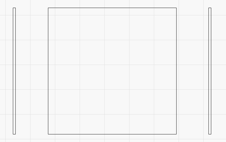

As a simple test, if you disabled bidirectional engraving, overrode all the timings for your layer, and put a small thin rectangle off either side of your engraving test area, you could simulate that overscan - like this:
If you set all the timing corrections to zero, and used uni-directional engraving, the middle rectangle should be a “pure” test area with no start/stop pauses.
I have actually been meaning to try this myself - IE, LightBurn can add overscan moves for diodes, and do the extension based on speed. We could also do the scanning offsets like we do for DSPs to correct for timing differences on left->right vs right → left passes, but that’ll require some playing with to get it right. I think people are so used to TC’s for galvos so for now what we have is sufficient, but I believe there’s room for improvement too.
But that’s what I tried to set up in the tcon_tcoff_test_v04.lbrn2 test.
There’s some narrow bars on the left and right, intended to do exactly that. Turn off bidir, the skinny left and right bars are not read for cal, but to make a pseudo-overscan scenario. They appear as blue on my screen but are actually a blue bar superimposed over a red so they apply to both directions.

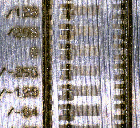

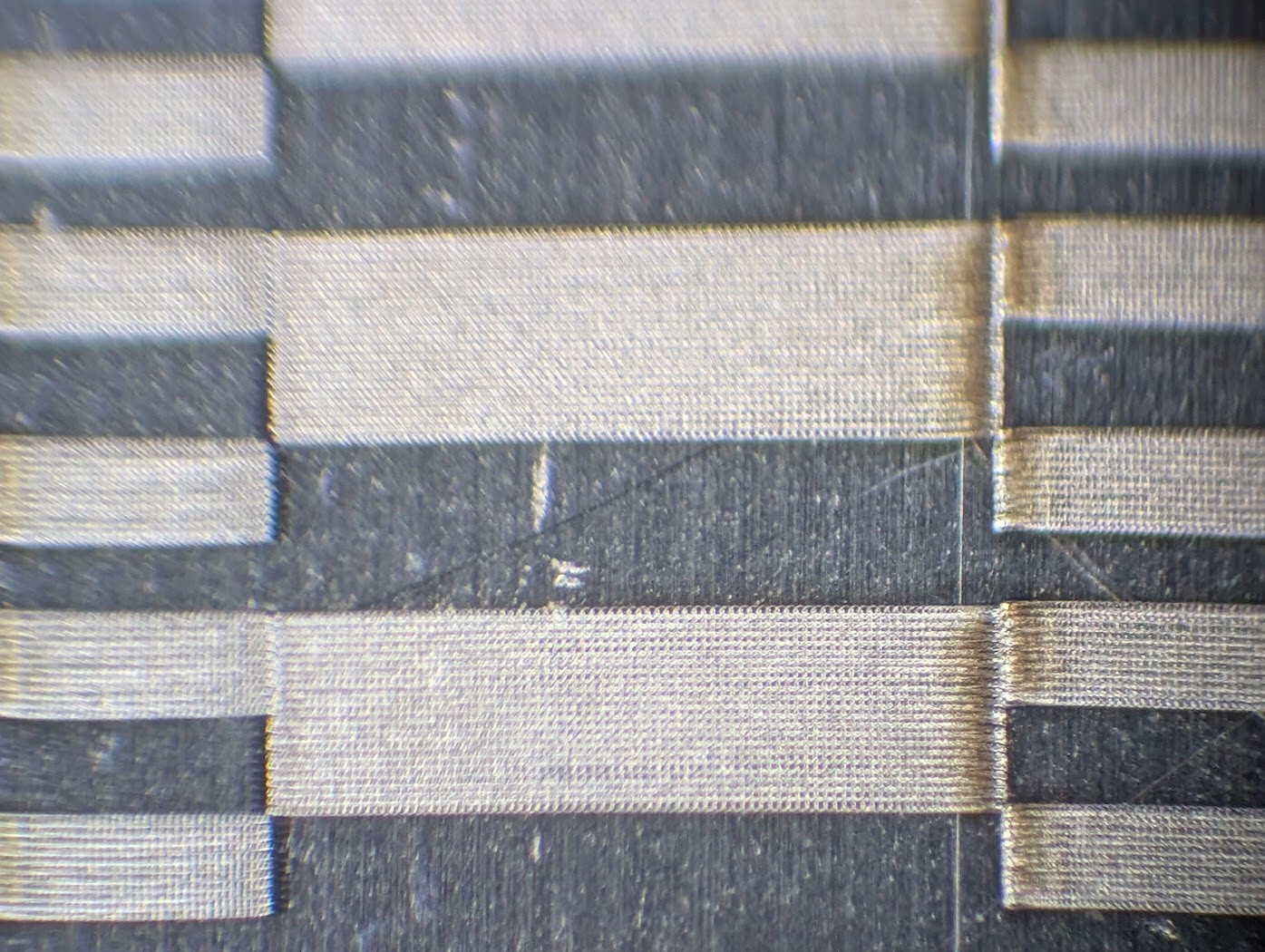

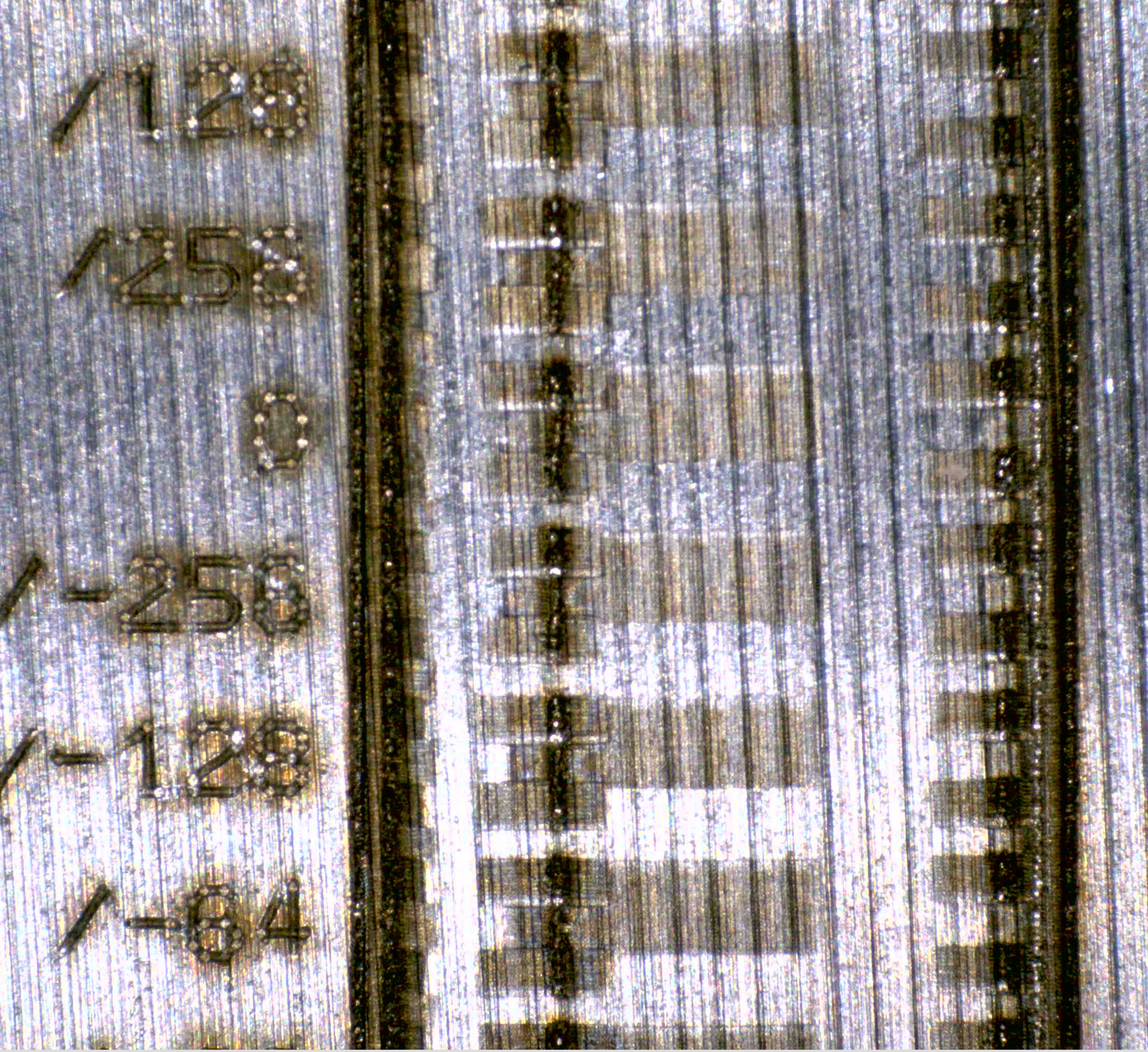

I got what’s shown below. The pulse freq/line interval were set up to space the pulses out at just a bit less than the spot size, minimal overlap. The second photo zooms in and is more telling, one side has pulses bunched up and the edge appears thicker because there are several pulses fired on top of each other as the mirror starts from a standstill. Now… ok, I’m not sure what is happening, that should be the trailing edge, not leading. The thick center bar is left to right, and I don’t think I 180’ed the pic. That should be trailing edge, and I thought there was no prob on trailing because the fire command stops first, immediately ceases the pulsing, but the mirror was just told to keep moving at CV to that point and overshoots, slowing or turning for the next thing it will cut, which shows nothing unless the Toff keeps the beam on too long.
Hmmm… wild theory here. Could the laser actually be scanning the opposite of what LB’s graphic is showing? The burn isn’t mirrored, but it wouldn’t necessarily have to be. If it’s mixed up, that would probably have to be inside LB not the laser. That is, the on-screen arrows and the command to the BJJCZ could be flipped. I’m gonna say this is “simpler” (for the purpose of Occam’s Razor principle of investigations) vs it braking to a stop before shutting off the fire command even though there’s more content on the line to fire for and it shouldn’t do that regardless. So I’d investigate that theory first.
The jog speed was higher than the cut speed, so this seems to show the mirrors have started on a bar on the left or right, did a rapid over the gap, then decided to come to a stop at the start point of a calibration bar instead of maintaining CV across the whole line.
Would anything change if this were two bitmapped images instead of Fill objects?
I do see the border bars are not running as a continuous bar from top to bottom as shown in the LB project. Both left and right bars are created as a narrow vertical bar running the whole height, with a red and blue copy superimposed. The one on the left has offsets that correlate with the blue test bars inside which run right to left. The one on the right has offsets that correlate with the red bars inside, which run left to right.
OK, what does that jagged border bar tell us? Let me think through that… take the bar on the left. Each line is always covered by an identical superimposed unidir of both directions (not bidir, which alternates left and right from line to line). Why is it jagged? Let’s think about the bar on the left, specifically its right edge. It reaches further to the right. It syncs up with the occurrence of the narrow side dashes, not the thick center dash. That’s blue layer, supposed to be moving right to left. There’s ALWAYS more blue content to the right of that bar, so…
“the right edge of the left border bar starts sooner if the prior blue content ended closer to it” (??!)
Am I thinking of it wrong, that it’s the thick red dash content causing it? Doesn’t seem possible, the period of the defect lines up with the narrow blue dash, not the red.
The left border bar’s LEFT edge reaches out further to the left when there’s no blue right-to-left dash on its right. Let’s phrase it as “why is the left edge of the left border bar further to the left specifically when there’s not a blue (right to left) dash nearby to the right? There is always more right-to-left dash to the right in both cases, it’s just further off”.
Now, I can’t entirely say whether this was the left-going pass staying on too long, or it’s a right-going pass starting too soon on the neighboring line above it. Neither of those make any sense to me. And the right edge of the right border bar is VERY dead-on.

It would be trivial to find out whether your theory about the reversed directions is true - Increase the line interval to something like 1mm (just to make it take less time), drop the power to 0.5% (so you don’t burn the heck out of everything) and cut the speed to 50mm/sec. At that speed you should be able to see visually which direction it’s doing the rasters in.
One thing that might be causing issues here is that in LightBurn we use jump speed when moving between scanned shapes, and cut speed when actually engraving. It’s possible that the decel before you hit the shape edge is causing bounce.
From the file you posted, you haven’t overridden the timings. If you click the ‘Show Timings’ button you can set all the delays here to zero, and they don’t affect your global defaults:
Click the ‘Override Default Timings’ button and zero everything:
If removing the delays doesn’t change anything, you could set the jump speed to match the cut speed there, and that would rule out the decel as a possible cause.
