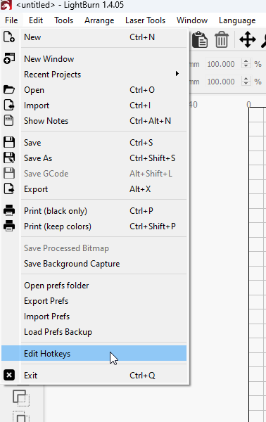

I use a French programmable keyboard and I want to define a shortcut for “Edit Nodes”. Documentation defines Ctrl + ’ . On my keyboard it does’nt work.
Could you give me the right corresponding character and/or the ASCII code used for the last character. Is it possible to redefine the shortcuts?
Thank you
Regards
Edit: Finally I have found for an Azerty Keyboard: Ctrl + 7 (alpha)
