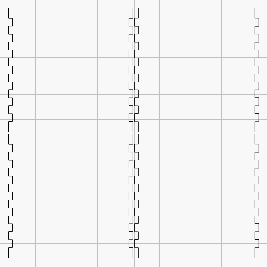

Here is a box generated by the boxes.py site. What I am trying to do is get rid of the tabs on all four panel bottoms so they are all flat. I couldn’t figure out how to do it at that site and hope there is a way to do it in Lightburn. Thank you
I think what you want is the “e Straight Edge” option for the bottom_edge parameter:
https://festi.info/boxes.py/ABox?FingerJoint_angle=90.0&FingerJoint_style=rectangular&FingerJoint_surroundingspaces=2.0&FingerJoint_bottom_lip=0.0&FingerJoint_edge_width=1.0&FingerJoint_extra_length=0.0&FingerJoint_finger=2.0&FingerJoint_play=0.0&FingerJoint_space=2.0&FingerJoint_width=1.0&Lid_handle=none&Lid_style=none&Lid_handle_height=8.0&Lid_height=4.0&Lid_play=0.1&x=100.0&y=100.0&h=100.0&outside=0&outside=1&bottom_edge=e&thickness=3.2&format=lbrn2&tabs=0.0&qr_code=0&debug=0&labels=0&reference=0&inner_corners=corner&burn=0.04&language=en&render=0
Which spits out this LightBurn Abox.lbrn2 file:
That’s the simplest box, but the same parameter should appear elsewhere with the same meaning.
That sounds like just the thing I’m looking for Ed, I’ll see if I can find it and generate a new box. Thanks!
Alternately, if you only want to remove a few of the tabs, you can just use the node editor and delete them, which will create a straight line between the remaining tabs. I do this all the time to create a finger or coin slot for prying open the tightly fitted lids.
Here for example (as compared to the back of the box - the Wolf side):
I’d go for Eds suggestion as well, that’s the engineer’s approach.
In case you don’t have the chance to edit the box, the last resort would be to use node edit mode and delete all nodes that are between the bottom edges. Then automatically all tabs are removed and you get a straight line.
I would use node edit, just for practice. This is the most powerful tool in Lightburn cad and is well worth the time to learn how to use.

Ed, I could not find that e straight line editor in the box maker I was using. And to the node editor that you and some others mentioned, I found it in the tools on the left but will need to investigate how to use it it, couldn’t get it to do anything but Dskall says it’s worthwhile to learn how to use so sometime I’ll have to pursue it. For now though I think I’ll try to find a different file. Thank you all for the help.
