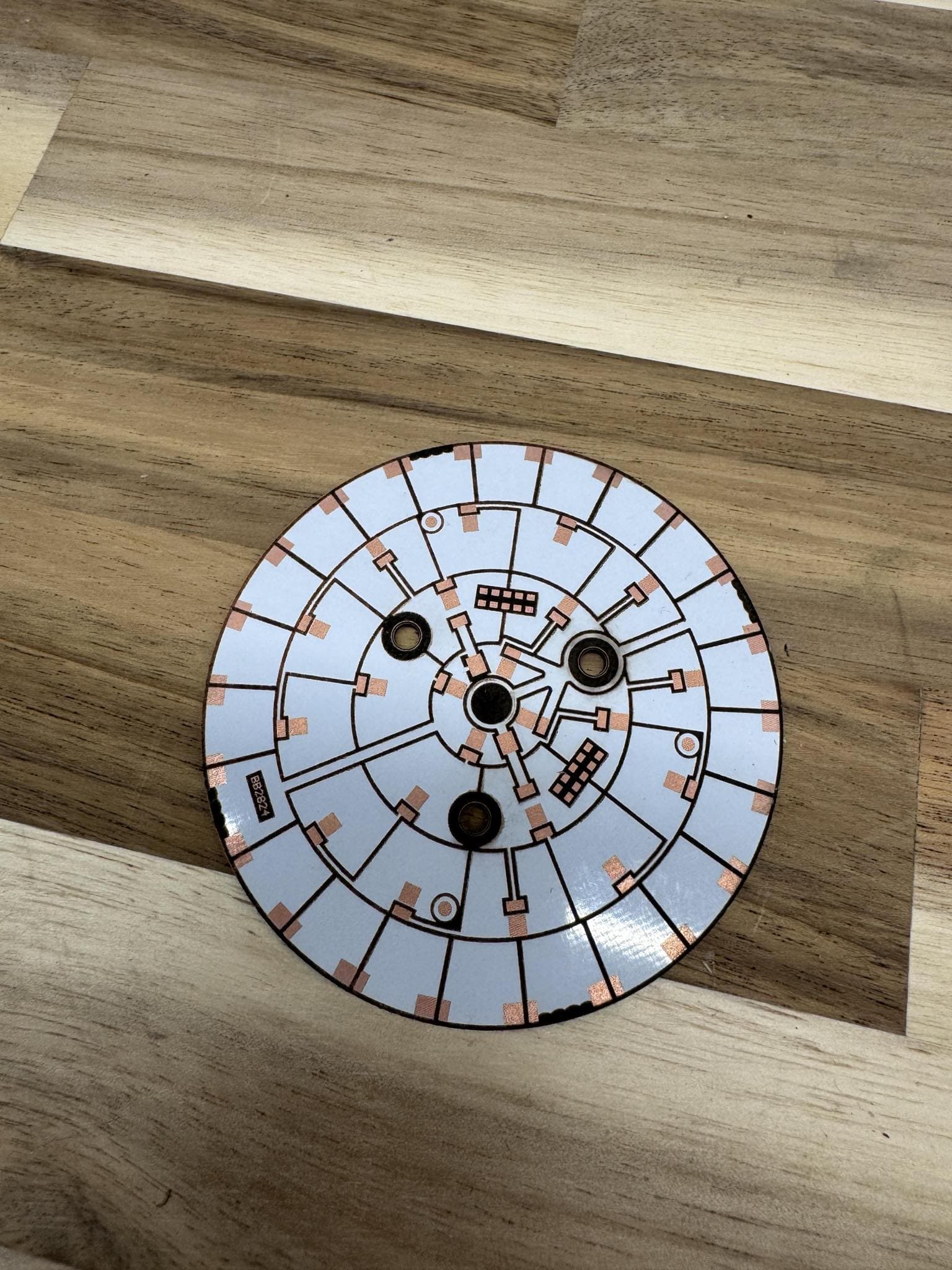

Just got a guy local to me to do some testing. He was able to no problem use a 30W M7 JPT MOPA (175mmx175mm) to do a board for me. He figured out the settings and had it dialed in in like 2 hrs. The FR4 is a little charred but I am not too concerned about that, I can do some cleaning steps after if needed.
They recommend the uncommon “FR1” type (bakelite) core. I have only found it in single-sided. It doesn’t char nearly as easily as FR4.
Actually, I found I COULD do a slow, weak “clean up pass” that will actually burn off the char without cutting further and making new char. With either FR1 or FR4.

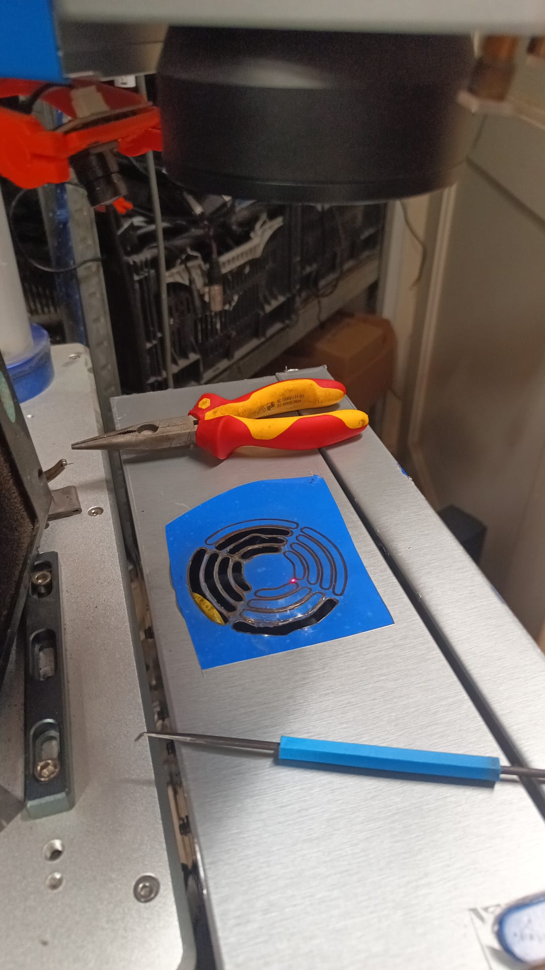

i needed some holes in a steel cabinet (around 1mm) and tought to use the laser for it.
but someone glued vinyl sheet over it and i forgot to turn on my fume extraction,it was a very short cut but i felt that for hours afterwards.
removing the foil made it a little safer
use hepa and activated carbon filter sheets glued to a 120mm fan sitting right next to it, cant get any cheaper than this. or just blow it outside

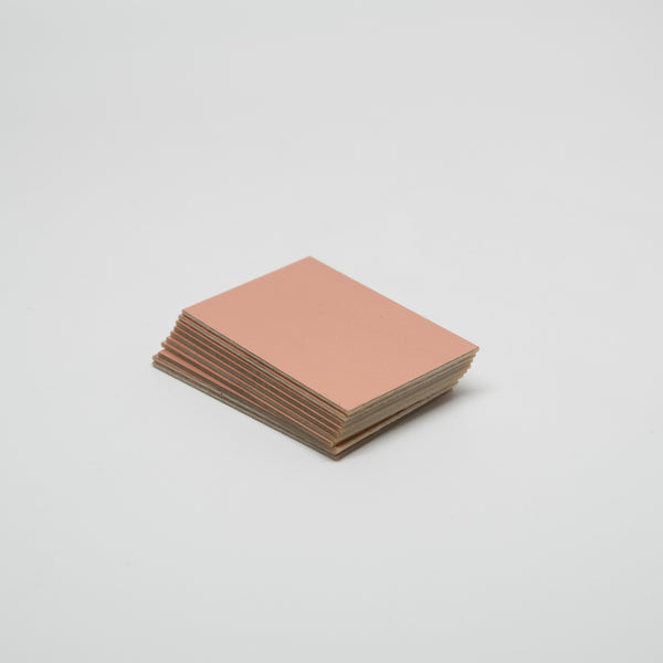

FR-4 is epoxy and glass fiber, epoxy is plastic.
but phenolic isnt better, its just missing the glass fiber part to make cutters live longer. burning it isnt good either
you can get FR-1 Boards (single and double sided) on sites like carbide3d

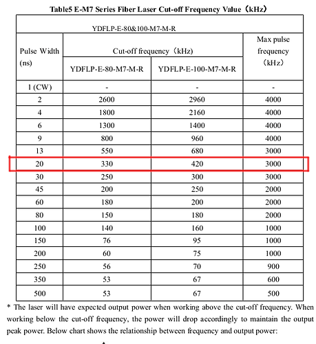

I seem to be missing something here… This is for an 80W and 100W machine.
I would expect as the q-pulse was shorter, there would be less time to pump up the fiber. This seems to indicate the opposite? I also notice the max pulse frequency is also changing, giving it more time to pump up between pulses.
I’m assuming you shouldn’t use a 4000kHz frequency if the q-pulse is shorter than 9nS if I want full available power.
Taking that into account, it still appears the threshold frequency should be going the other direction?
Can you clarify what they are saying?
