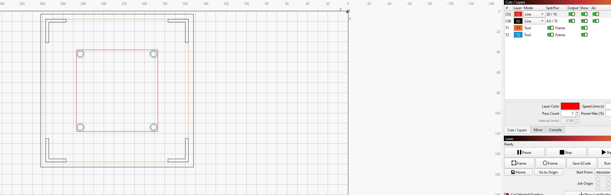

The issue is: My design has 6mm holes for Lego studs to fit into. When I cut the design, the studs do not fit, the hole is too small. HOWEVER, if I then use the ellipse tool to draw a 6mm hole on the exact same panel, moving nothing, not adjusting anything on the laser or in Lightburn, and then cut that hole? Booom, Lego fits right in snug.
I have checked the design a dozen times. The holes say 6mm. They are not when they cut. But add test holes and those are magically 6mm.
Could transferring from my inside PC to the garage PC do something to the file to make the hole the incorrect size? I have tried deleting them and re-adding, but they always cut small. And yet adding a 6mm hole on the same file gets me a 6mm hole.
What hapens if you remove the kerf offset on the original file? Does the hole get bigger or smaller?Sometimes the kerf offset does just the opposite of what you expect it to, depending on the design. Without seeing your design I cannot offer any other advice.

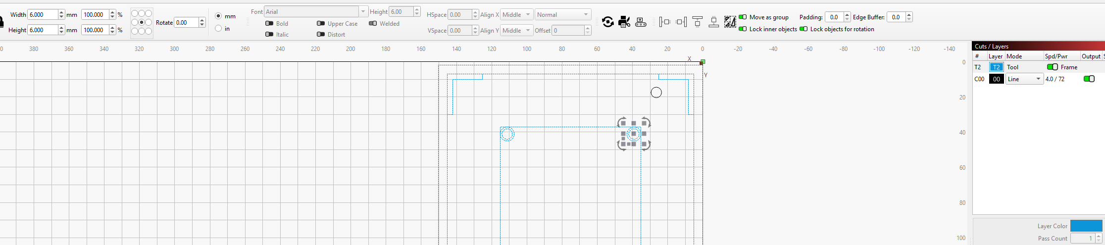

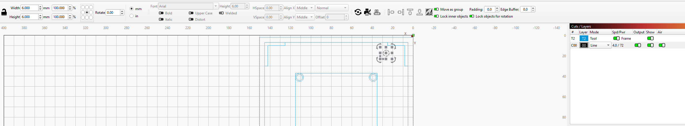

(The second screen I made everything a tool layer so it wouldn’t try to re-cut while I tested the hole. )
After seeing your design, I can almost say with certainty the kerf offset is doing the opposite of what you want. Place the holes on a separate layer by themselves and the ker f offset should behave as expected.

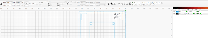

This is what they typically look like, I just separate engraved lines from cut lines from tool lines.
This is what it looked like before I just made it all tool lines.
When you have a kerf offset applied, if the part you want offset is inside another part, the offset will move inward rather than outward. The same as how fill layers invert every time one is placed inside another. Since you probably don’t need an offset applied to everything, just place the holes on a layer with the offset.
That was it, sir, worked a charm. Thank you so much!
