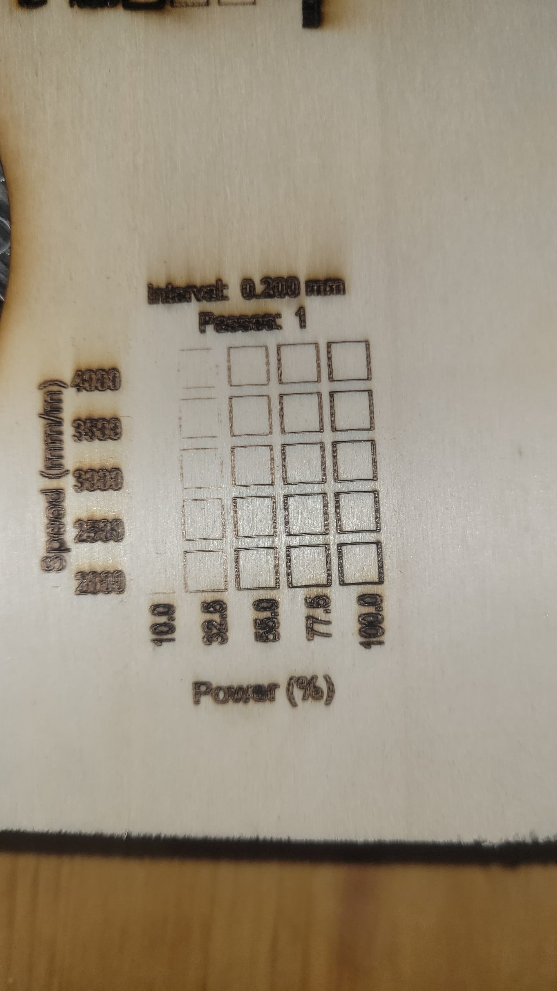

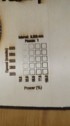

Elongated laser dot
Can anyone tell me if this is normal? I know the beam is not a sqaure but it seems to me to be too much
Atomstack a24 pro. It is supposed to be .06 x.08
Is there anyone out there who is willing to replicate the test?
Thank you in advance
It’s hard to tell from that picture, maybe reduce power and show it again. 0.06x0.08 is only advertisement, no laser head above 5W will really reach this. If it’s a 20W laser head, expect it to be something like 0.12x0.15 or sow.
Check out @Bulldog engravings … does great work with his $1k laser module. It’s 5W, not above.
