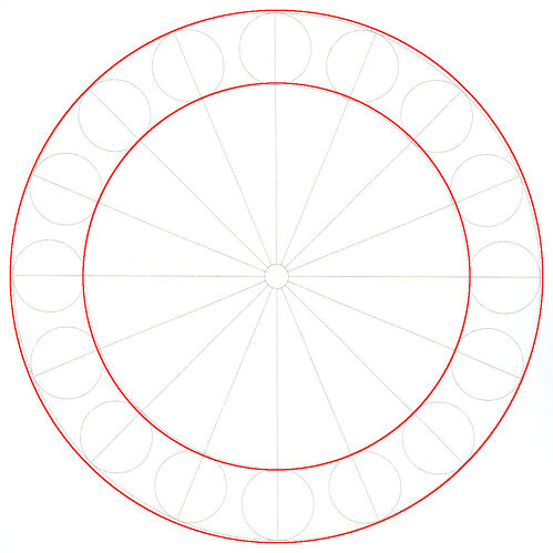

When cutting a simple circle, there is always slight aberration - it turns ovoid - in 2 quadrants. Always the same 2 quadrant - SE and NW.
On a 200mm diameter circle, it’s a -1mm aberration, producing a 199 mm diameter at 135° and 315°. But there is no contrary aberration where it would produce 201mm diameters at 90° rotated from the aberration. What!
As a picture is worth a thousand words, here’s a demonstration of what is happening.
This means that the very thing I use a laser for - precision - eludes me and “complex” builds involving anything circular are impossible.
The problem occurs at any speed, and only when both X and Y motors have to move together. In rectangles, precision is always top notch both on the X and the Y axis.

This test pattern is useful to identify mechanical problems:
GrundTest.lbrn2
Scale it uniformly to fit the platform and run it as fast as it will go in Line mode with optimizations turned off and power set to mark a sheet of cardboard. Any differences from the design will be informative; a photo will let us look over your shoulder.

Hi @MikeyH sorry for overlooking your question earlier. By quadrant I mean quadrants of the test circle. The position on the table didn’t seem to make a difference.
@ednisley I’ve run the file provided at 1700/10%. The file has a notice saying to turn Cut Path Optimization off, which I’ve done. Here are the results:
  1. file as provided on A3 cardboard
  2. circle compound shape from the file resized to 200mm diametre and then run again on A3 cardboard, as aberrations often grow more discernible with size.

It looks good enough to rule out many mechanical problems, which was the point. Good!
The red circles show the problem:
Assuming this is the machine:
Then IMO the frame is very very slightly squished along a diagonal: the rear-right and front-left corners are a millimeter or two closer than the other two corners.
With an accurate metal tape measure, measure between the near sides of the recessed corner screws to get an idea of the frame squareness. The two diagonals should be spot on; if they’re not, that’s the problem.
