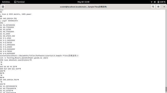

So , I just got my first laser cut but I found the next issue, which is a basic one but affect the funcionality and I am trying to see if some else Got the same issue.
When I save the file in LightBurn the printer just keep in circules doing nothing, What I did , I just opened the file again in LaserGRBL and saved as and the printer started working, So I just compared both files, the only different at the begining looks the comments but also at the EOL character
LightBurn :
G1 X1.25F3000S0
LaserGRBL:
G1 X1.25F3000S0^M
That EOL make a lot of difference , Laser is creality falcon 10W

yes, I loaded the file that comes with the printer in linux, but keeps doing the same.It worked with the original file that comes in the usb , but after making changes stopped working. In fact I have another issues since the /dev/ttyACM0 port does not open by default I had to assign it rw rights , but even with that I can not connect with the printer, I am using the usb directly.

just did File->Save Gcode and that was all.
You only save the GCode text if you need to copy it to another media and load it into the laser. None of your settings or image information is saved in this format. It is purely for running the laser.
You should use File->Save As to save all your drawing work. When you later load it in, the settings, layers, and tool paths will be the same as you left it.
