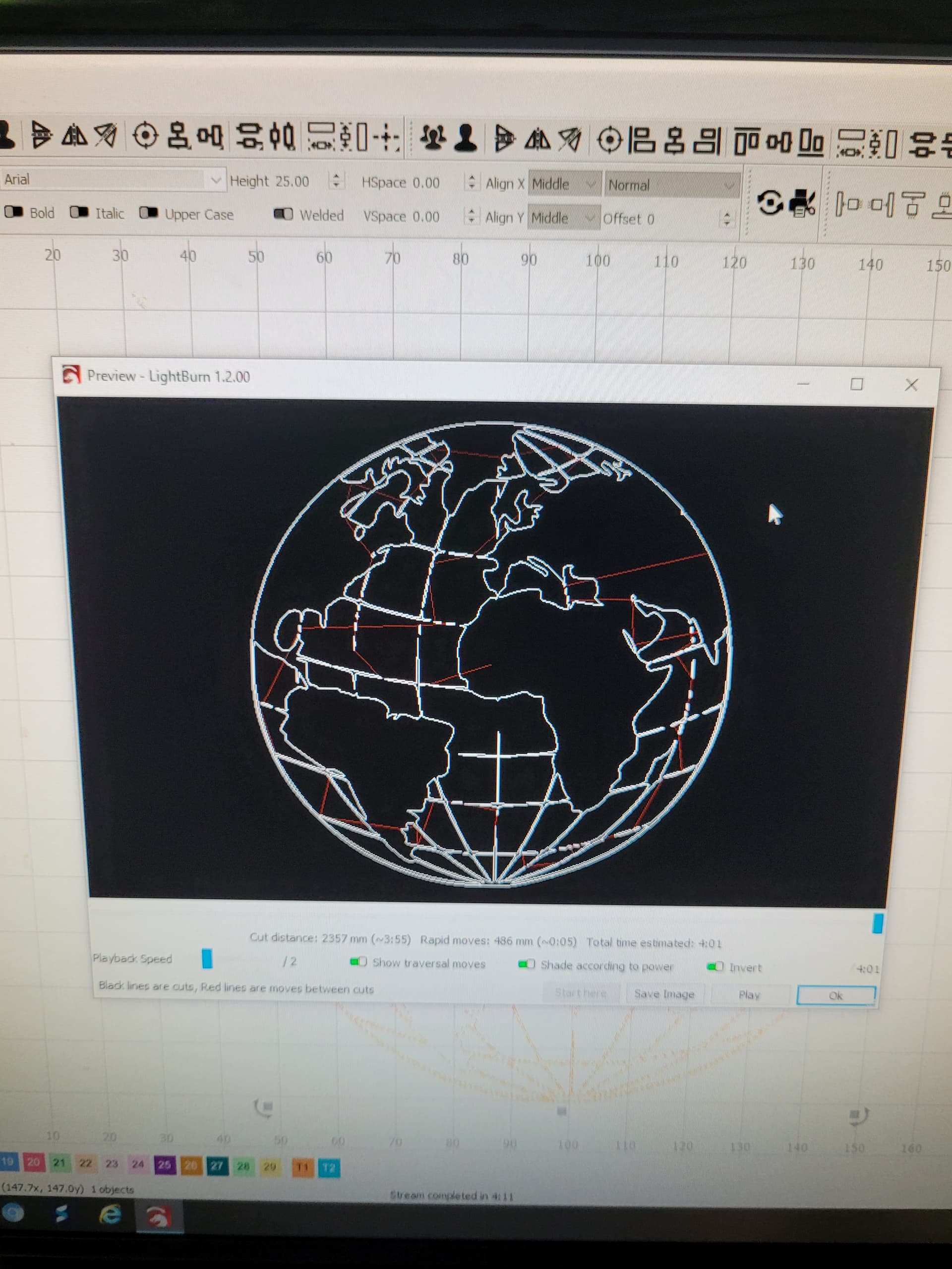

Hello…running lightburn with my ender 3v2 using a 5 watt output diod laser. Took some doing getting it to connect. Once i got it working and i could manually move the head and bed. I started running it…about 5 seconds into engraving, the laser stopes moving and just keeps giving power and burning through my wood. It gets a gcode error. I dont know the error. But what would be a solution to that? Pleaee help

When i do a preview of my photo it looks good. And it doest start proper, but then the Y axis only moves 1 direction after a bit and the x axis does the same, till it hits the end. Here is a simple drawing of what i mean. Im not home, so i cant take a picture. Tonight i can tho. And yes, my unknowen command issue is no more. Thanks for that.
I can burn, and i can change settings. When i do a outline, or a quick photo sketch it will work. I do believe it is a setting issue.
Is there a rhyme or reason to designs that burn correctly vs designs that don’t?
Once you’re able, screenshots of the designs that work vs not would be helpful.

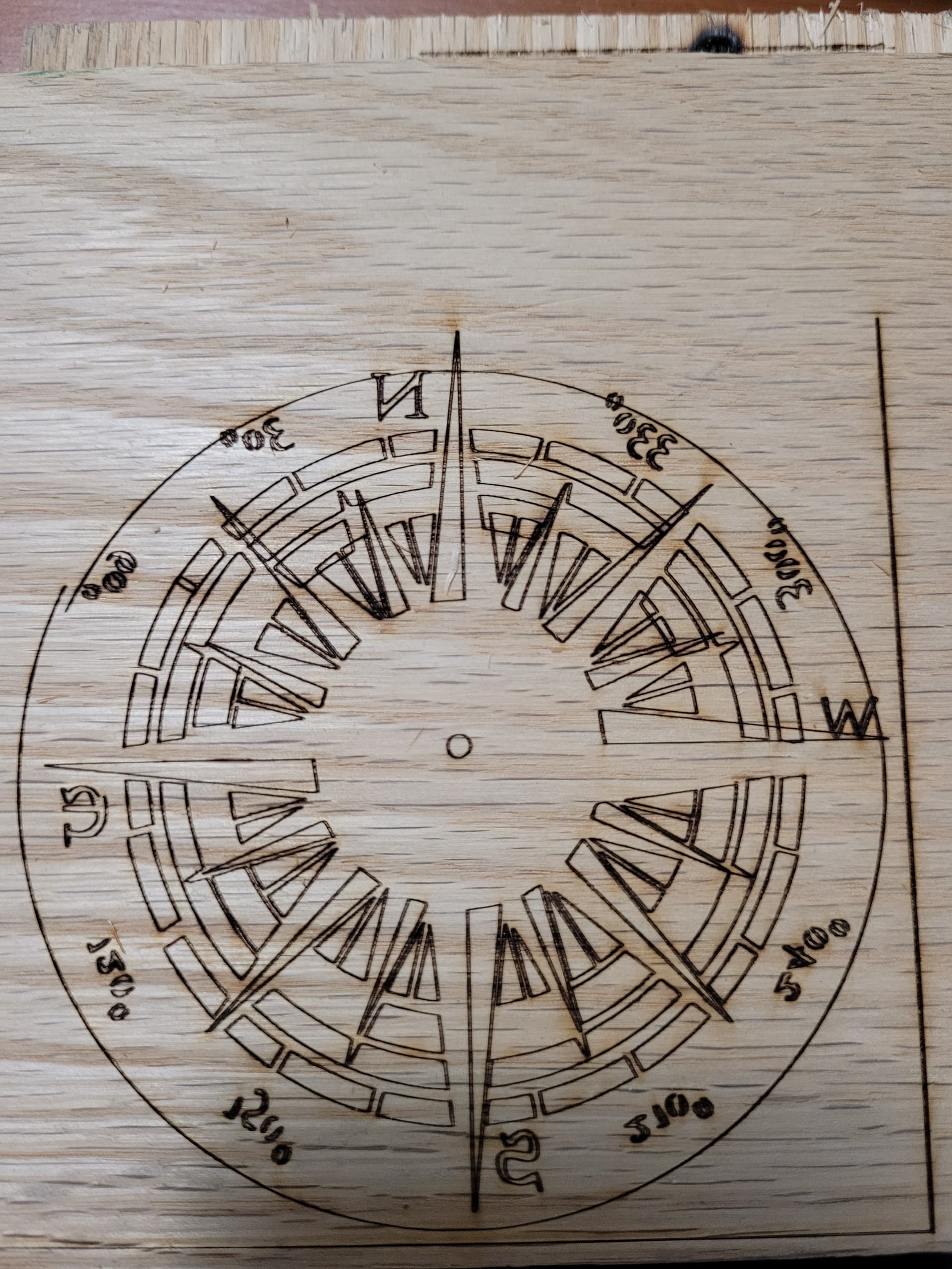

This happens, so it really doesnt work either. No matter the size, or shape, its off center in some way.
I’m confused. How are the two designs different?
But just from the burn sample it looks like you have a losing steps issue.
Either something mechanical or you’re driving the steppers too fast. If you dramatically reduce speed does this change anything? It could also be that you are overrunning your buffer. Did you try reducing baud rate or setting transfer mode to synchronous?
I suggest you test at slower speeds. Do you hear a buzzing sound from the steppers at higher speed? Slowing down should reduce missing steps in both the scenarios of going to fast or if you have a mechanical issue.
Do a full mechanical review. Check if you have any loose belts. Anything that would allow steppers to turn without the correlated movement.
Check all pulleys that they are properly secured to the stepper shaft. The fact that the start and end points of the outer circle indicate a backlash issue. This is often caused by loose pulleys although I don’t see other tell-tale signs of loose pulleys. Make sure the grub screws are properly secured.
If a mechanical review exposes no problems then most likely a situation where the steppers can’t support the requisite speed in the design.
