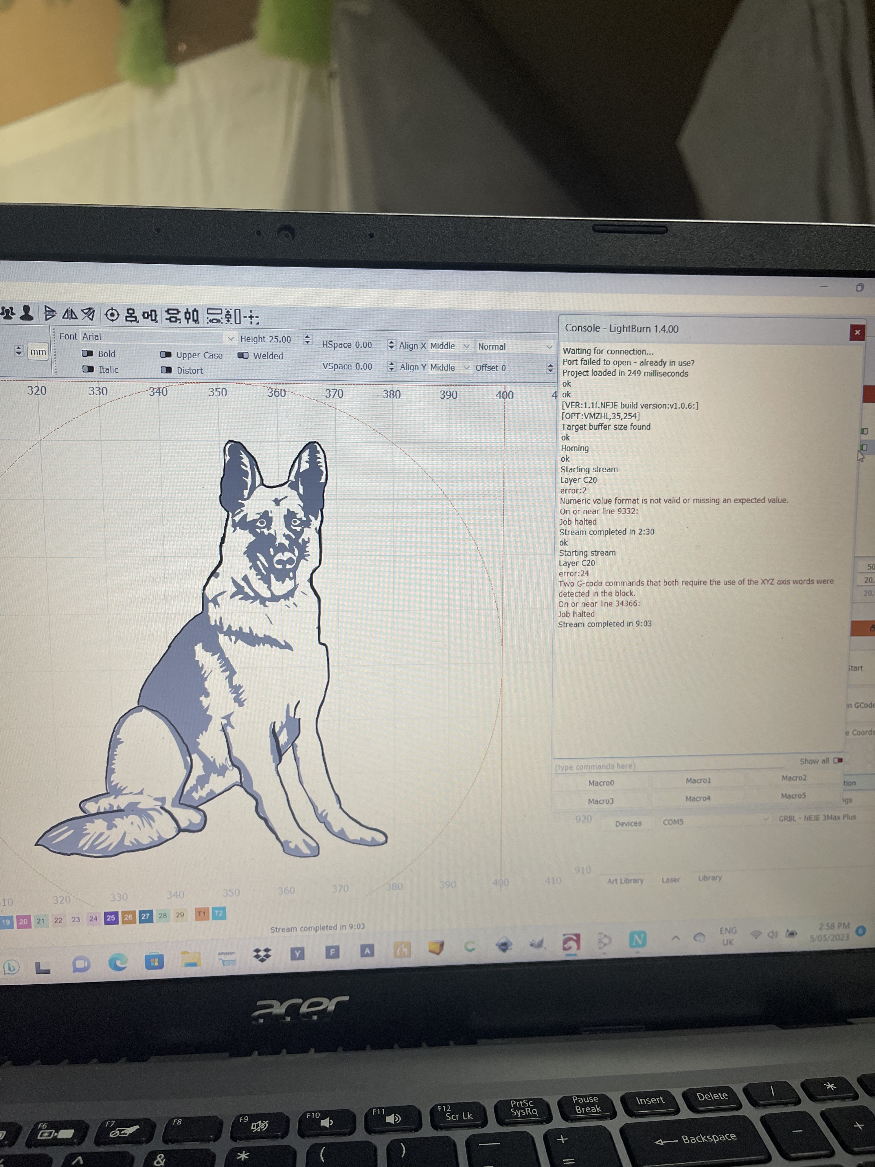

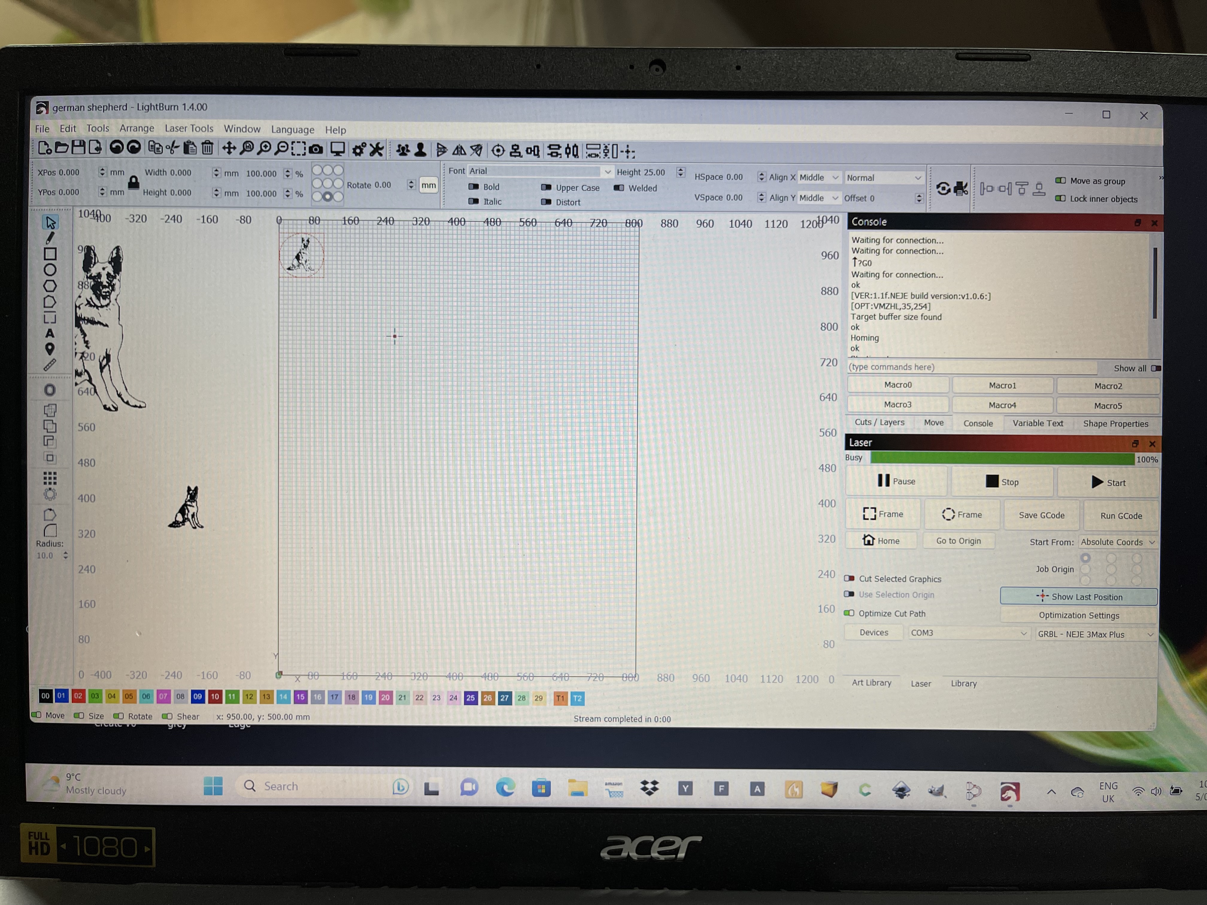

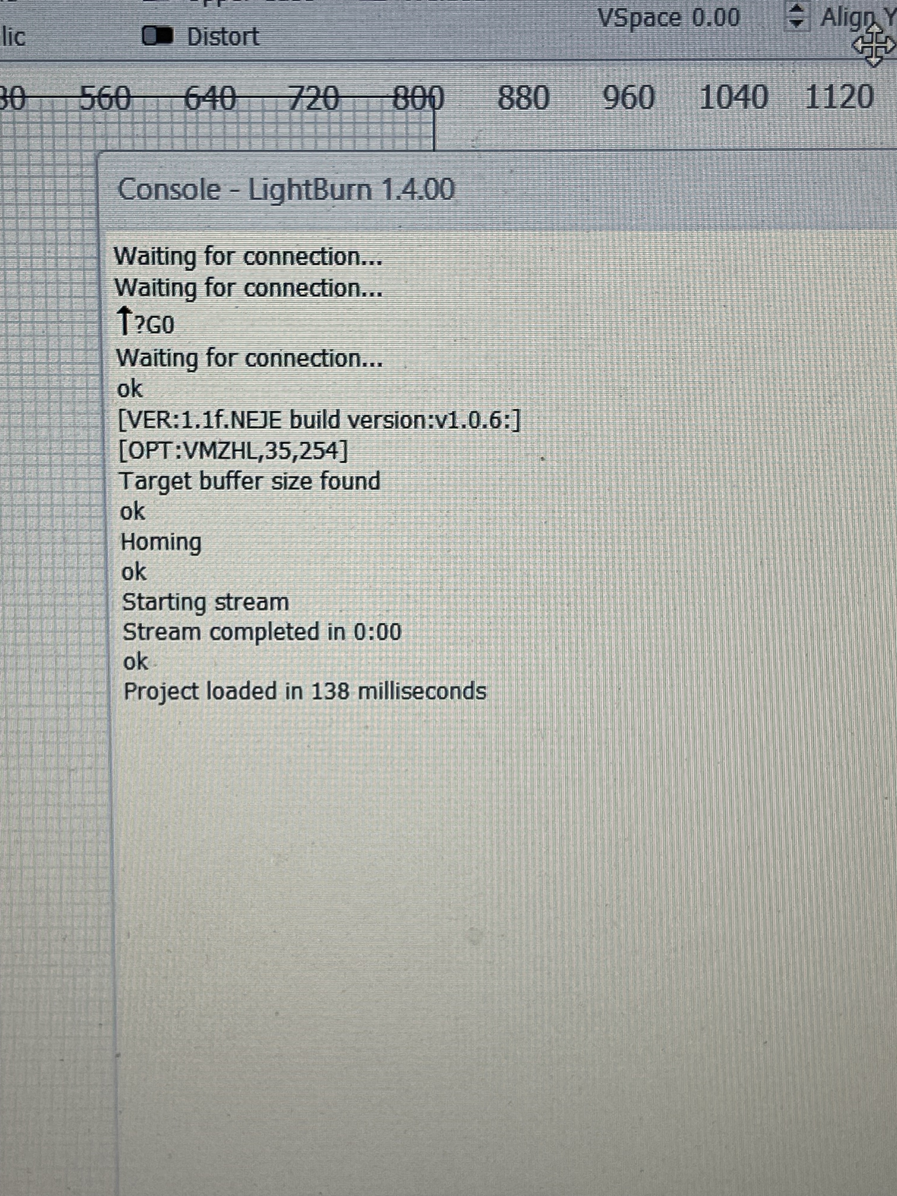

Previously i have run hundreds of jobs possibly 1500 or more with few issues till just this last period where i have had jobs stop part way thru and seeming stepper issues where images are failing to line up in x or y directions. I have tried changing scan angles.

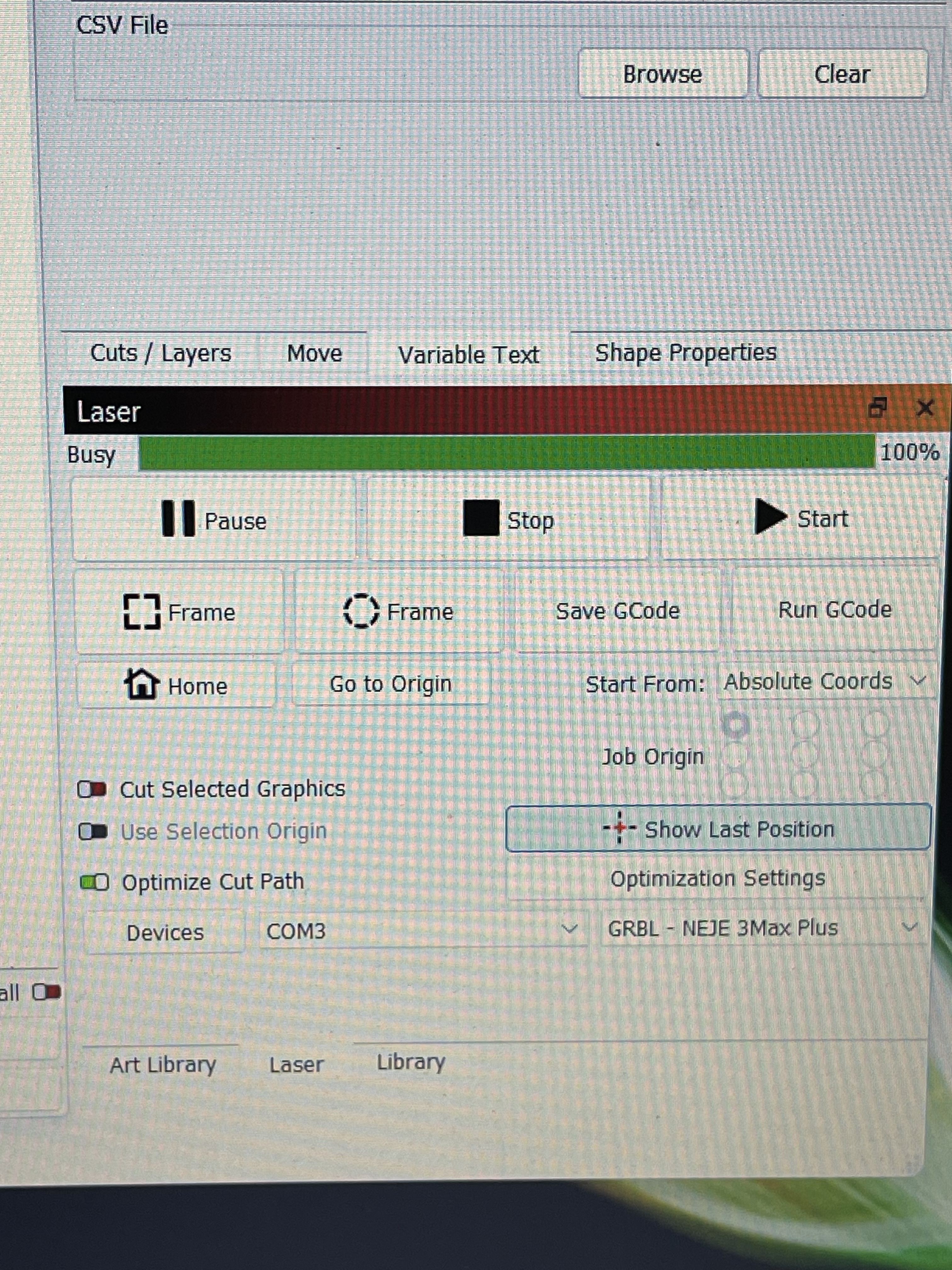

Most common is this issue of showing busy. It frequently happens after homing, after running a job of after using the laser position button and sending the laser to a point on the bed
The pictures show laser busy and the console read out

Also, since the busy error seems to happen for you more when repositioning, when you check the console, you may need to scroll up a little and make sure the busy state is not caused by some other alarm such as “target exceeds machine travel”, “homing fail”, or a shock/tilt sensor alarm.

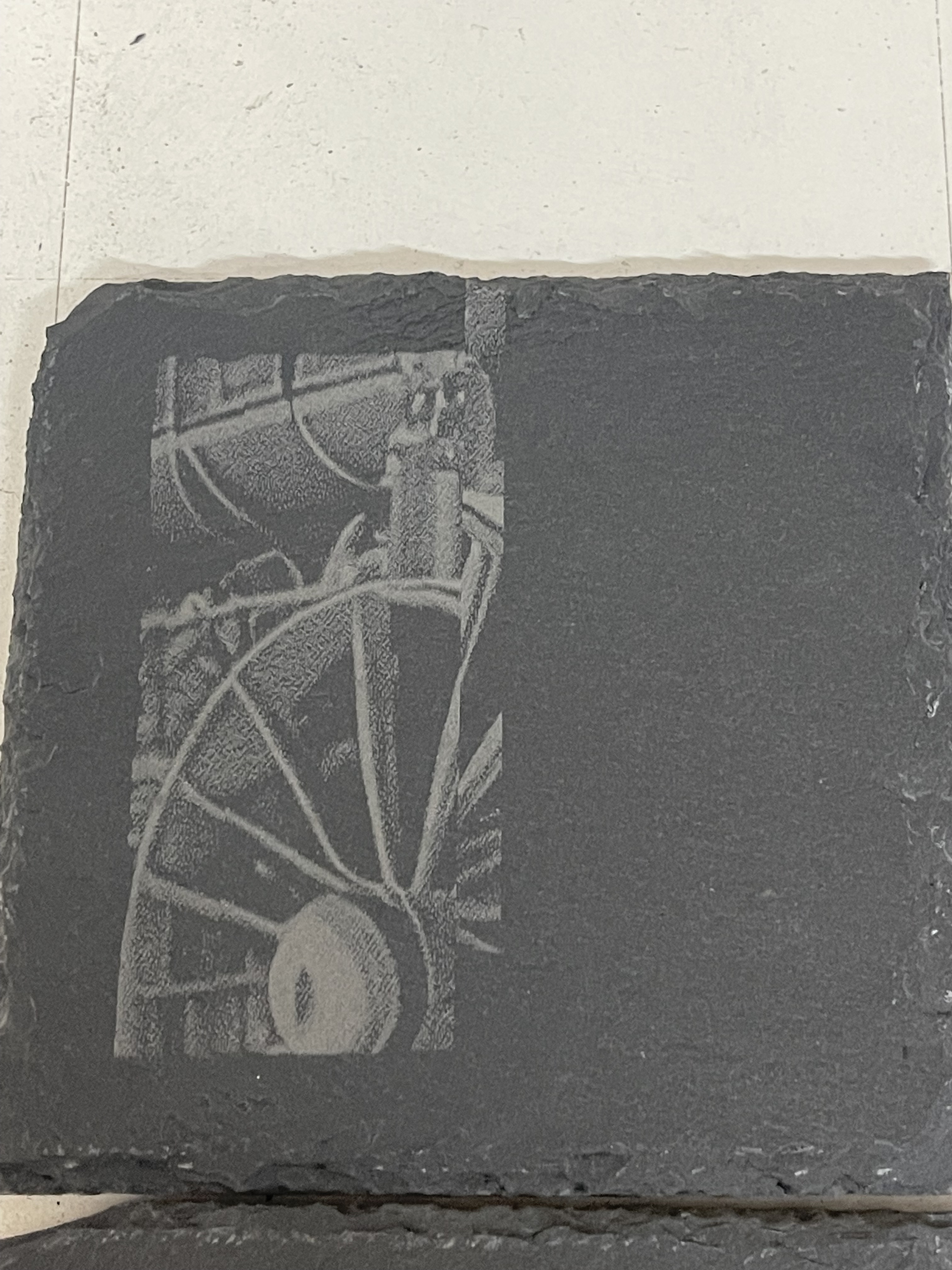

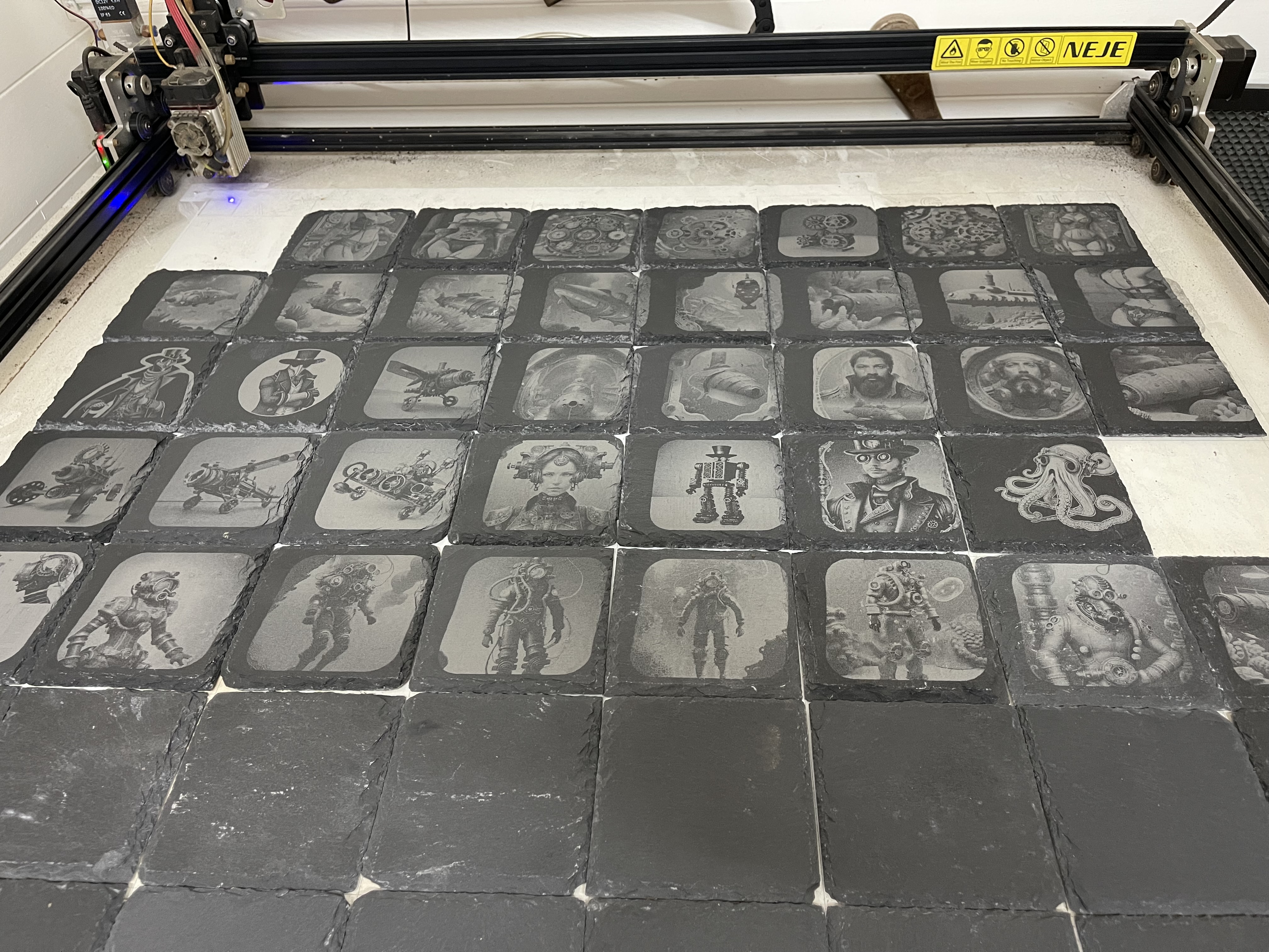

I’m not sure how to quote you from a mobile device but yes some pictures of the work that failed to line up
This one happed when scanning -90°
This one I can’t recall the scan angle but I think it was ° and starting the entire group from closest the bottom of the picture.

Next I loaded a file and at some point I’m showing busy
This is the file
And this is the entire log for the session

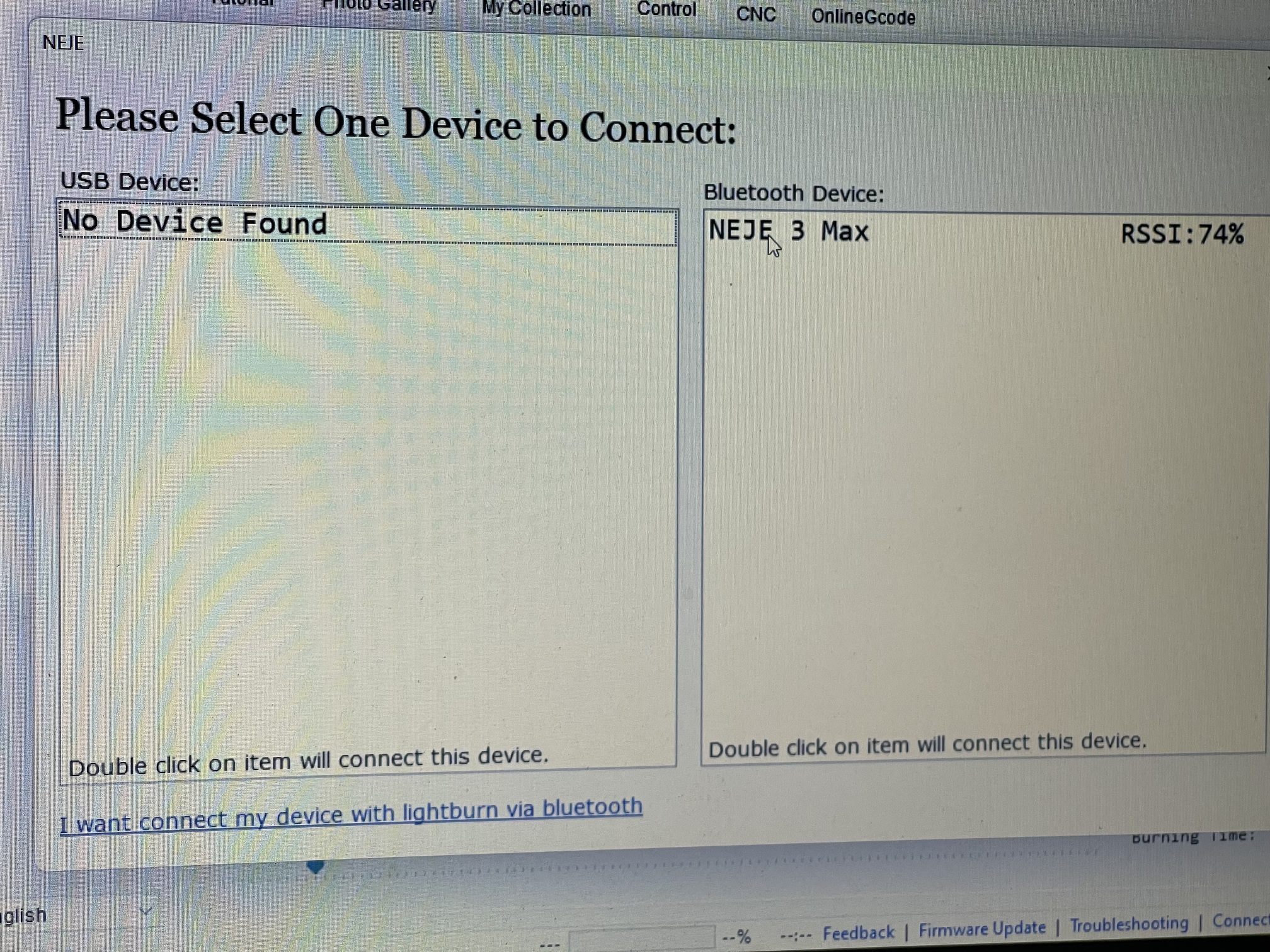

I have also tried setting up a virtual Bluetooth port to step away from any physical connection but have had no joy doing this
Update then a fail … next reply
I have managed a virtual connection thru Bluetooth.

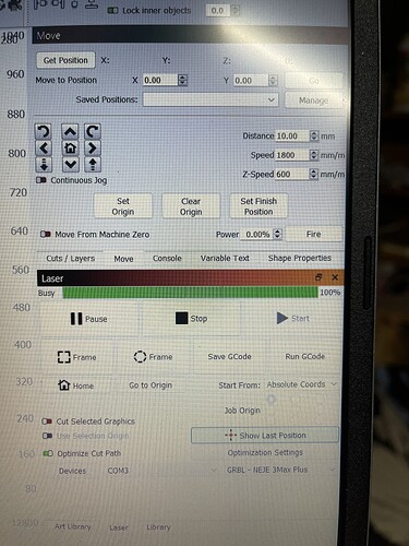

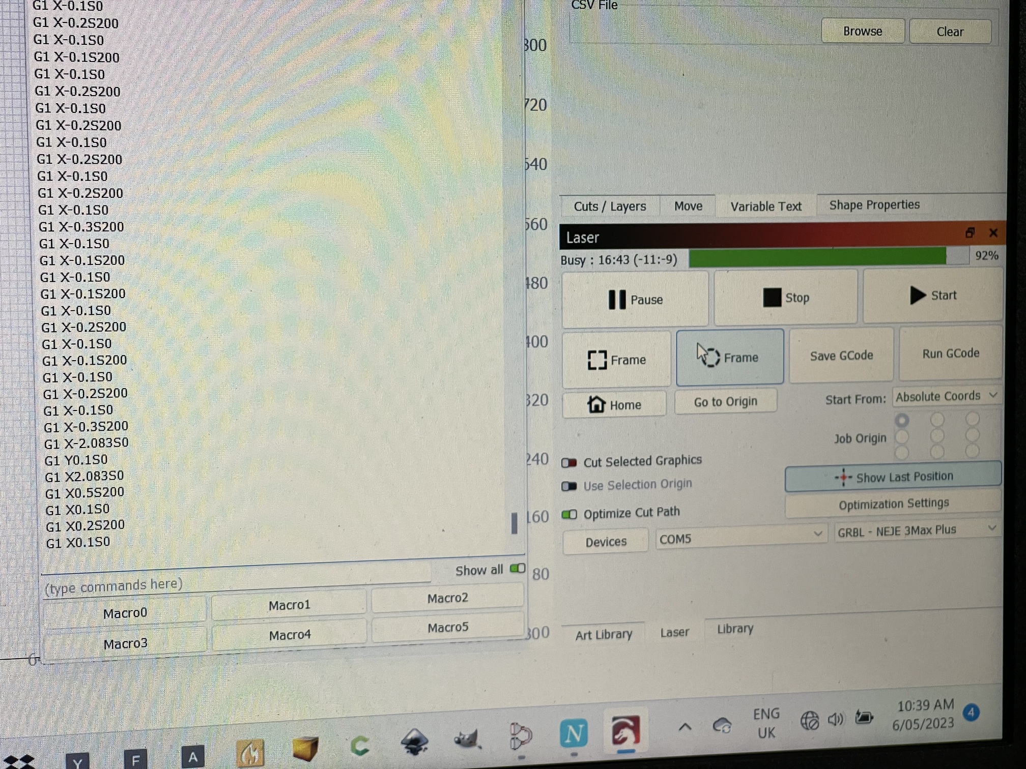

Still stopping mid job as seen by the console pic
This is what I was trying to do. On cork

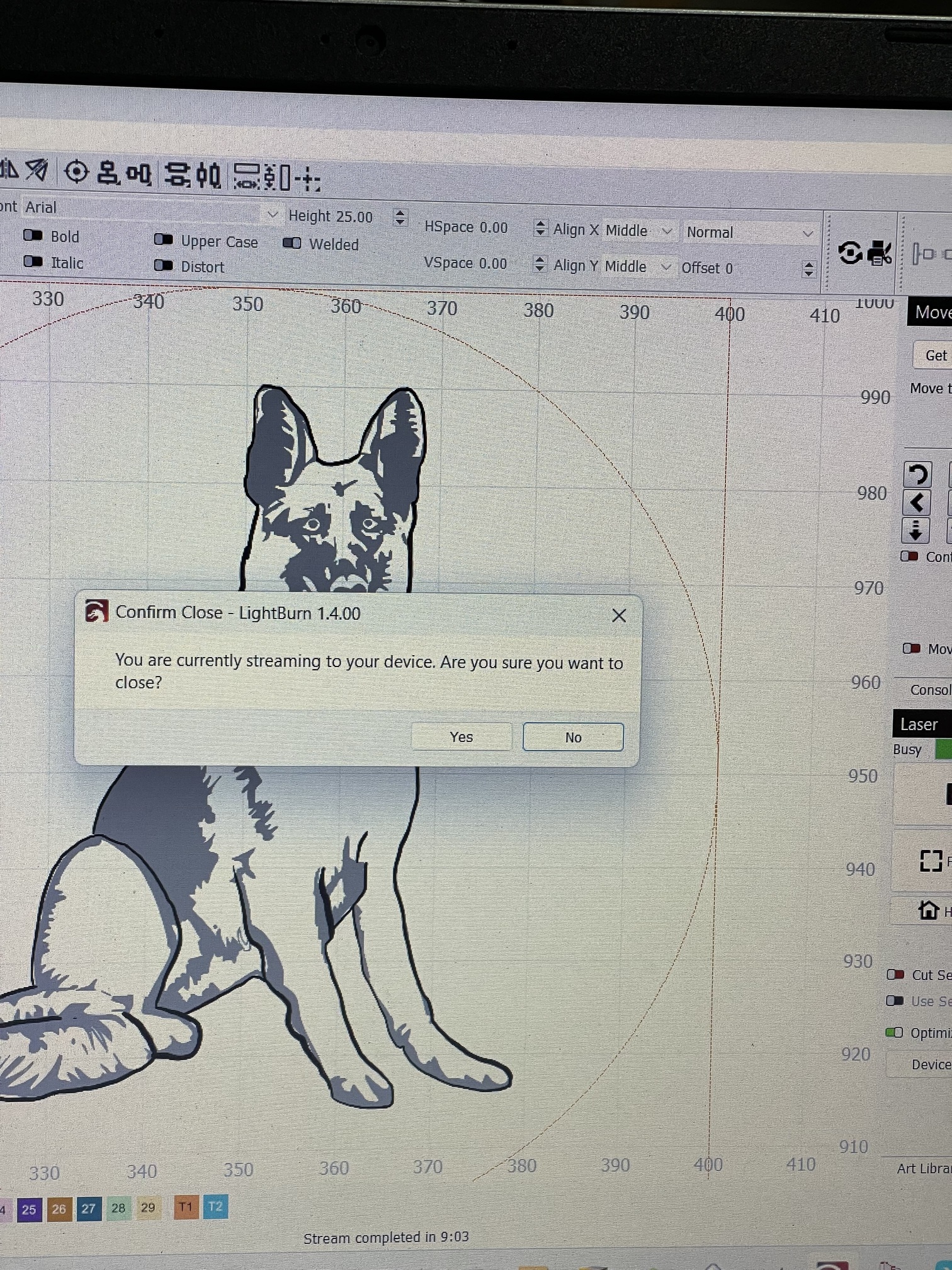

Even thought the job had stopped the laser window was reading’ready’ until I homed the machine then this
So then tried to exit lightburn and this

I like that steam punk/Nautilus style art, but that’s a very ambitious job going on there with so many tiles! It is a risky business to stack the chips so high, due to the potential of the laser to lose position and then continue to be out with the rest of the job.
The image output seems to be slightly horizontally skewed so the first thing to check is is to make sure the machine frame is nice and square and not also skewed to the right at the back.

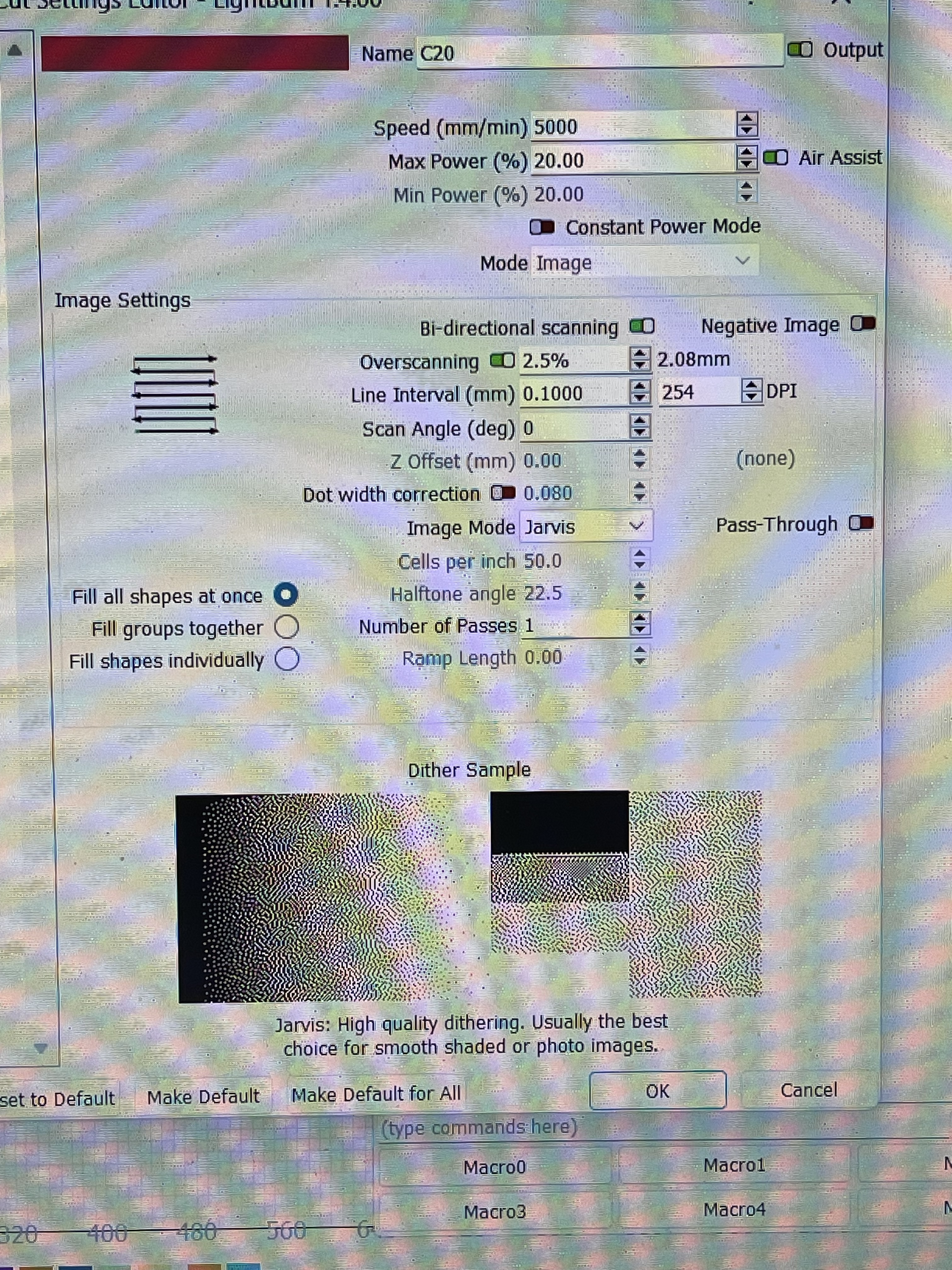

Rapid movement for engraving is designed to be done primarily with the x-axis on these machines - just rotate the image if you need the ‘grain’ of the laser burn to change. It doesn’t look like the big job was done at 90degs though? I would say the safest approach for this job would be to use ‘fill shapes individually’, (cut settings) with no more than 12 tiles in one batch. I would probably mark out where individual tiles should sit with some margin between.
It is possibly to make the job a bit safer to run by slowing down your engraving speeds, what were your cut settings for these jobs?
Your acceleration settings ($120/$121) look very conservative $120 could probably double to 500. You could reduce Max speed $110 and $111 (or at least $111 y-axis) to 10,000 as sometimes skipped steps happen for the fast G0 moves.
The console errors in your last post could be due to noise in the signal line, turn on ‘show all’ in the console window and you may see some weird characters which would confirm that.

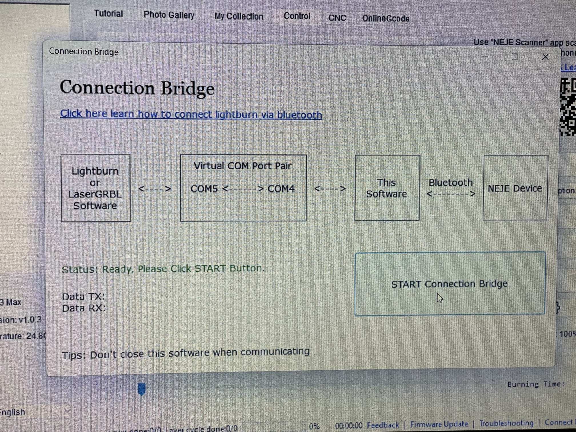

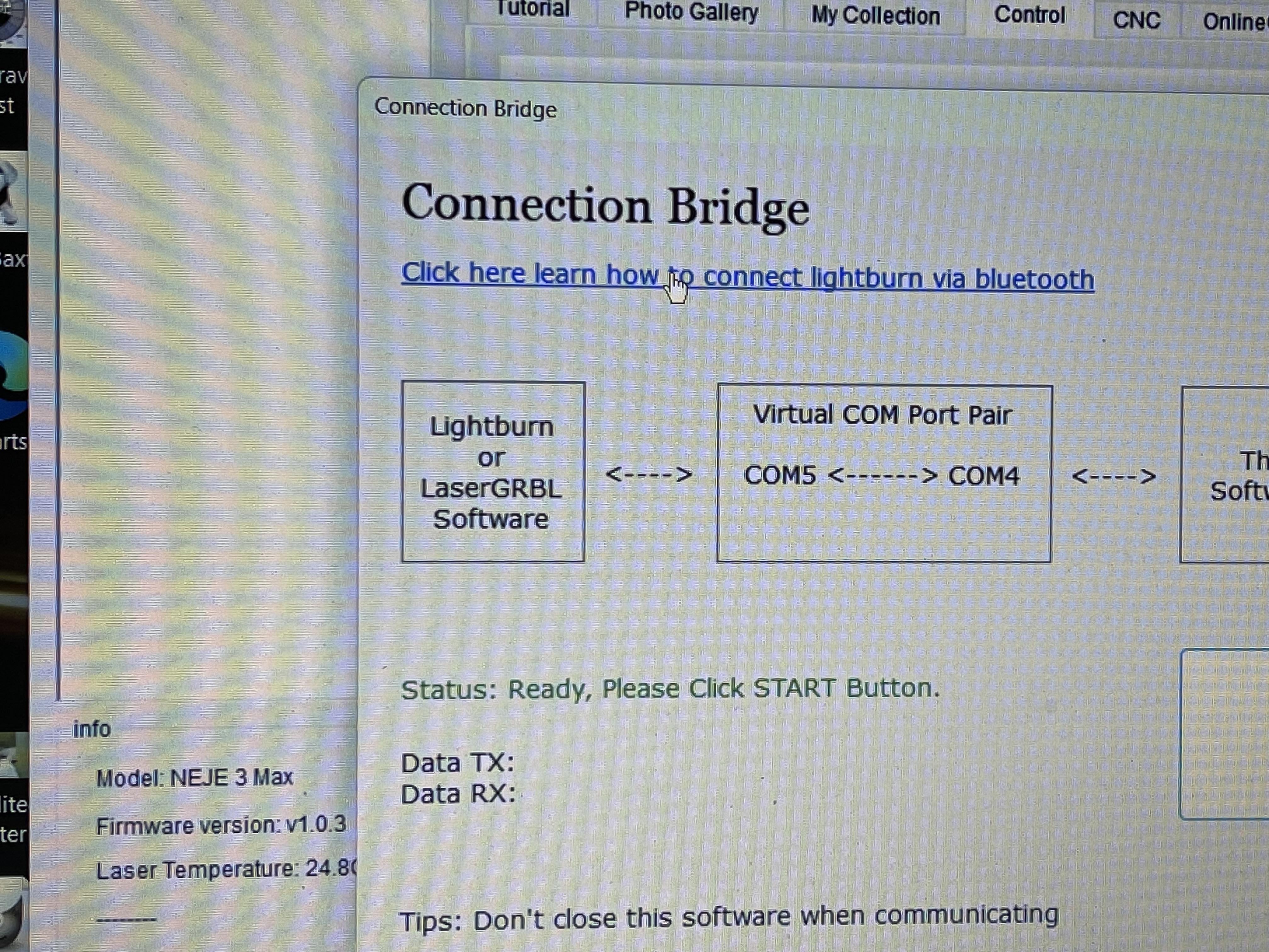

Really appreciate your in-depth responses I’ll answer the Bluetooth in this reply.
Bluetooth connection

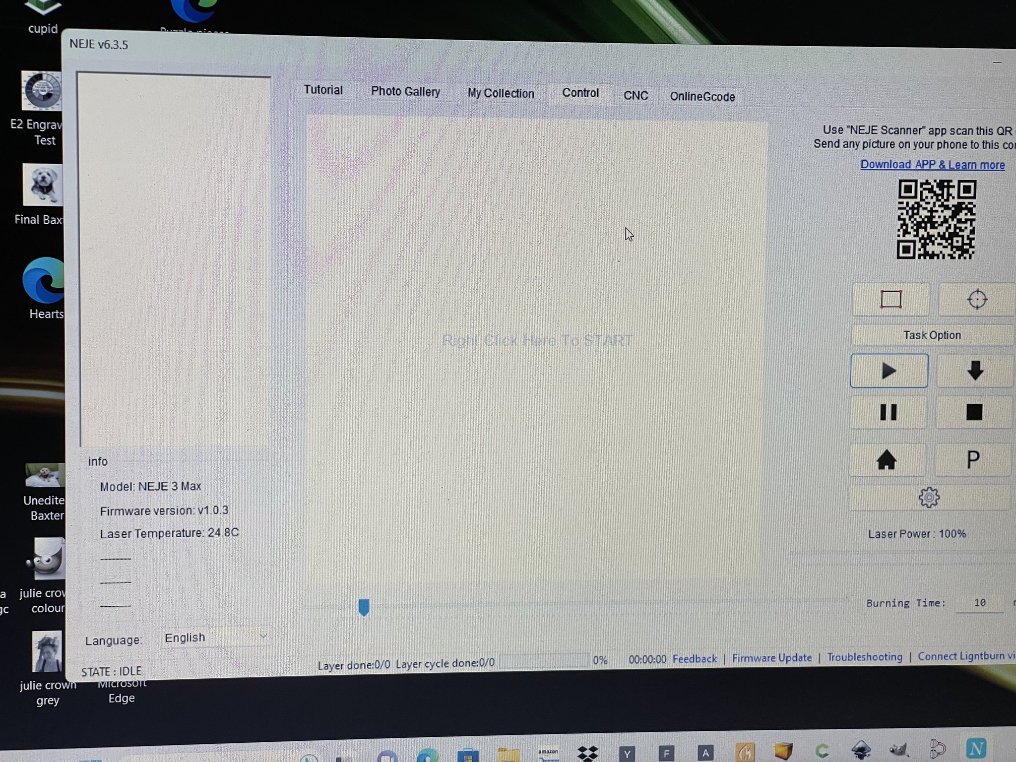

Firstly I start with the NEJE app. Must be this version or later. (I don’t believe you can run this on Mac so to update firmware you need to connect to a windows computer from time to time) I was using exclusively Mac once the machine was up and running.
Then upon opening the app and with my laser turned on I get this display below. Currently the usb cable is not plugged in so there is option available for a physical connection via USB
After selecting Bluetooth option I get my user interface
Down the bottom corner is the option to connect via Bluetooth to lightburn

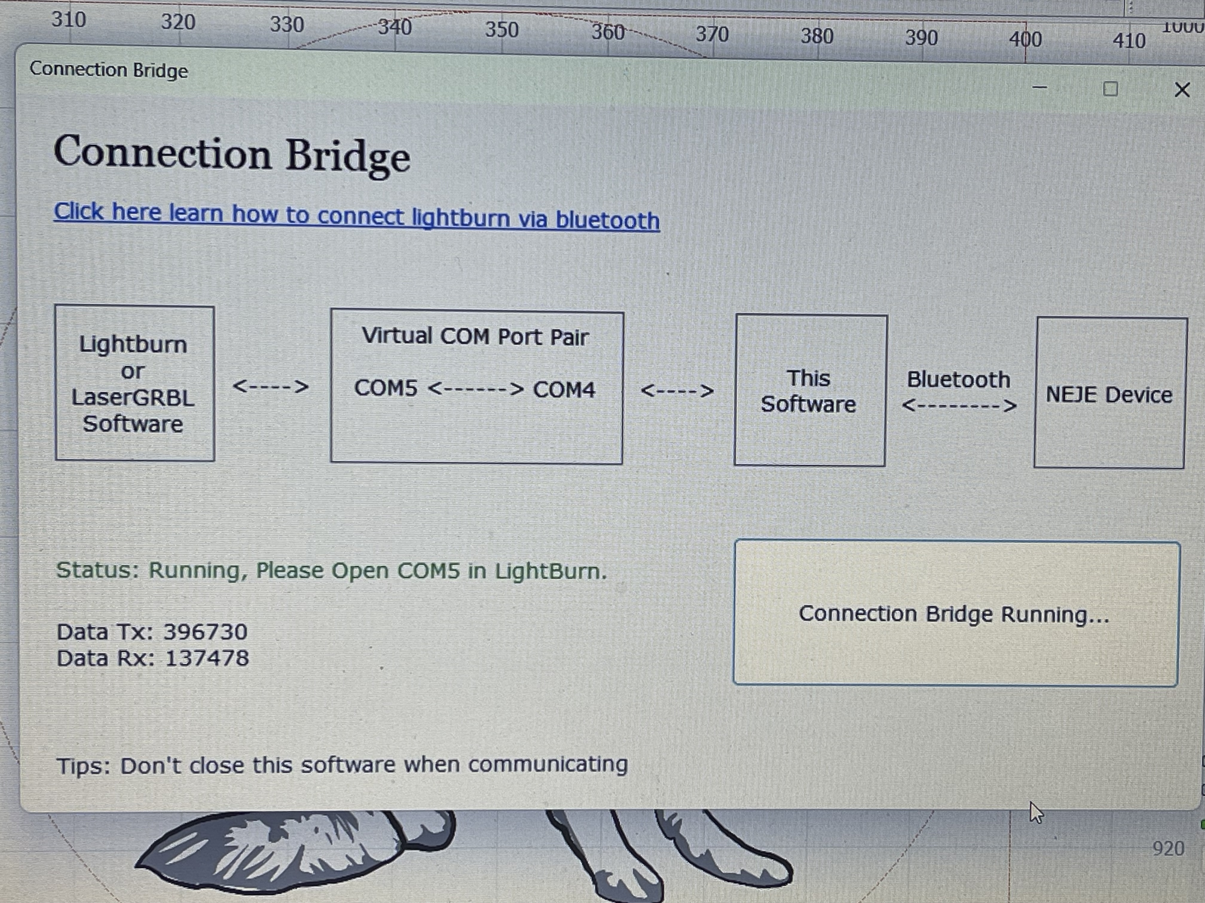

That is when the connection bridge opens to connect via a virtual port thru the NEJE app

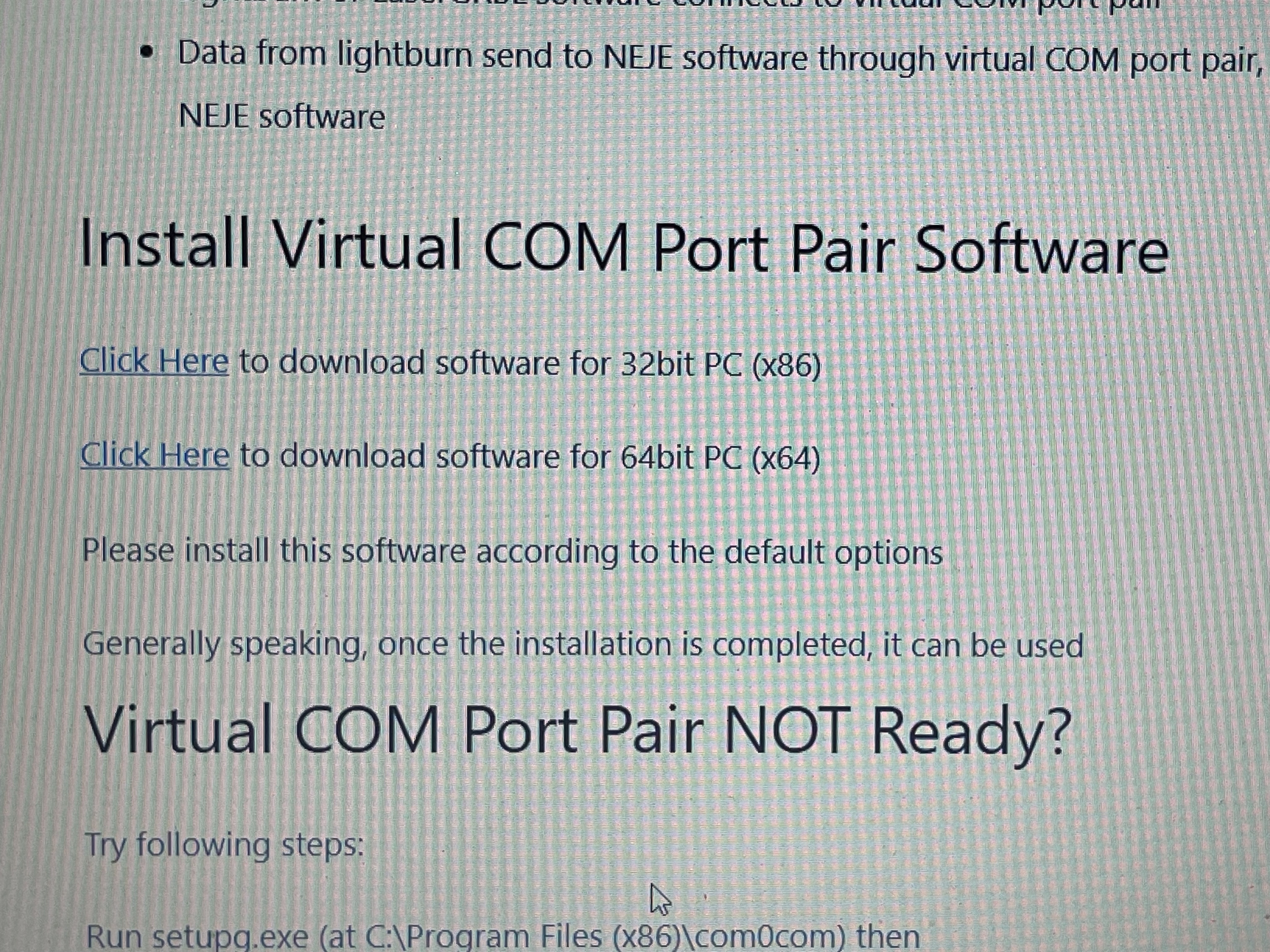

In this box is a link to ‘learn how’. This will take you to the web
On the web page it gives you a run thru various details and a link to download a driver that allows the Bluetooth connection

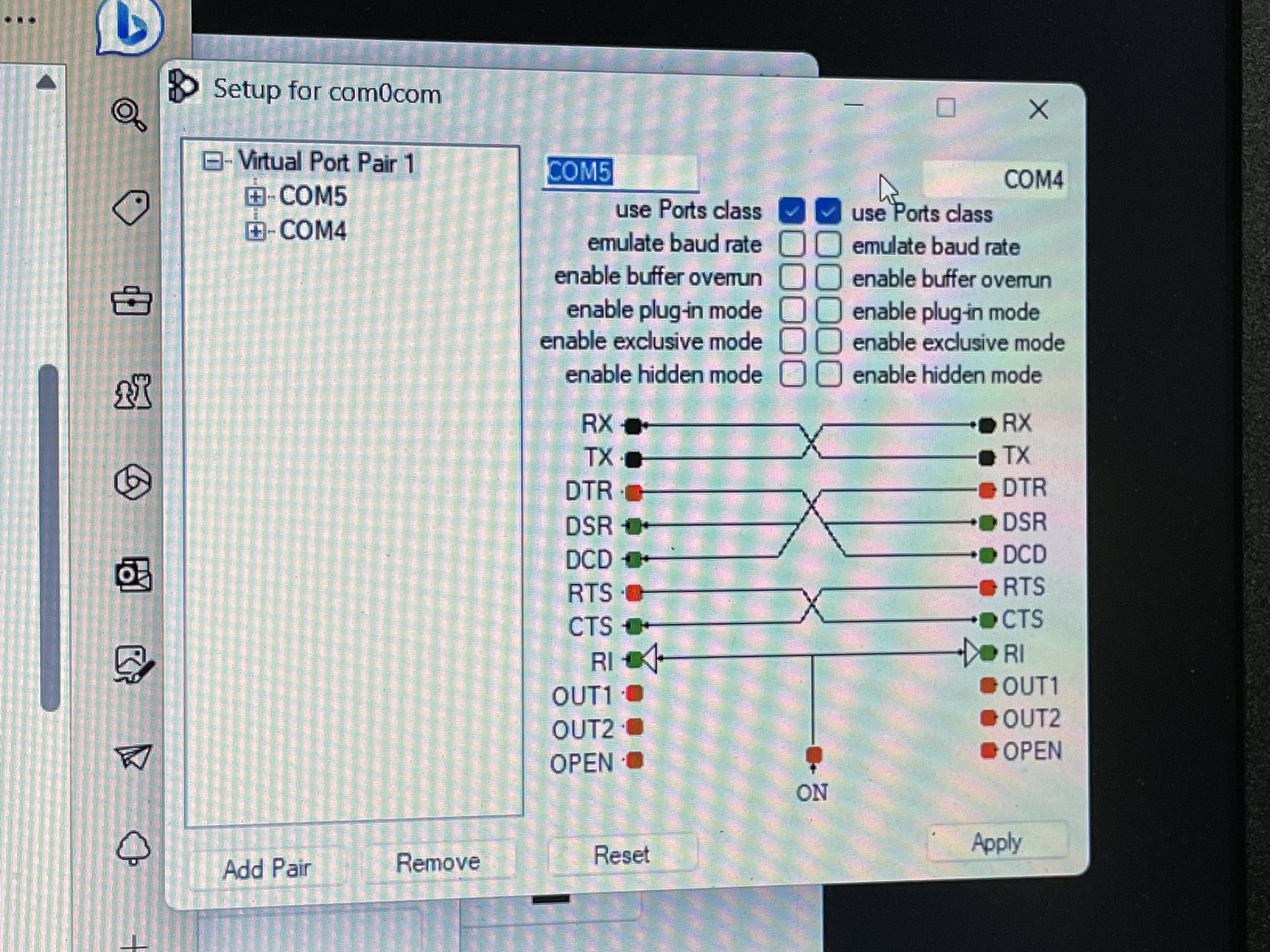

When installed and opened this is what the driver looks like. I have already configured it.
Yesterday I had about 5 connection options in the list. Just now I have deleted all but one just incase there was some kind of Bluetooth interference that caused my failure yesterday after I thought it was going fine.

Moving onto the bed and machine set up. My background is carpenter / joiner. My nickname used to be mm man do to my fastidious nature. Yes the machine is within 1/2 mm of square over the entire area
I have done large runs like the ones you saw in the previous post on numerous occasions with no incident. I do take your point. The bigger or more you do at once the more room for error. As you could see the first row started at centre of coasters but gradually slipped to the right. It was as though it was adding a step or two with each subsequent row on the x axis. This was why I switched to the Y a sis with -90° travel. It appeared to somewhat alleviate the issue but there were still problems. About here was when it started to just stop mid project or show constant busy
Well I tried the blue tooth again and rotating back to to 0°
All was going well then I heard it stop
And the log shows nothing
The only thing I did notice was a notification for a message on messenger. Could it be in this instance the messenger notification via wifi created an issue.
I’m going to try again with wifi turned off
And turned it off and still no good. Stopped and no errors showing
