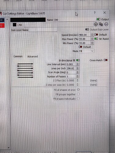

I bought a new machine, aeon Nova 16, 100 W. and also a new computer, so I thought I would up upgrade to the newest lightburn verion thinking maybe everything would work this time. I had the exact same thing happen. I"m just not getting it, I cant figure out where or what is going wrong? Any advice would be greatly appreciated. I will attach a photo of the last engrave attempt.

  1. Give us an idea of what’s not working… What is all wonky?
  2. If you don’t mind, you can drop your .lbrn2 file here and we’ll look at it for anything that may cause an all wonky condition to arise.

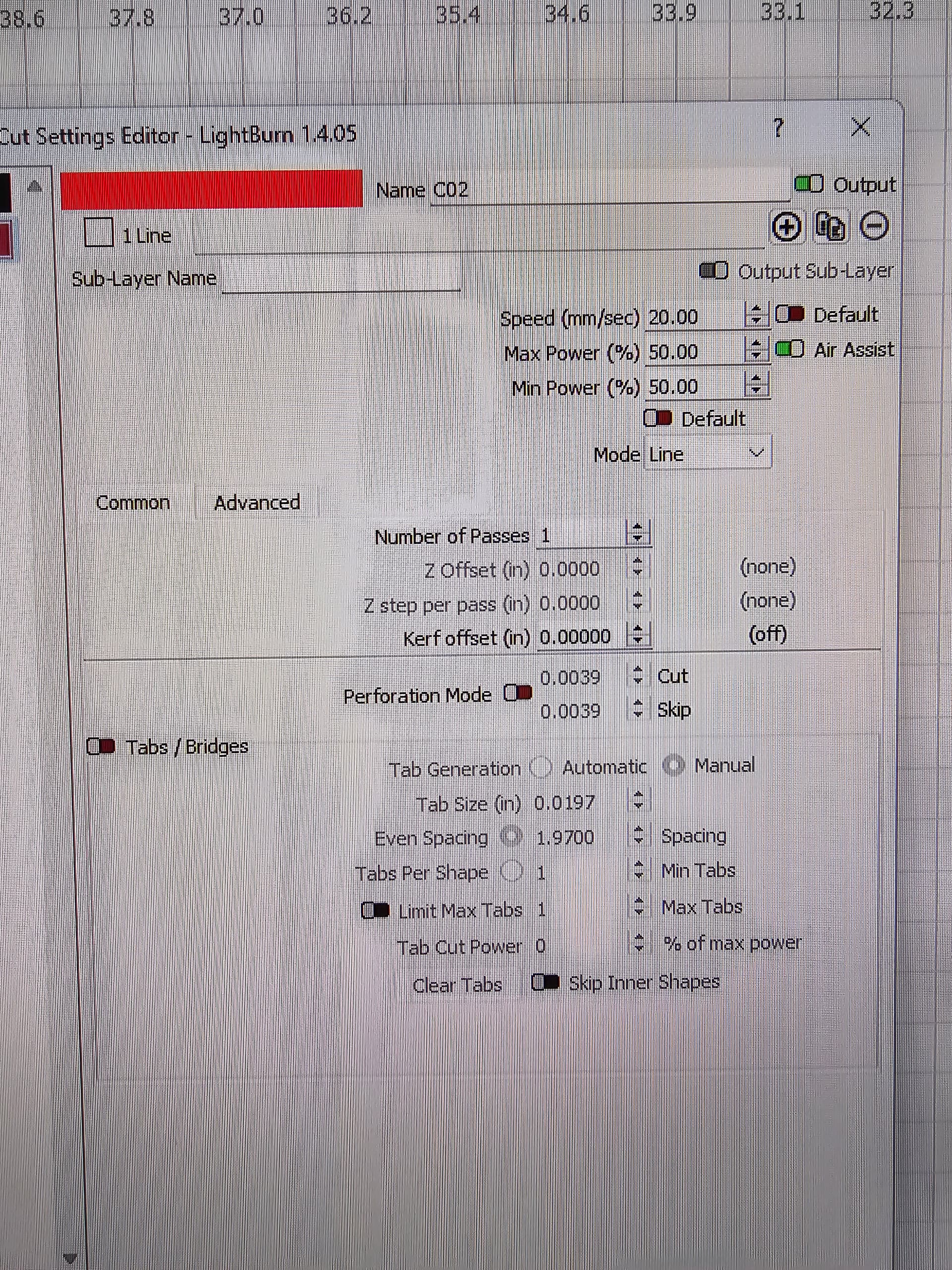

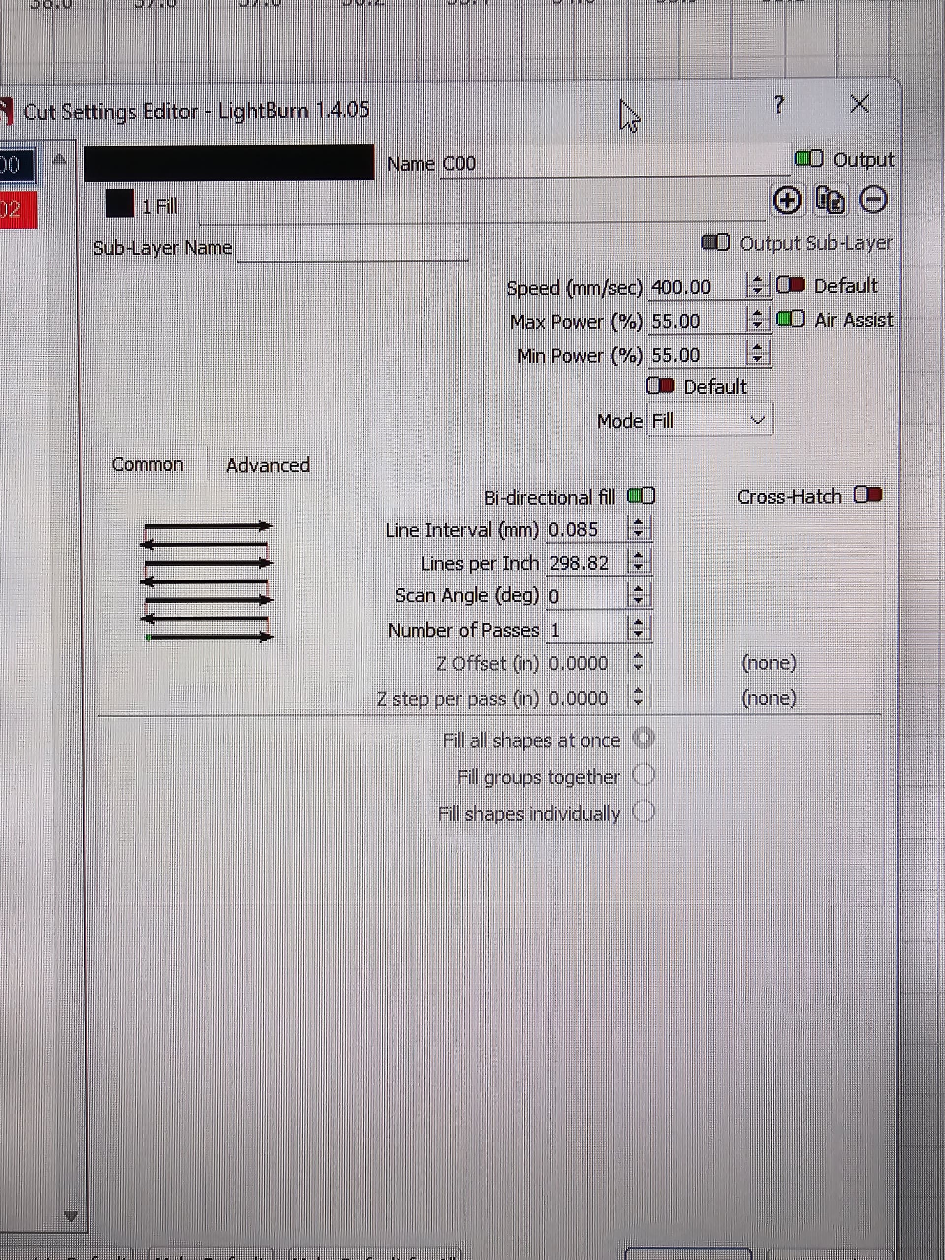

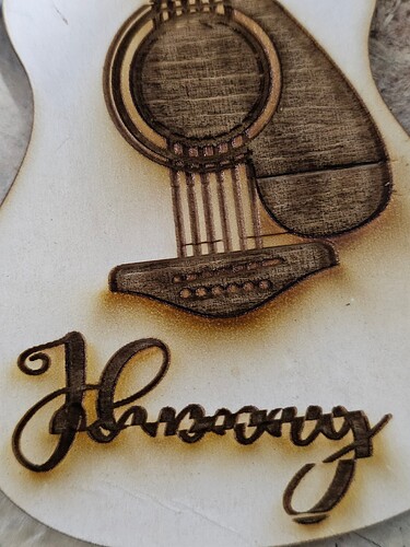

What I should have said instead of “wonky” is it looks like the laser has skipped and started engraving in areas that it should not be engraving. But as I mentioned, it is only when I upgrade to the newest version of lightburn. adding photos

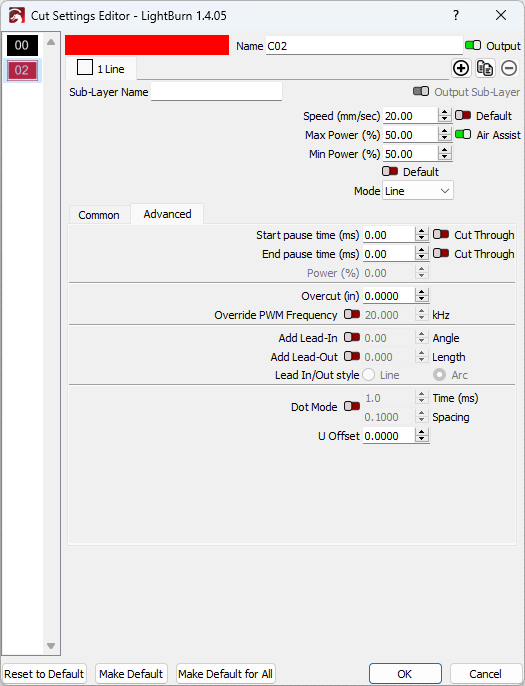

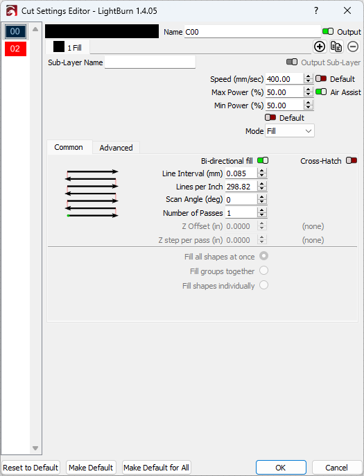

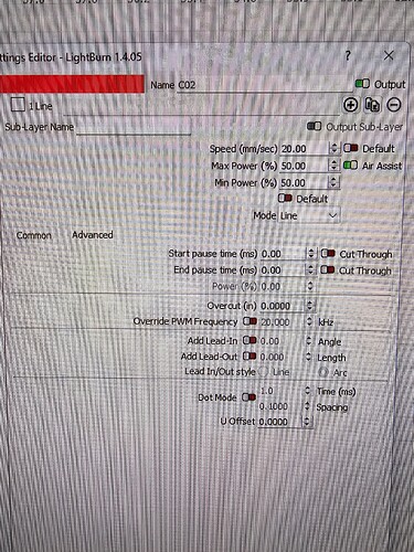

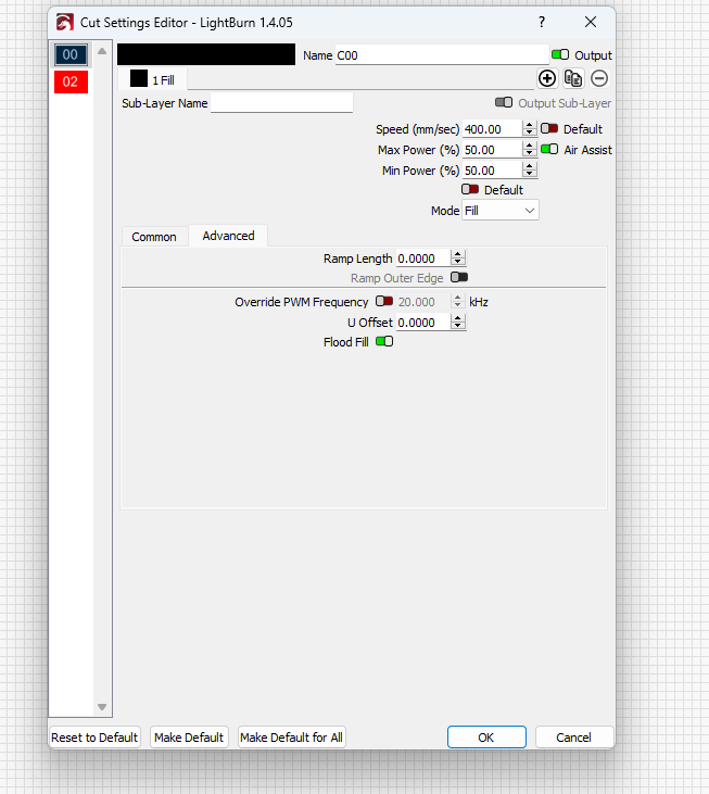

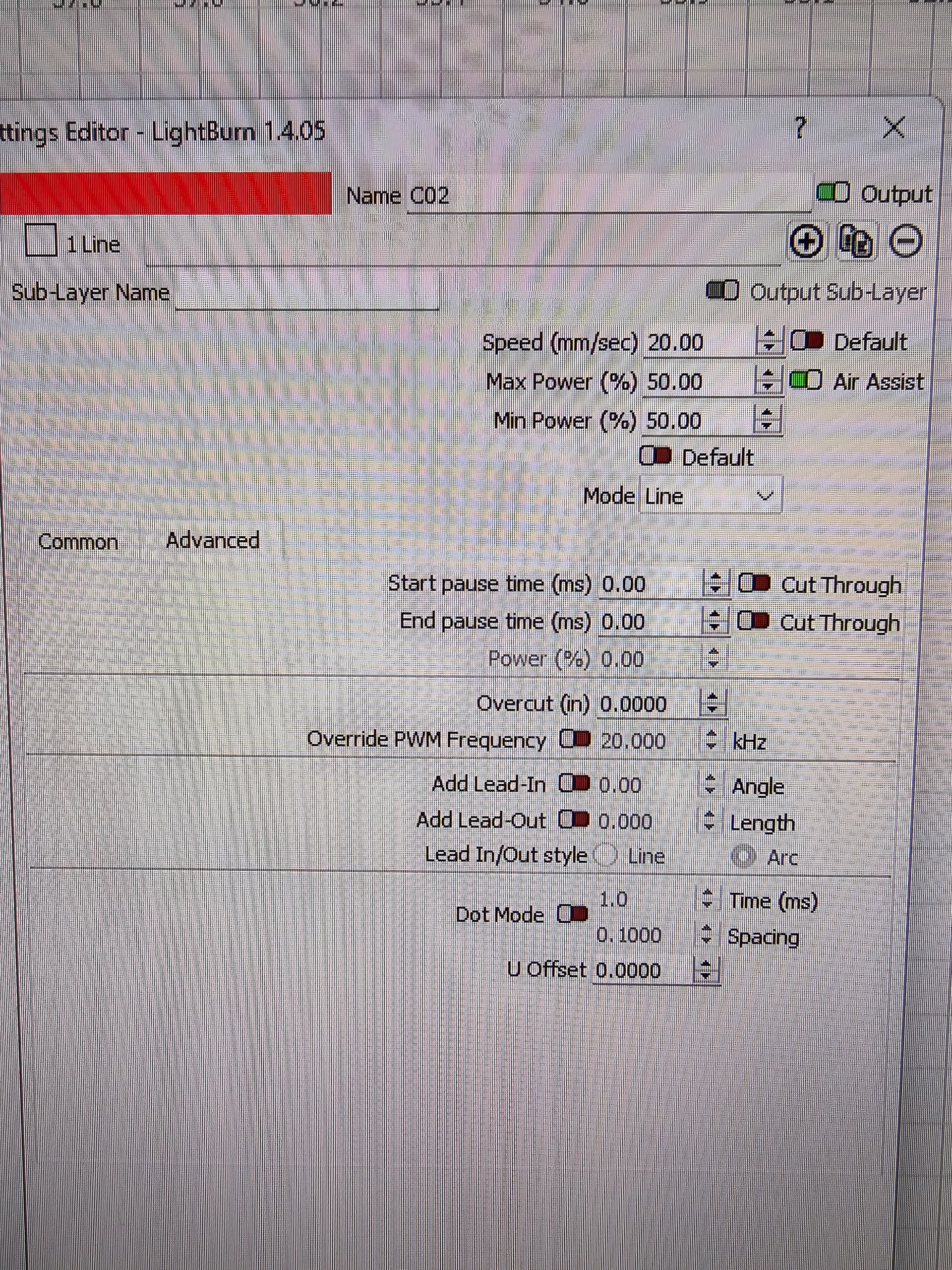

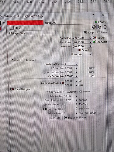

Here are some clearer photos
Actually, I can see the wonky part in the first picture: the script word is cut in half horizontally with a missing bit between the two parts and an offset to the right for the second part (and more parts, actually).

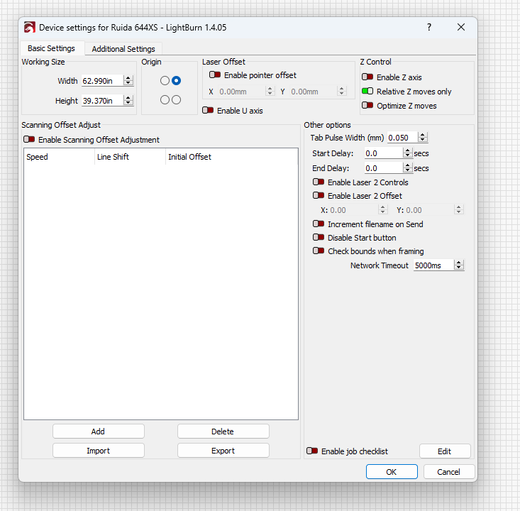

Maybe it is a problem of configuration of your laser, if the preview is OK.
Apparently both machines she has, does this, so I’m thinking configuration…
Oh, wow… I missed that little nugget. Good catch.
Yes, the preview is fine
Where do I start to figure out if the configuration is incorrect?

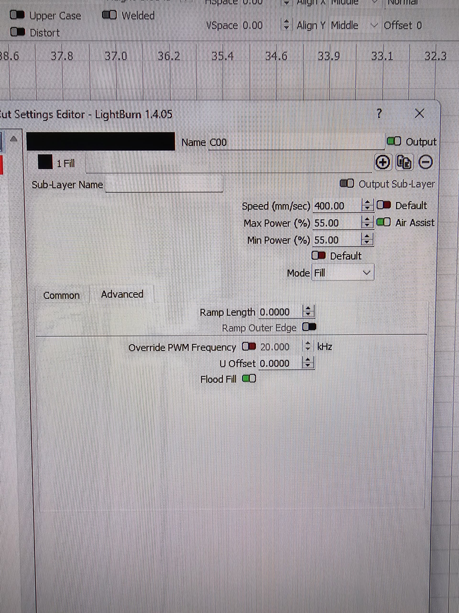

Try the same without flood-fill. Ruida controls can sometimes have issues with small areas and flood-fill on.
How are you sending the program? Is it with Send or Start? If using start I would suggest trying the “send” button and starting from the panel.
