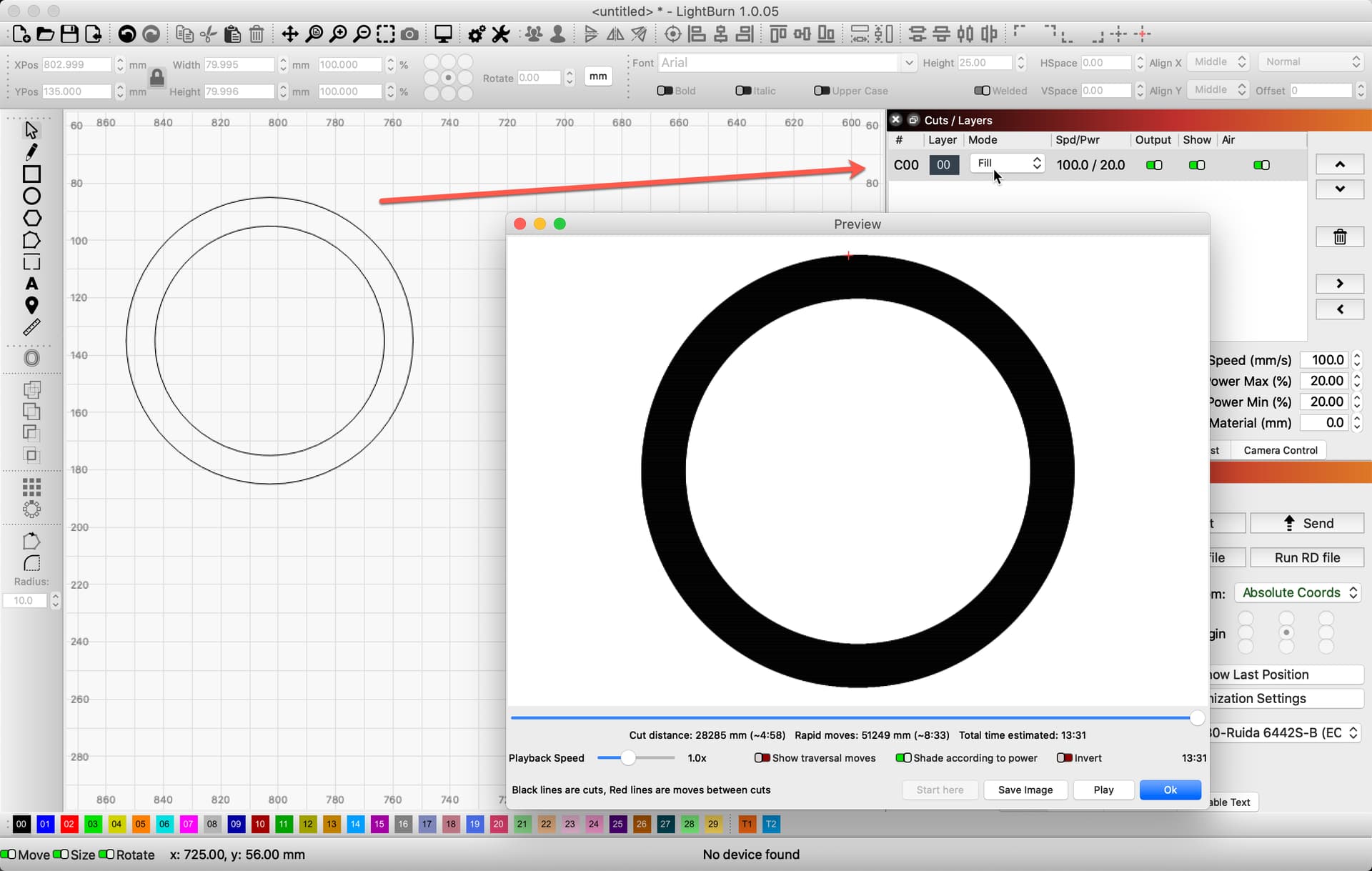

Hi all - I need to engrave the space between two sets of vectors. Example two circles one inside of the other. I want to burn the space in between them. In my cnc software I select both and create the toolpath which carves the space between. I can’t seem to figure it out in LB.

If I follow, place both circles on the same ‘Fill’ layer.
If I am missing it, show us an example of what you have now, and what you are wanting to produce, and we can go from there.

Well that did it I need to get away from thinking the way I do with the CNC stuff while learning LB.
