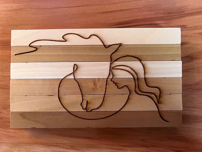

I’m working on a project in which I’m engraving across three pieces of wood. They are single long wooden cubes about 1/2 inch thick and 6 inches long. The hope is to be able to turn them after engraving on one side and then engrave on the next side. But I’m finding that the first engrave kinda burns into the small spaces between the three pieces and when I turn them, hoping for three more clean sides to work with, there’s some burn marks. I’m curious as to whether I should somehow create some kind of ‘erasure line’ with light burn that would go the full length of the drawing and therefore not burn that very small minimal section between the pieces. How would I do this in Lightburn? OR… do you have other suggestions? Thanks

Thank ya’ll for getting back to me. I’m attaching three images to help get a better understanding of the situation. I originally engraved these within a jig that tightly held the six pieces together, but as you’ll see, the laser naturally burned in between the cracks as it passed over each piece. The suggestion to sand down that overburn isn’t very possible as it will begin to destroy the picture that’s burned into that side of the wood. This is a puzzle with a different image on each of the four sides of the wood. Don’t get confused in trying to decipher the second image as the pieces are not in the proper order.
But what I do want you to see is what shows when simple turning the pieces one turn from that first image. You can see about 45 spots on one picture and about 18 on the other where there is overburn from the other side of the wood. I hope I’m making sense. So since sanding isn’t an option, I began wondering if I could perhaps try to line up my image in LB with the image of the six pieces of wood which show from the laser camera, and somehow draw some kind of ‘delete line’ down through the image in LB in order to prevent the overburn. I’m very concerned that if I do so the lines won’t properly connect as desired when the puzzle picture is put together. It’s a vision I have but I’m not able to fulfill it. Again, any suggestions are appreciated.
I made 5 boxes 1mm tall (I made them this tall so they show up in the screenshot but you can make them whatever size you need) and longer than needed and used the cut shapes tool to remove the section where the blocks meet. You could then burn your image and they would stop short of the breaks between the blocks.

I’m so thankful. Didn’t know there was a cut shapes tool. I’ll find it and put it into practice. That’s just what I was hoping for. Thank you again and again.
