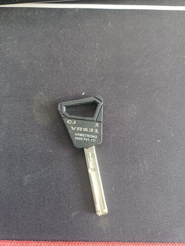

Hi All,
We are very new to laser engraving and still finding our feet.
We have an urgent need to laser engrave Black Plastic Key Heads with small lettering (1.5-2mm per character), but after playing with the settings we are still coming up with either an acceptable orange shade or the lettering has burned black. whilst the orange is okay, we obviously want to have a better result if possible
Any beginners tips for plastic engraving would be a huge help!

Much Better!
The “CJ - VRS31- 1” is our work. The smaller font characters are direct from the factory done with a CO2 laser.
I dropped the Power down to 20% and Speed of 650.00 Freq 50 kHz and opened the line interval up to 0.0500 to help prevent any burning and it came out really well

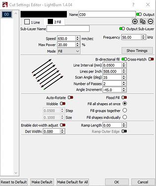

Would you mind supplying more information, such as settings and F type lens used?

Using Lightburn Software and F-Type Theta 1064nm/50w Lens, I ran 2 layers. 1 line at 650.00 Speed, 20% power and 50kHz for 1 pass followed by a Bi-Directional fill at the same settings with an interval of 0.0500 mm for 2 passes, which seemed to make the difference from my previous attempts (Pictured)

Thanks for the layer screen shot.
