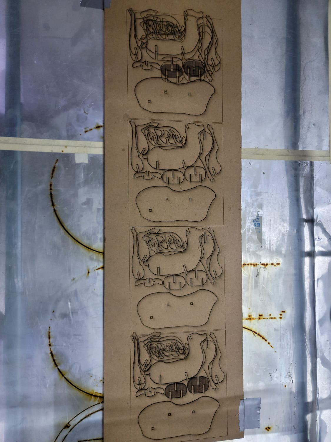

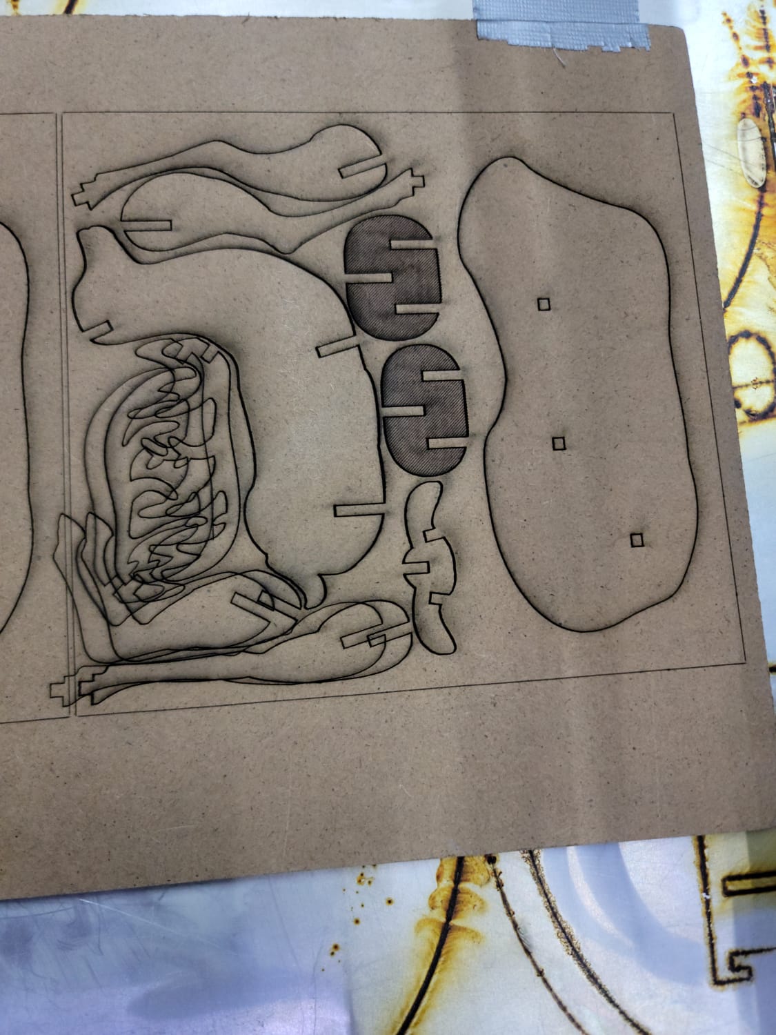

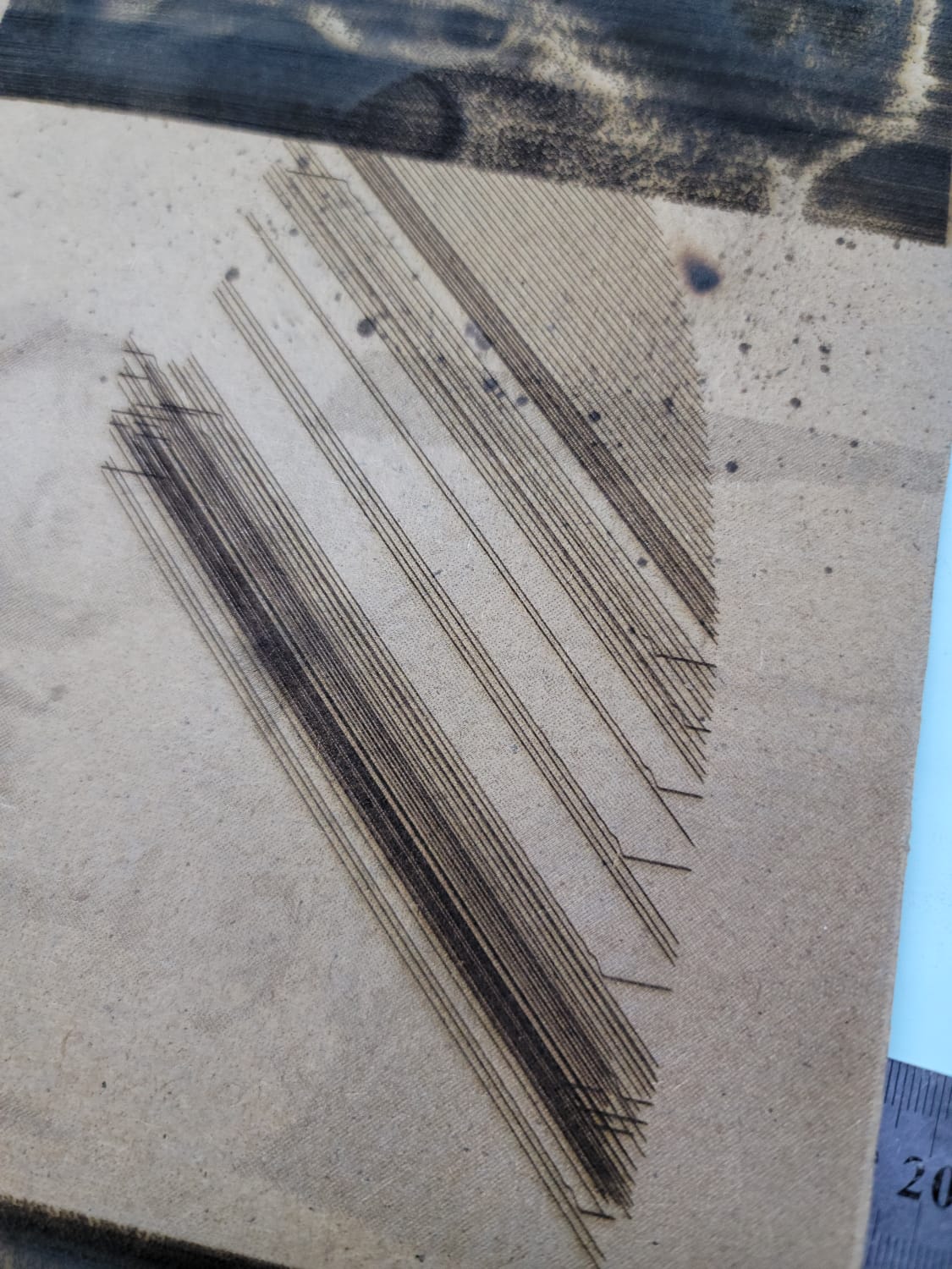

Hello, i do not know to explain the error that can be seen on the images attached, i hope somebody can help me.
is very random when it does it is on the Y axis
BR
This is likely a mechanical issue.
Review belt tension and make sure that the pinion gears are properly secured.
