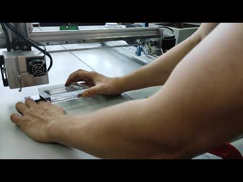

I think you’re at a disadvantage based on the wavelength of a diode laser as the material is effectively transparent to the laser. The laser is most likely only affecting the masking tape (and causing heat gain, reflection, warping, etc on the screen protector).
I am guessing here, so let’s see what anyone else may have to say.
Here is a video providing an example of a technique to engrave on glass / acrylic with a diode laser:
The problem I see with using an anodized aluminum is the adhesive on the back of the screen protector burning. The masking tape is preventing it from going through and burning the adhesive back.
This video has a product but I don’t know if it is on the top or bottom of the glass.
https://youtu.be/zCpZu-UrEjQ
