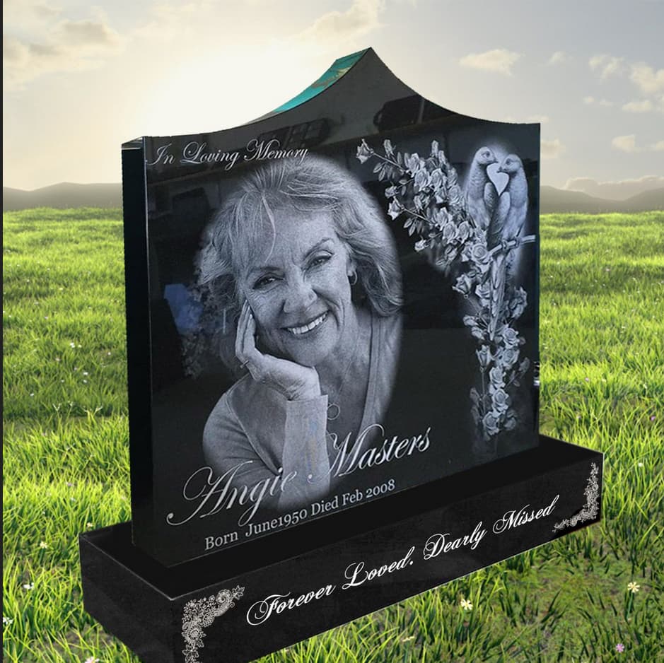

Show some pictures of the results to help people judge it.
I assume you mean something like this?
