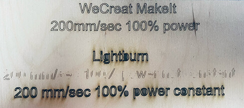

I’m having issues with my WeCreat Vision Pro 45. If I use the WeCreat Makeit software I can get clean lines. ( see photo)
In LightBurn with the same speed and power if I don’t turn on Constant power I only get the straight lines. (see spotty line in photo)
If I use constant power the curves over burn and on tight curves it will cut through.

Too much speed and not enough power.
Too much power and not enough speed
Do not try to compare the two softwares. Manufacturers can do tricks they do not share with Lightburn. Just focus on Lightburn instead or you will go crazy trying to make them match.
On my Pro 45W I use 100mm/sec and 45% power and it engraves perfectly
