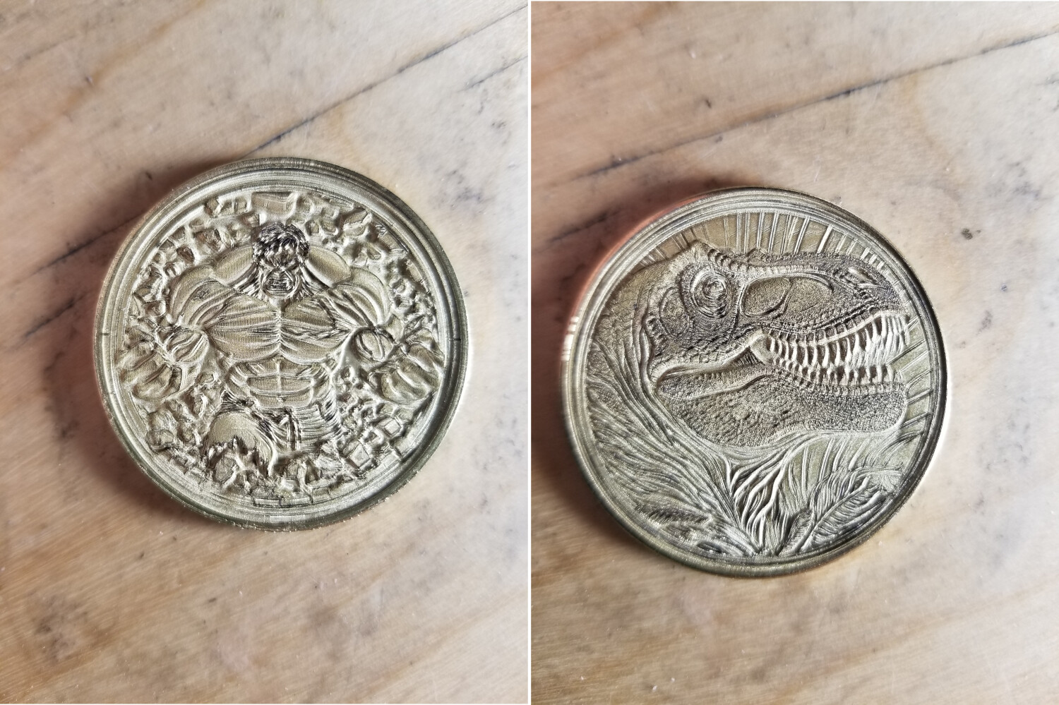

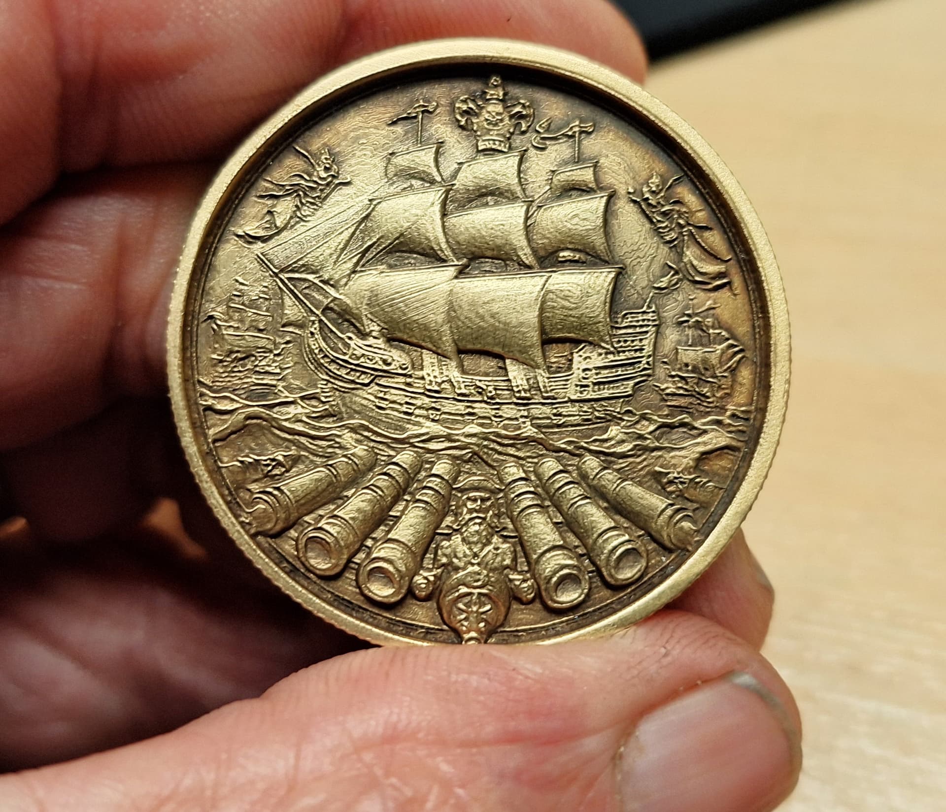

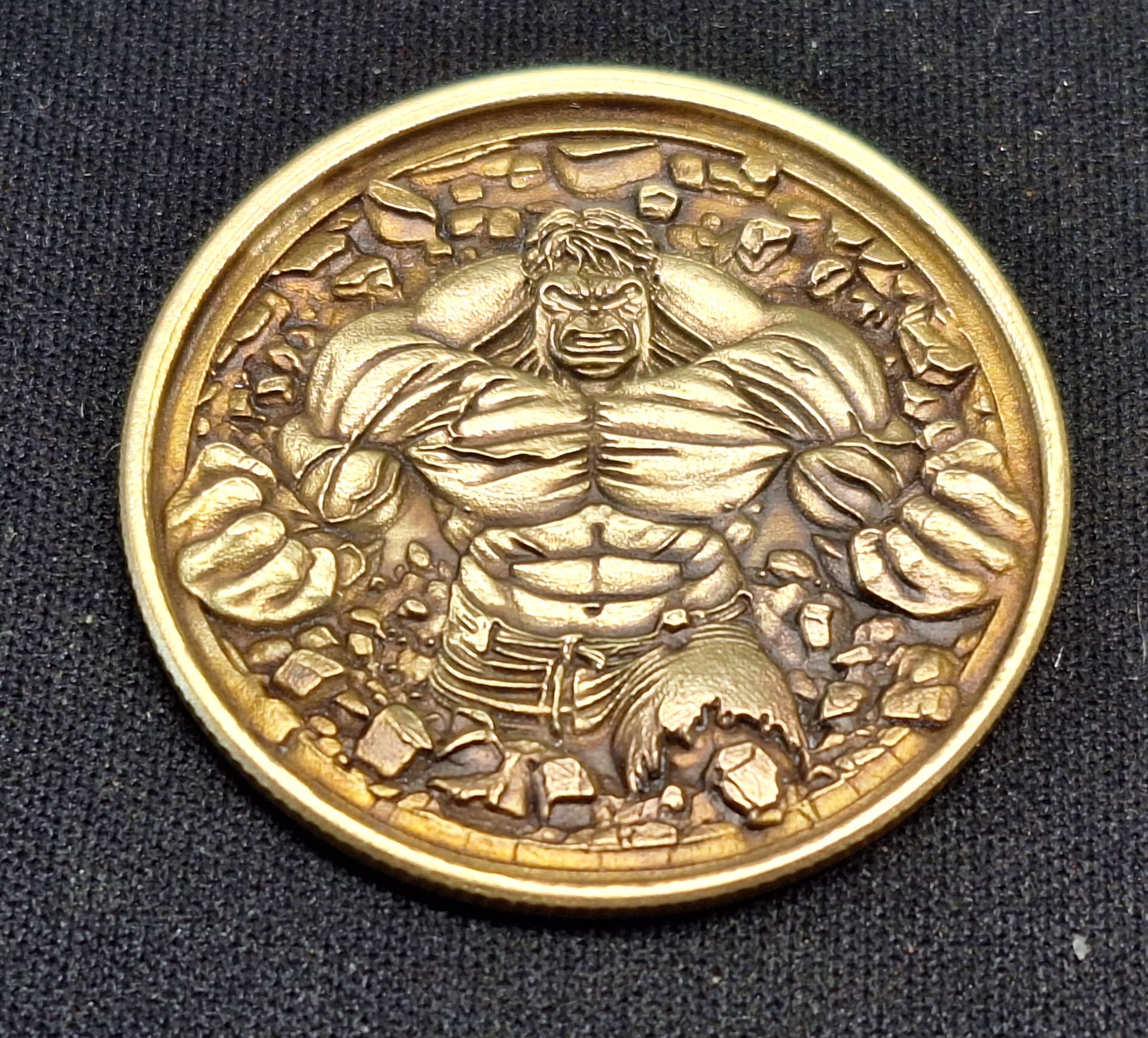

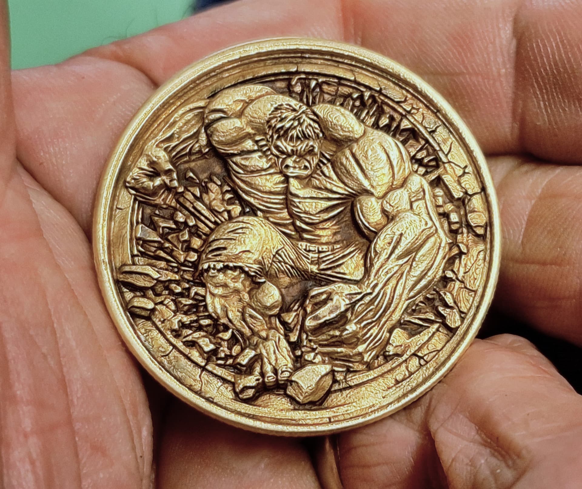

40mm brass coins from Amazon.

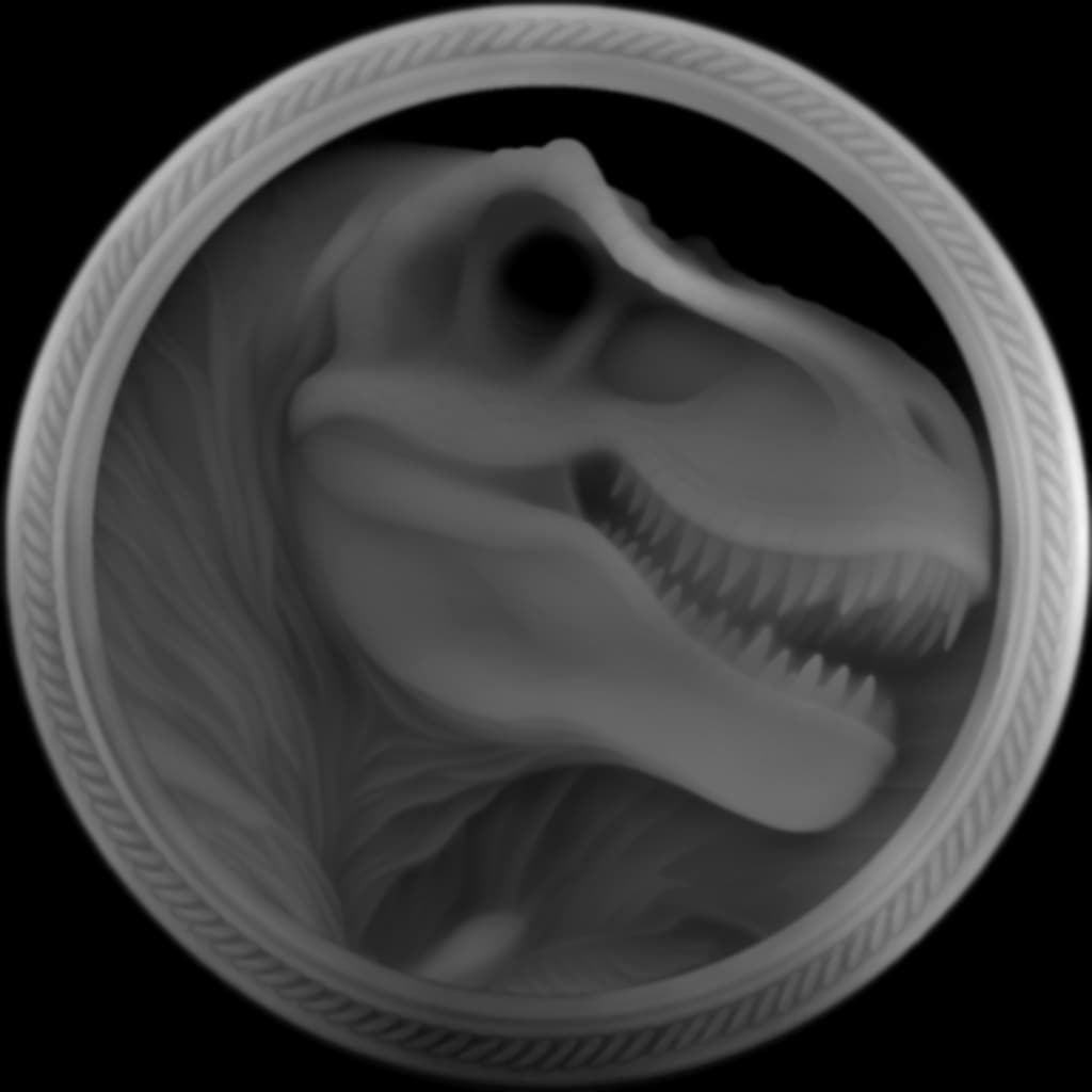

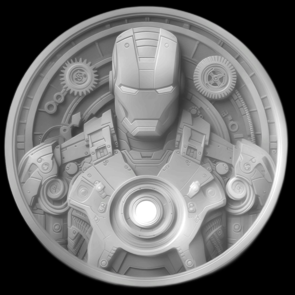

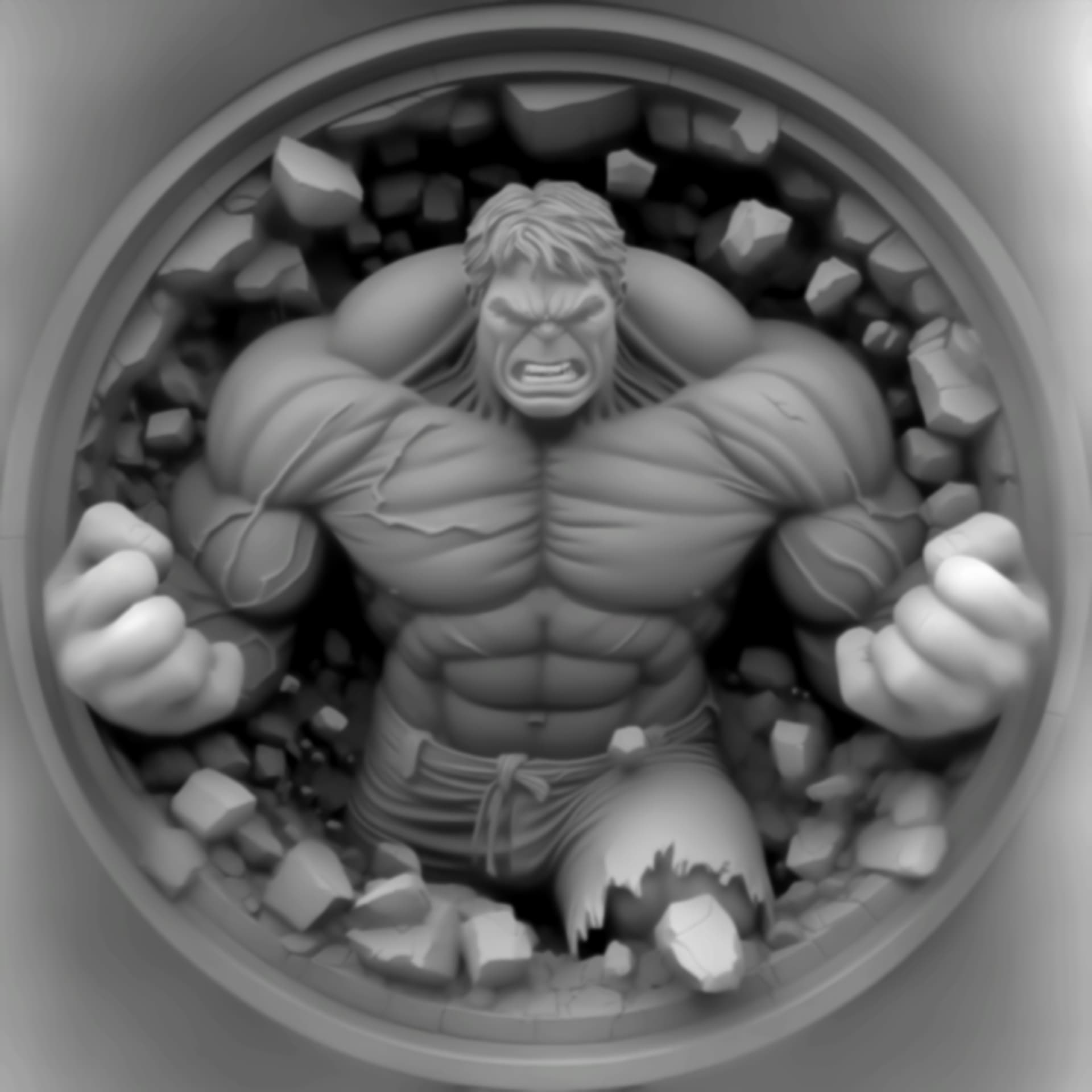

These are 3d depth maps from those images

Thankyou No this is just an illusion on wood

Brass Coins from Amazon

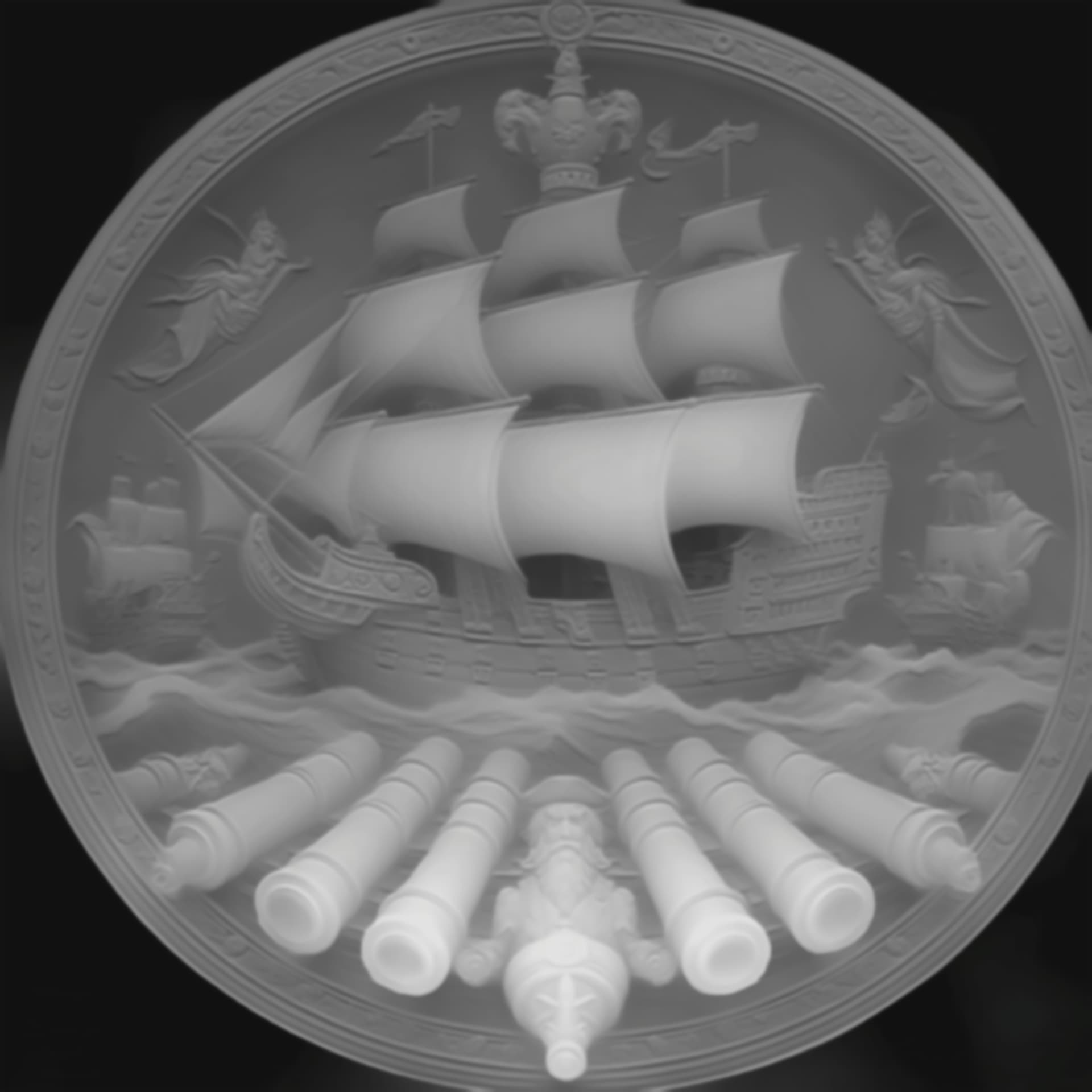

60 watt MOPA
1500/90%/120/100 350 passes 0.025 interval
They look great… I just picked a library setting and let them run…
Love the ship.
Always amazing.
@jkwilborn Thank you
These where all done in
DepthR _ I use Bing AI to generate a “detailed greyscale Bas Relief” then run that through DepthR
