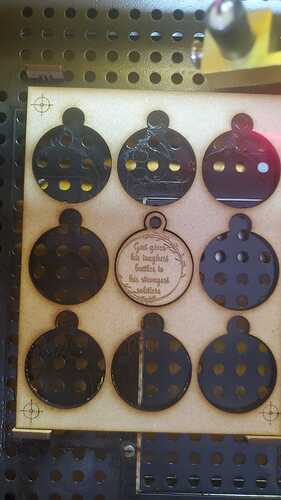

I am trying to make a template, and everything looks in its place in the software but at the moment of engreiving the design is not centered (I made some targets to the template and I lock them with the absolute coordinates but it does not stay centered, can someone help me help

It sounds like you are doing the ‘right things’… Assume you are using print & cut?
Have you done this before?
Double check that Lightburn Job Origin is ‘Absolute Coords’, sounds like you have that handled…
Do you have a camera?
How are you doing the setup?
