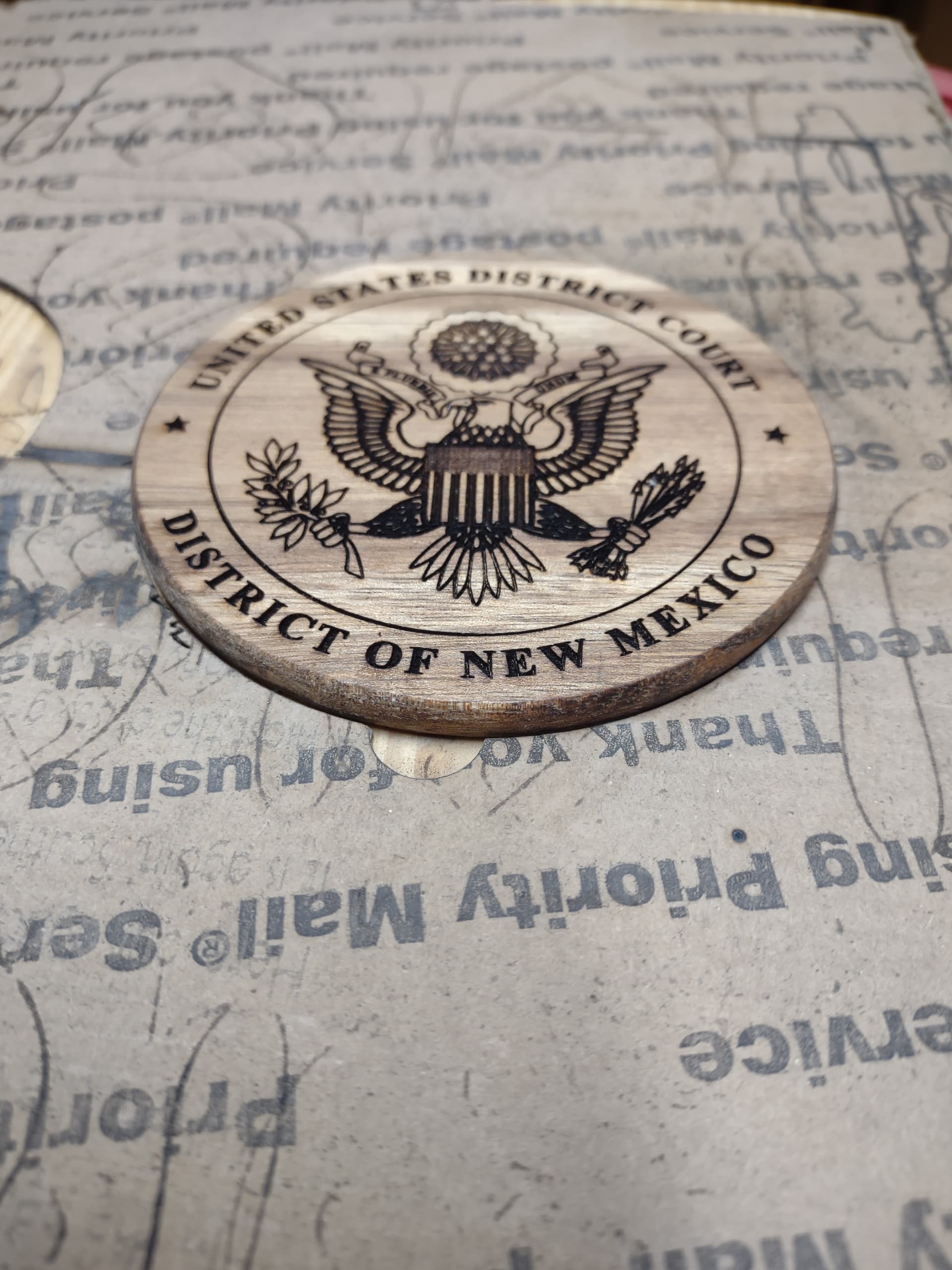

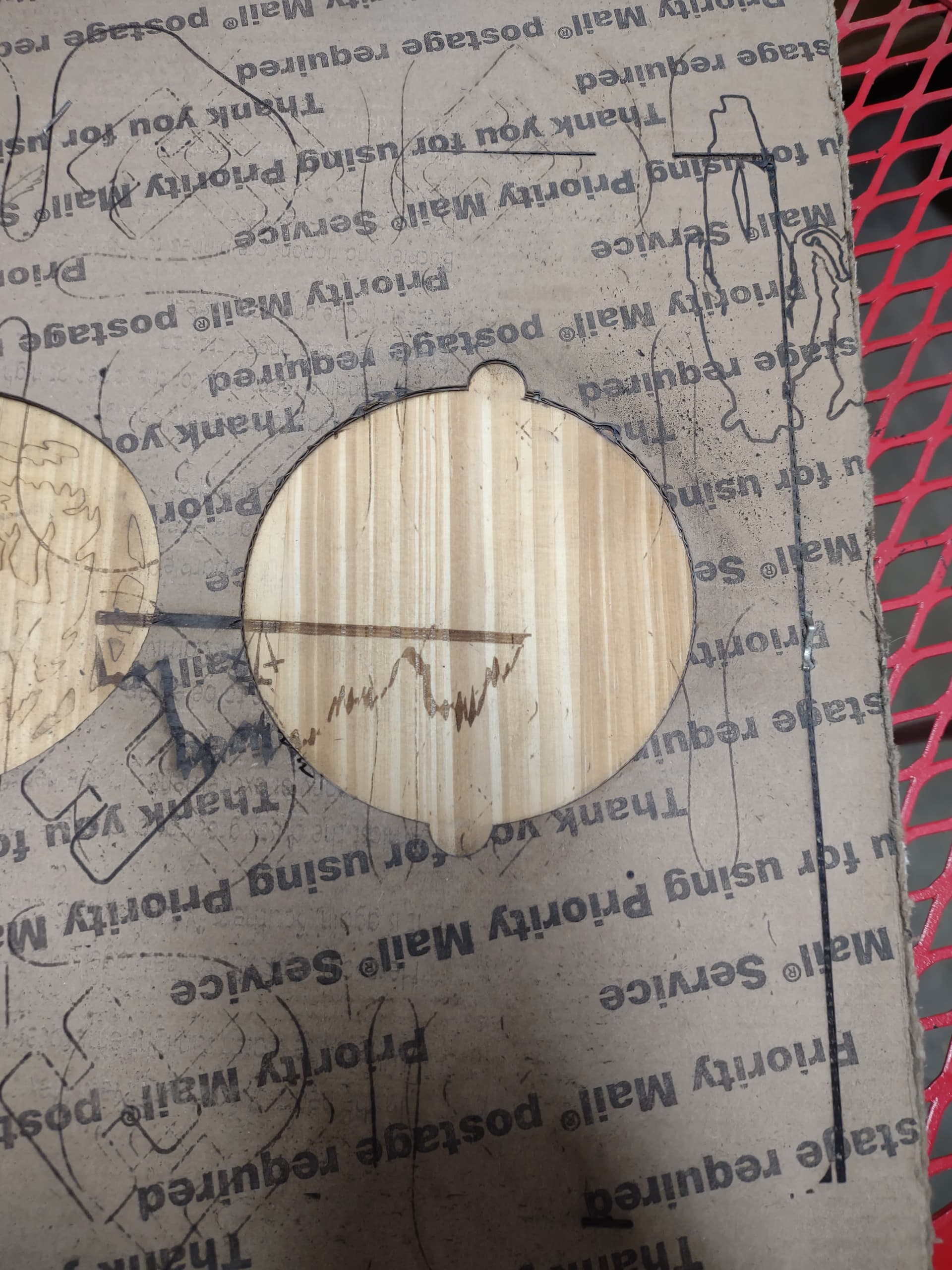

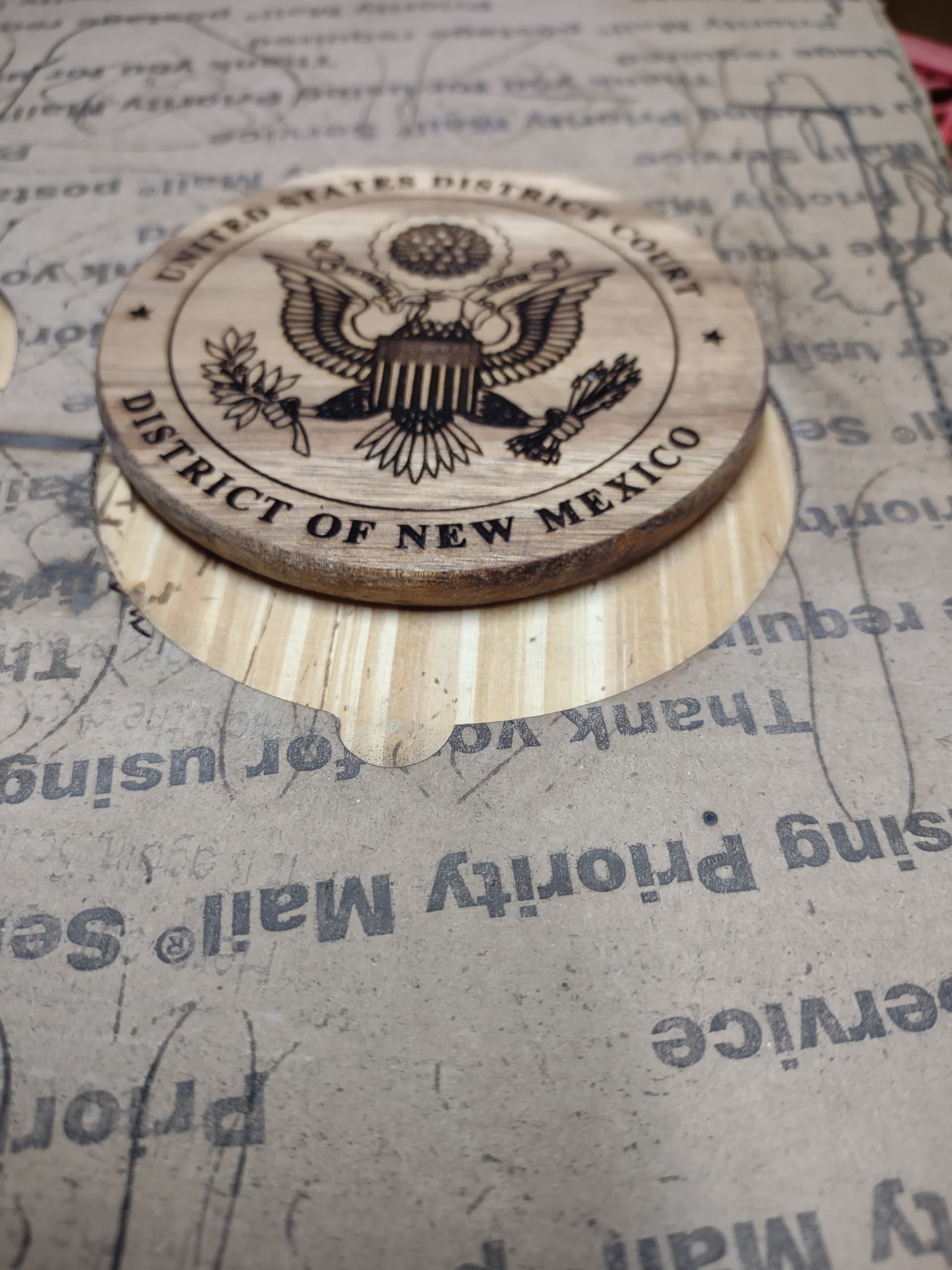

Recycled USPS priority shipping boxes make for GREAT jig material. I have also used 1/8" balsa.
I have a heavy scrap piece of 1 inch wood that I staple the cardboard to. Then make the jig cutouts a few hundreths larger than the part you want to engrave to make insertion and removal easy enough that you do not disturb the location of the jig material when swapping work pieces.
