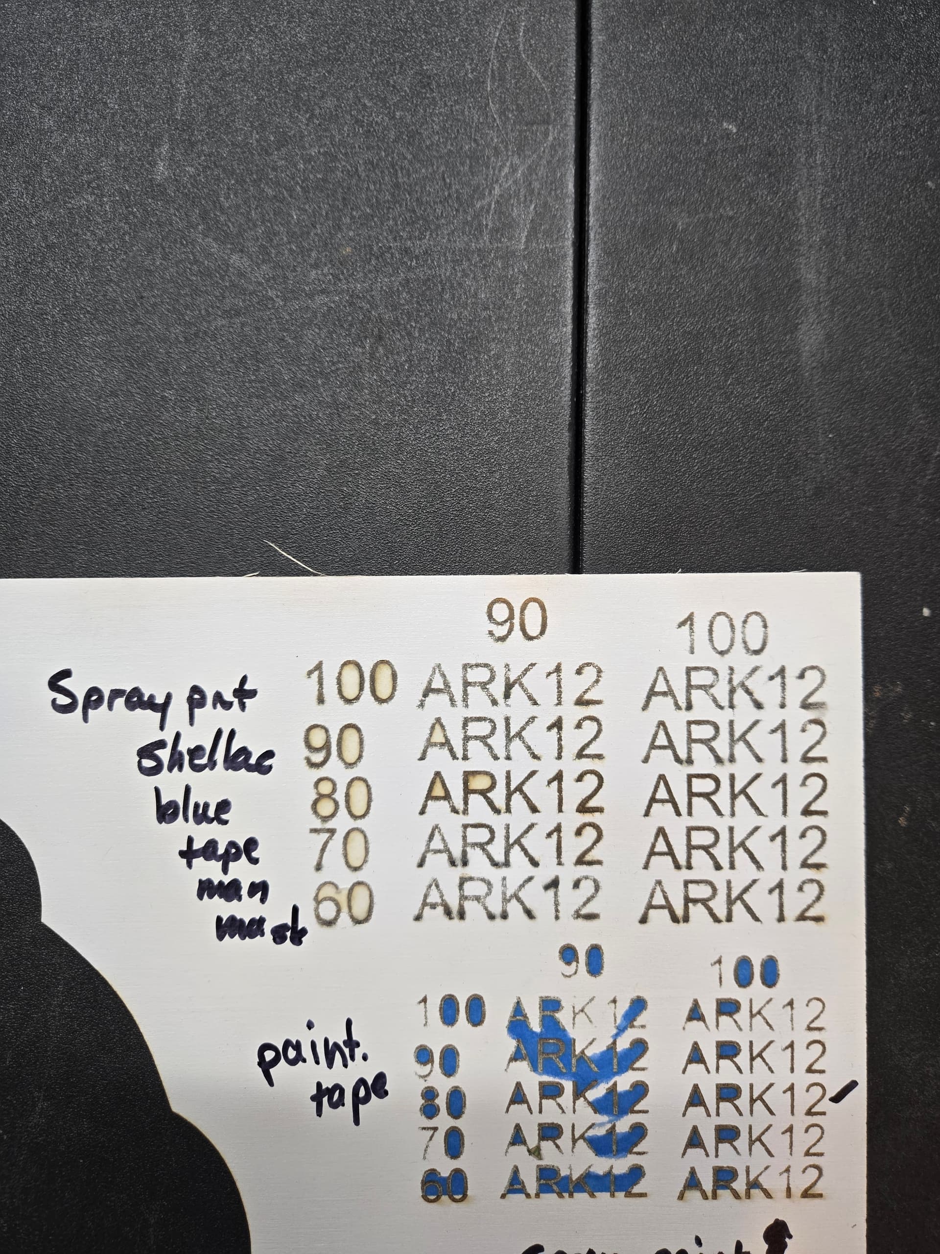

What is the best way to engrave on white painted basswood? I have a 10 w S1 and have done multiple material tests with various paints/ masking - spray paint, spray paint with shellac, white acrylic; each with different maskings - painters tape, tape man blue, 3m transfer tape; Each one leaves a little bleed under the masking, or too much soot to wipe off without removing the coloring. My engravings aren’t clean. I have found that 80/100% setting seems to work best on the material settings, but still not ideal. What am I missing??

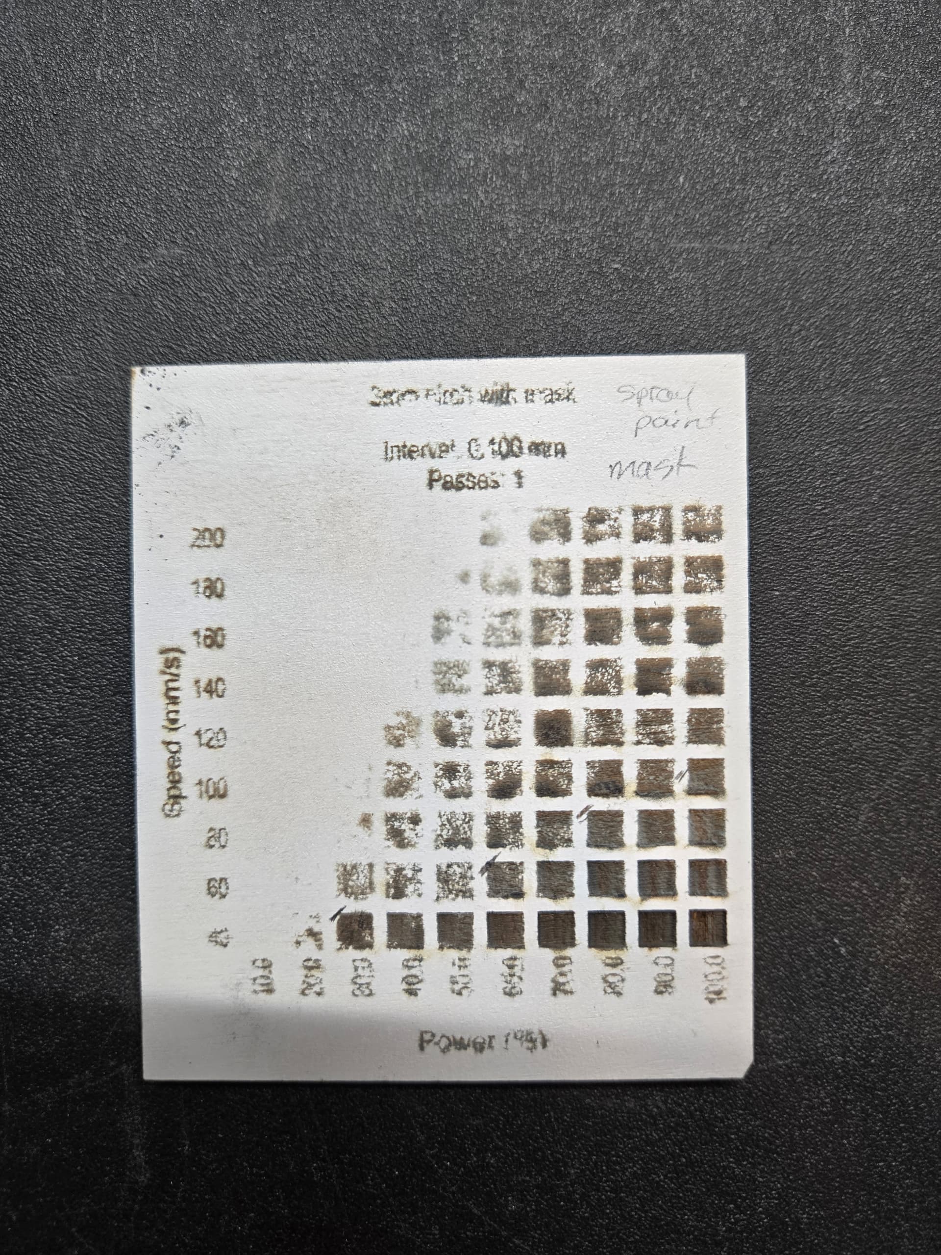

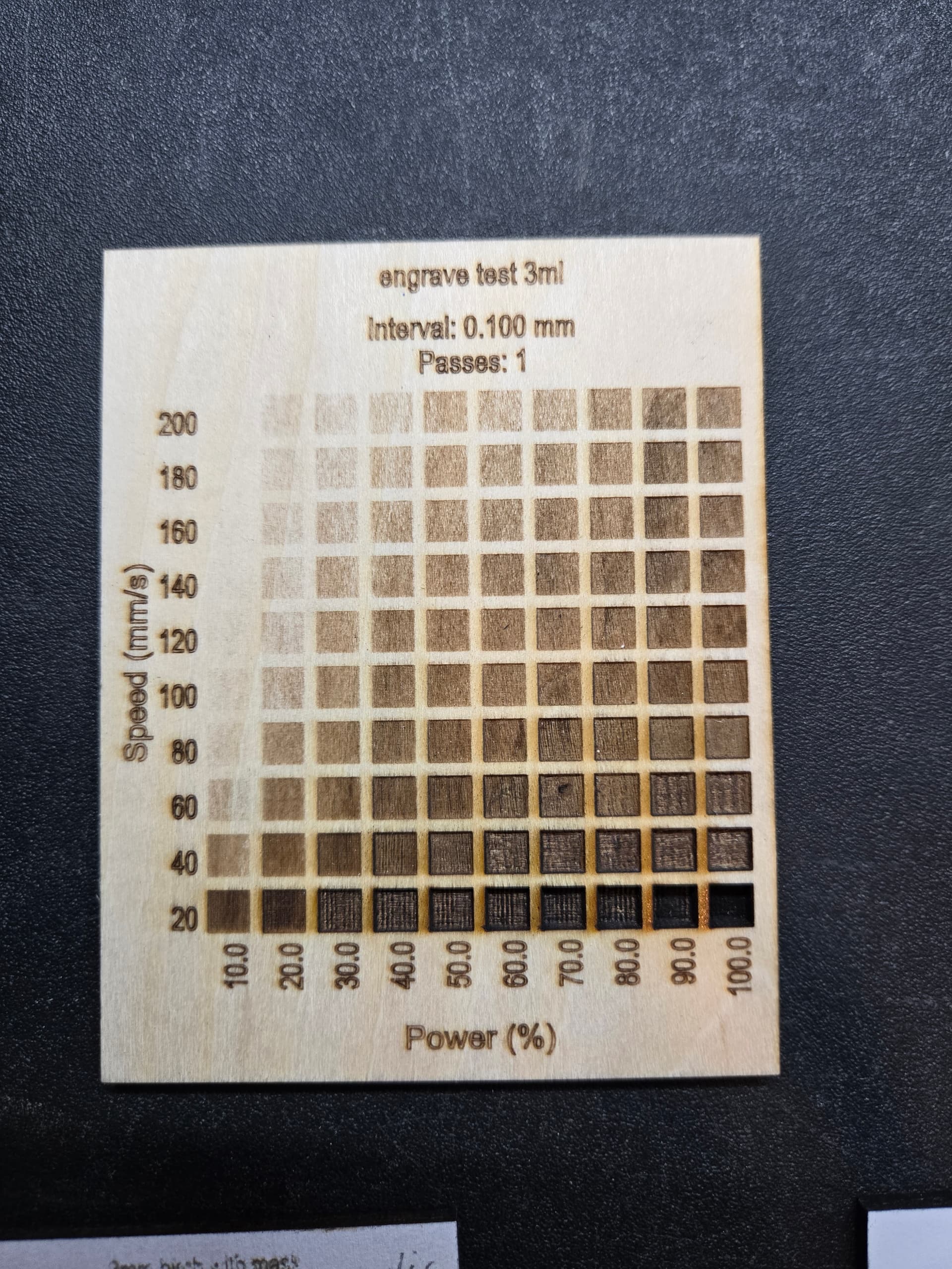

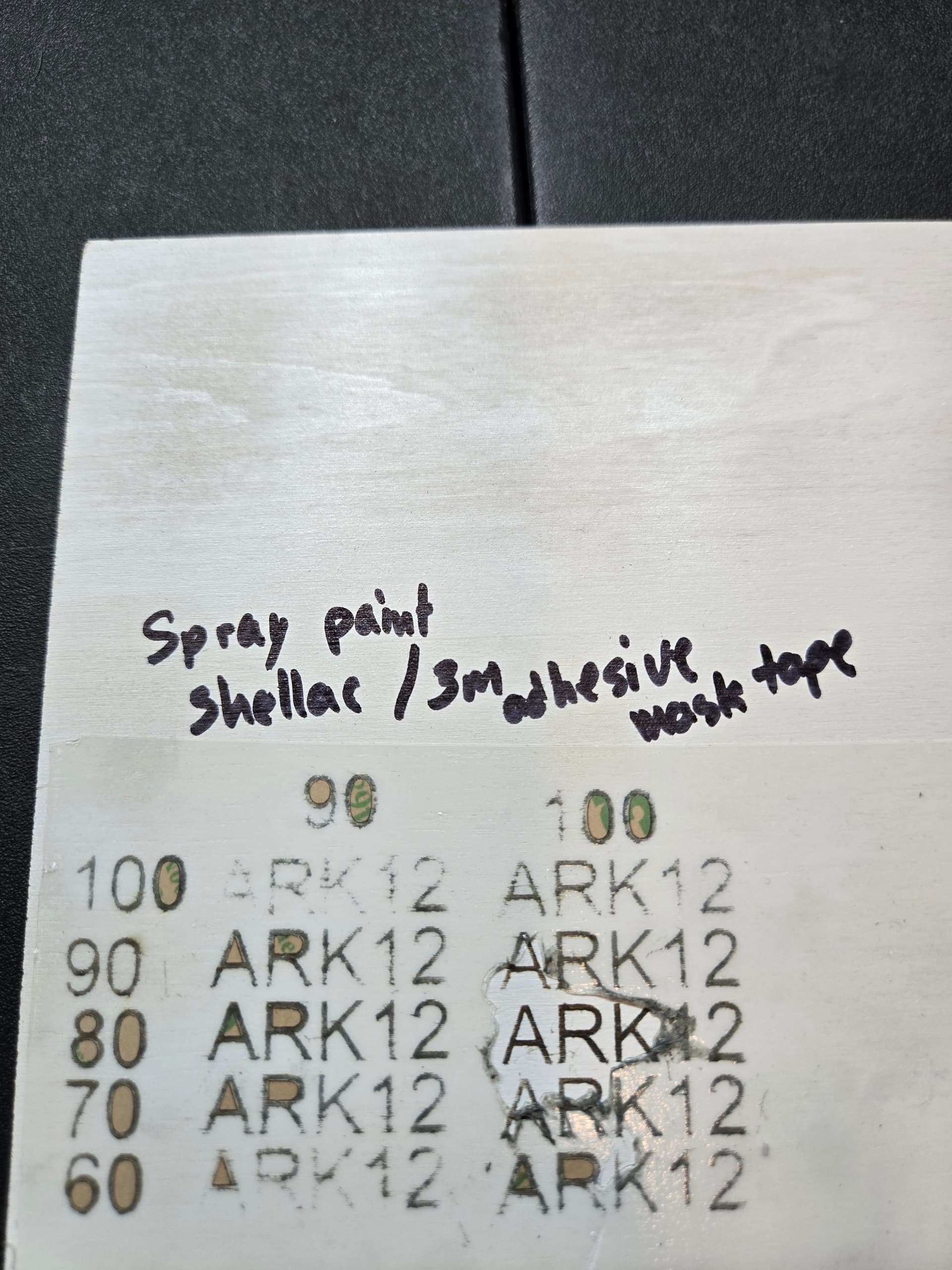

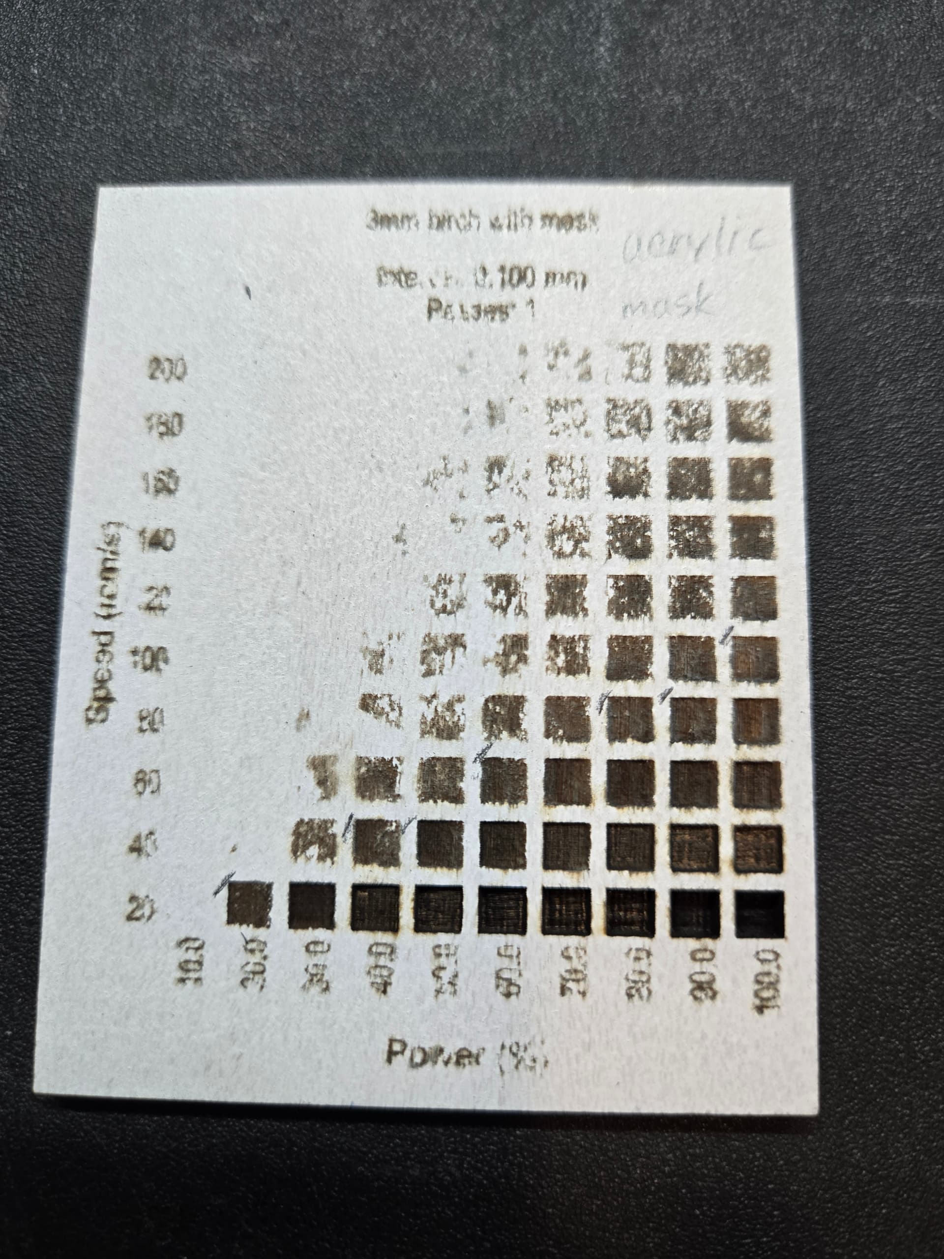

Here are the material tests that I performed. I wrote on each one what was used. Unfortunately, I got the wrong 3m tape, because the white will be the top layer of my project. I will probably have to scrape the adhesive off, if I use it ![]()
It appears to me that the best option for setting would be 80 speed/ 100% power, according to my tests, but maybe I’m reading it wrong.
Again - you are getting the material TOO HOT. Turn down power, or turn up speed and increase the number of passes. Tape should not melt into the wood or leave behind residue.

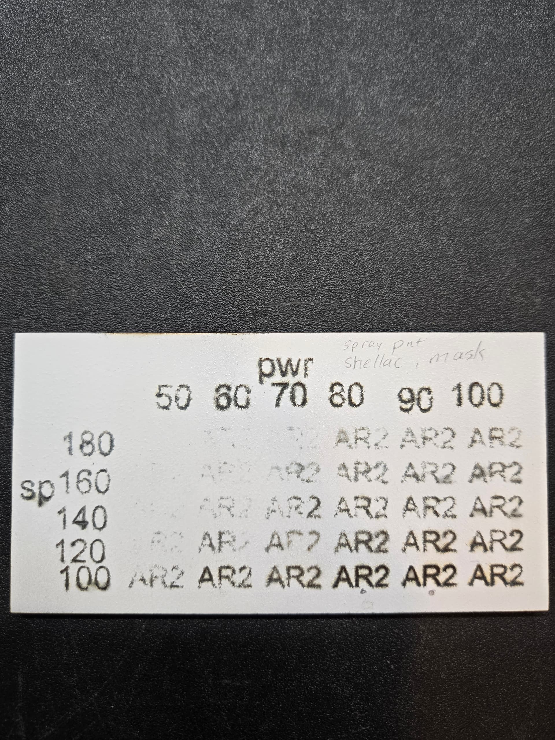

I have conducted further material tests, as demonstrated by the pics. Most of which are still showing no satisfactory results in my opinion. The original test on plain wood, shows very satisfactory results, as well as when I use a different color paint, however it’s the white that seems to be the common issue. I spray painted white on one and then rolled white acrylic paint on others. I wonder if it’s the application of the paint that is the issue. I will use a brush to apply the paint for more consistency and see if that works. If that doesn’t work, I am completely out of ideas and getting frustrated because I have a craft fair next week and may have to redesign a few products.
The additional layer of paint means that there needs to be additional energy applied to the wood. More to burn through = more energy needed.
Too much energy applied = soot and burn
Easy answer … Settings that make the laser go over the same spot more than one time. Burn a little many times vs. burn a lot at once.

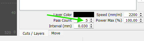

You still have not responded to the ADD MORE PASSES advice, that I have stated every time I post. Do you not understand the idea? When a single heavy pass with a razor blade (laser beam) does not cut deep enough…do it again and again until it does.

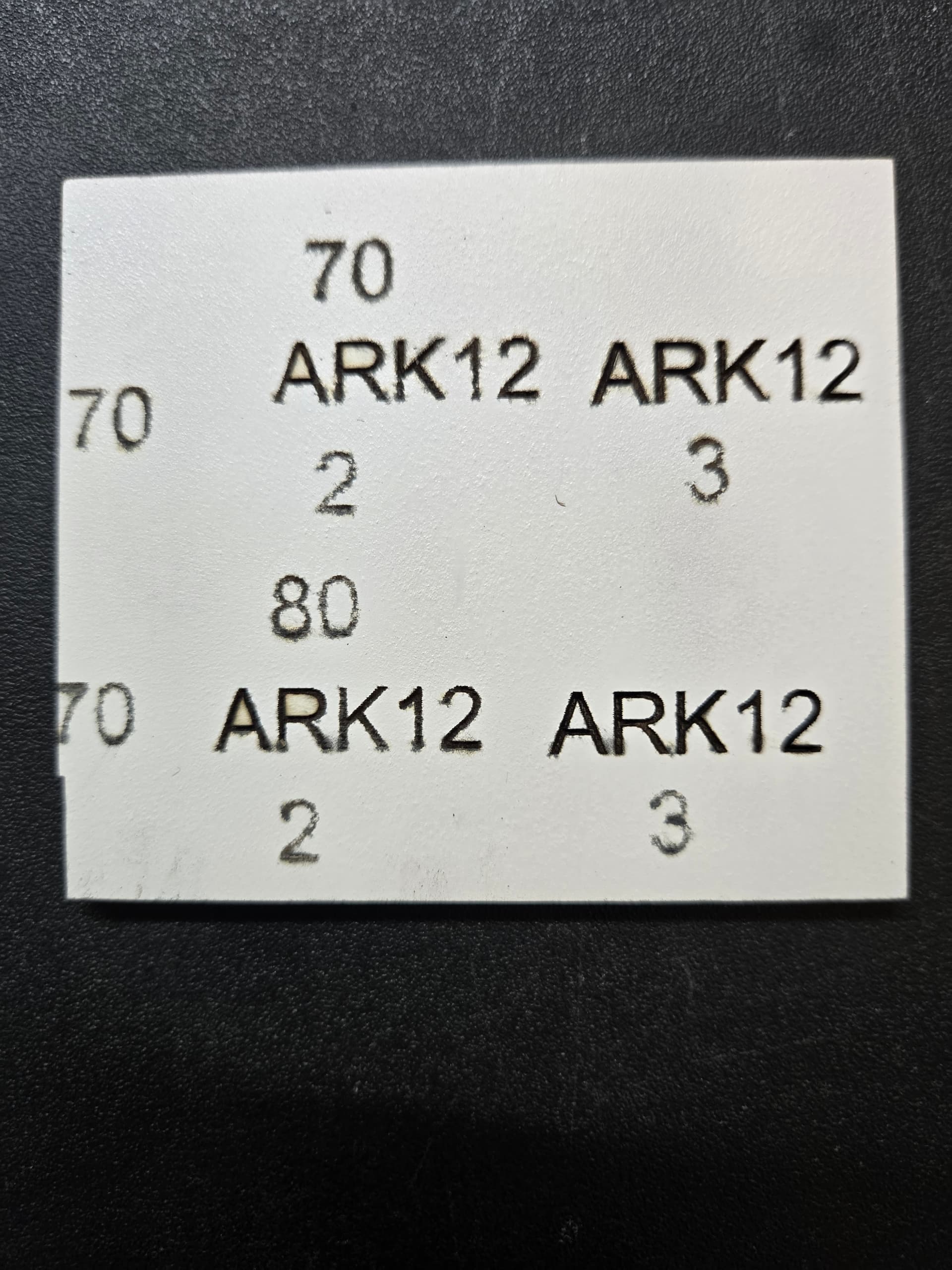

Yes, I understand about the passes. I am currently doing a material test with 2 passes. I was hoping to avoid multiple passes, since this greatly increases the time it takes for a project. When I get those results, I’ll try to do another one with varying passes. I appreciate your patience.

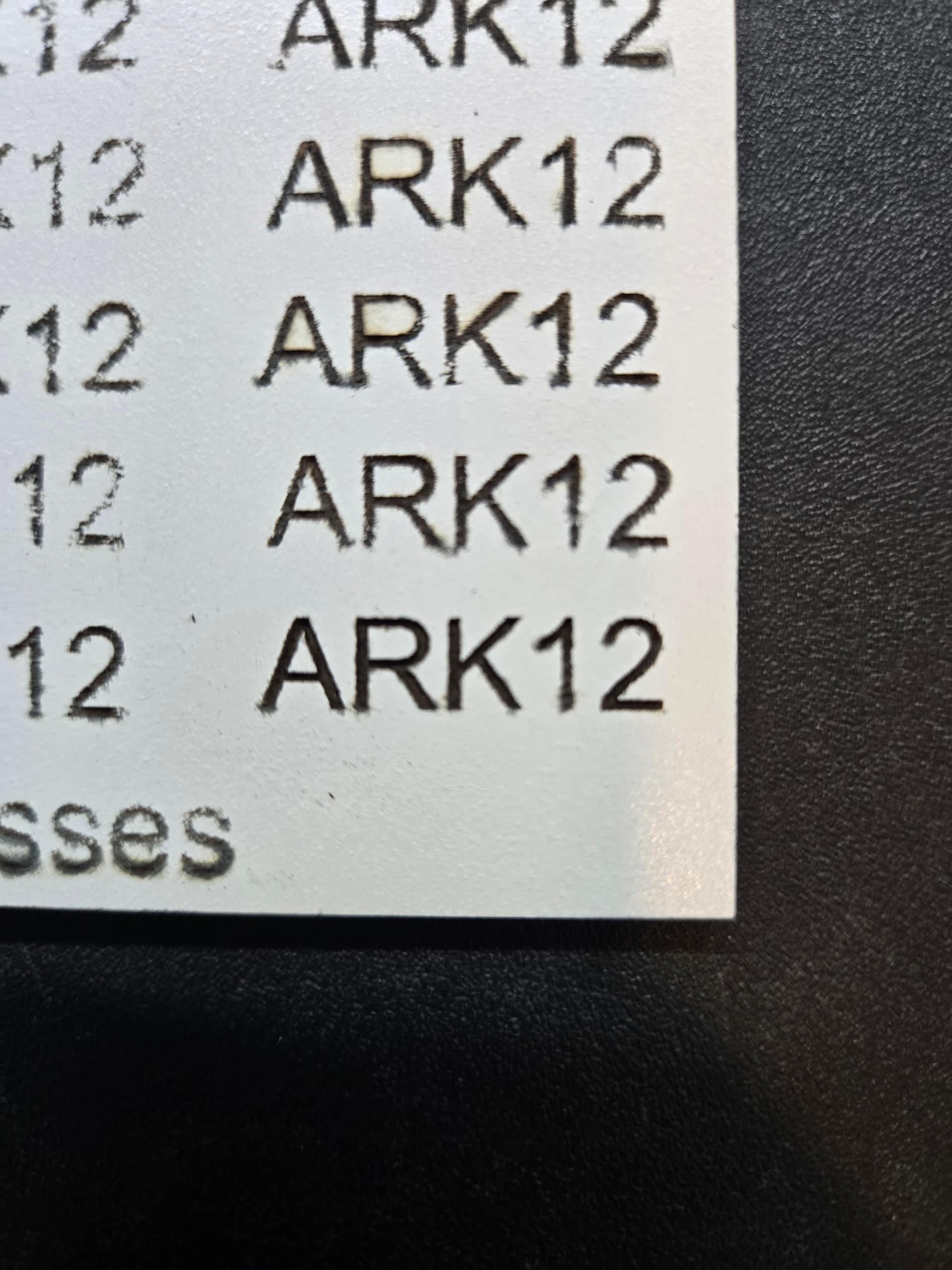

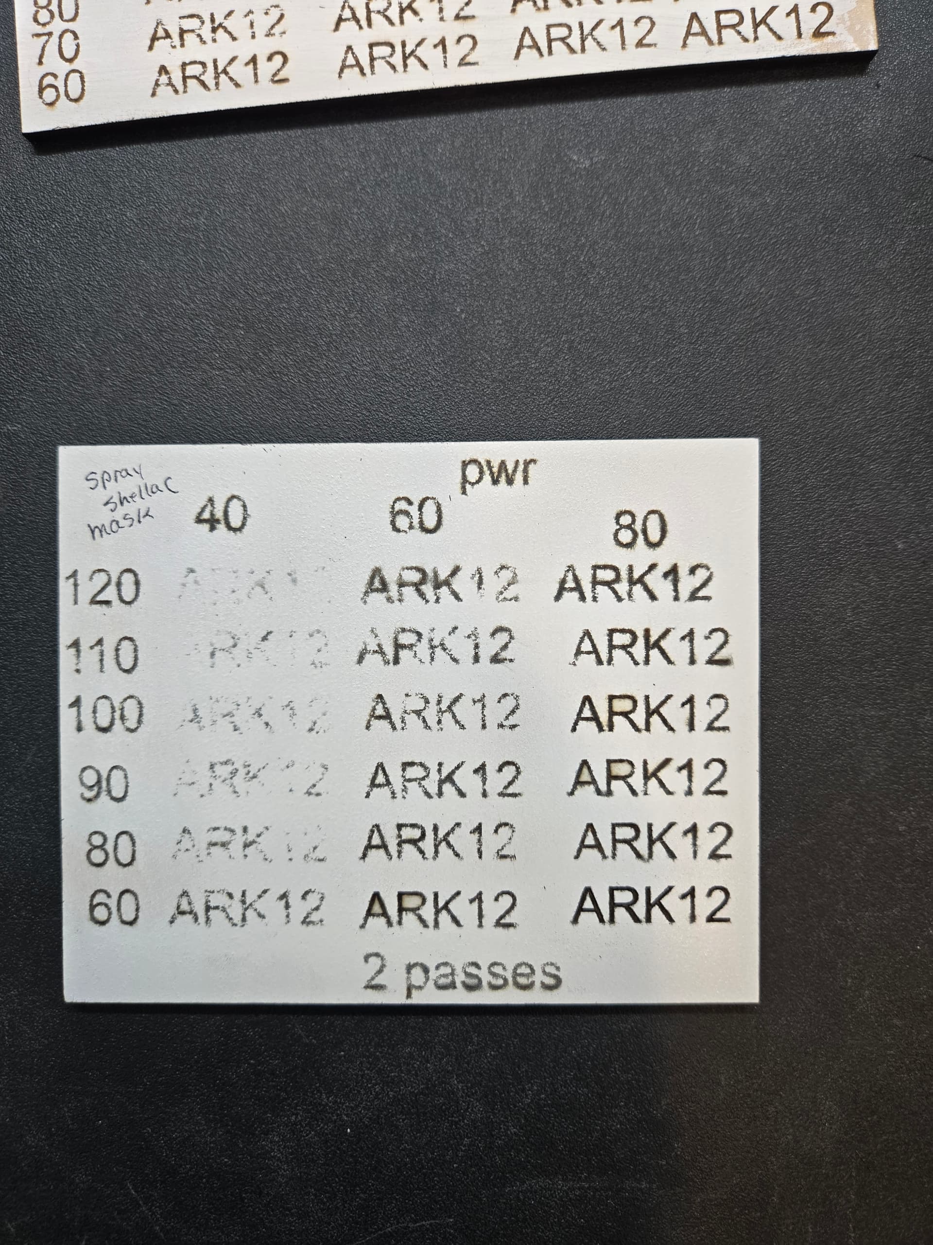

Thank you for explaining in depth about the passes. I guess it would take about the same amount of time to speed up and reduce power to get the same results with less soot. That part I didn’t quite understand. This is my material testing with 2 passes. Based on this, what do you recommend? You can see from the close up pic that it still bleeds slightly, and isn’t a crisp engrave. Is there an easier way in Lightburn to do a custom material test, other than just assigning them to different layers, which is what I was doing. I am willing to do more tests, but this is taking a while.
The bottom right shows char in the corners of the ARK12. Drop power 10%, speed same, add one pass and compare. Are you using FILL or OFFSET FILL?
FWIW when testing new material, I don’t run a whole LB test. I pick a setting number that I think is close, and I test on a small square. I make adjustments and test again. I don’t bother with the whole Smorgasburg test. I am comfortable with my laser. On my earing designs, some wood takes 8 passes at 100%/1000mm-min and other pieces take 14 passes at 100%/1000.

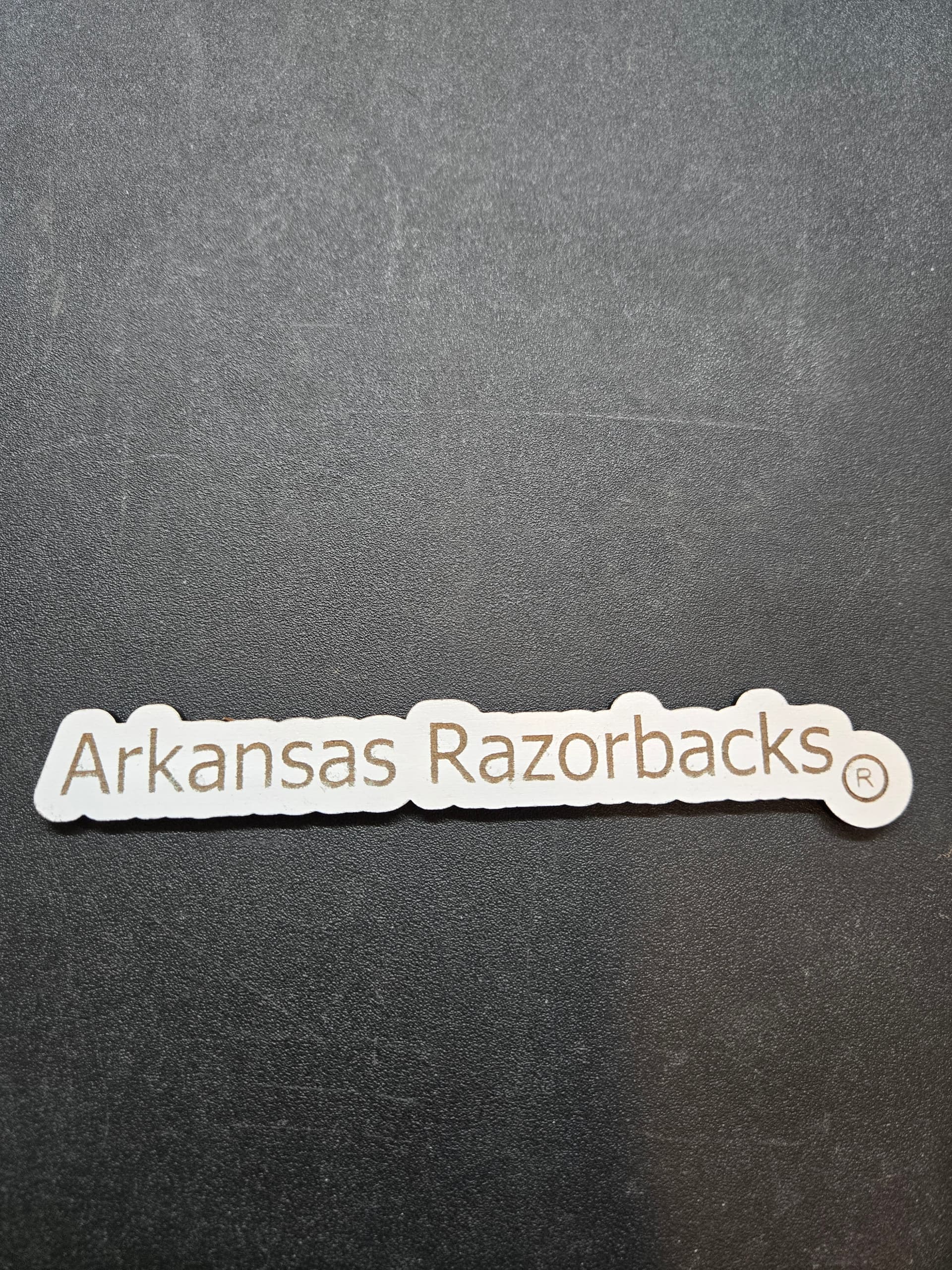

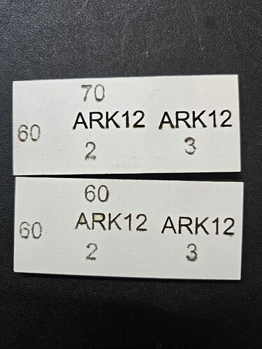

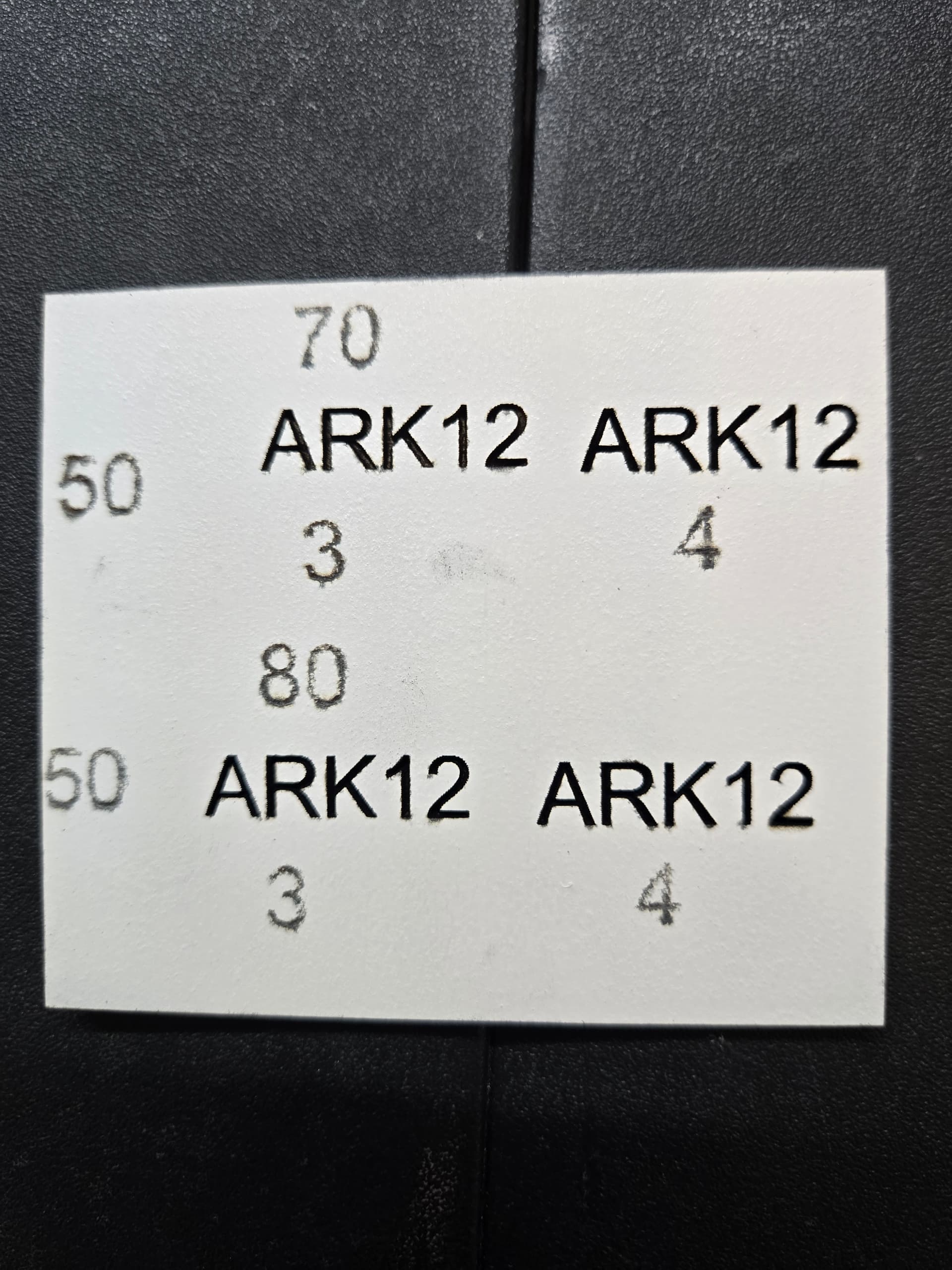

I’m using 3mm birch plywood, spray painted with white and shellac and then masked. Here’s my latest test runs. The 2, 3, and 4 are the number of passes. It’s getting frustrating. Still not quite what I want - closer, but still scorching. I like the darkness of power 50, but not scorching
I’ll try the black tempura paint, but only because I used shellac first, otherwise, I don’t think I could get it off. I used that when I was etching bottles. At this point, I’ll try anything! Thanks for the ideas!
Pull your focus back a few mm. That can help get a dark mark with less scorch.
I would also absolutely try a different paint. Shellac is a very tough surface.
