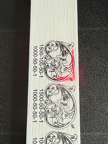

I’m testing some settings and the top of the design is in the frame or slightly outside.
Is there a way to fix this? I’ll be engraving on small areas and need to be sure where it will go.
Thank you.
Max 50W Fiber w/110 lens
Sounds like you need to adjust the red dot offset in the device settings. Check out the video below.
I’ll check it out, thanks.
That did it. Thanks, again.
