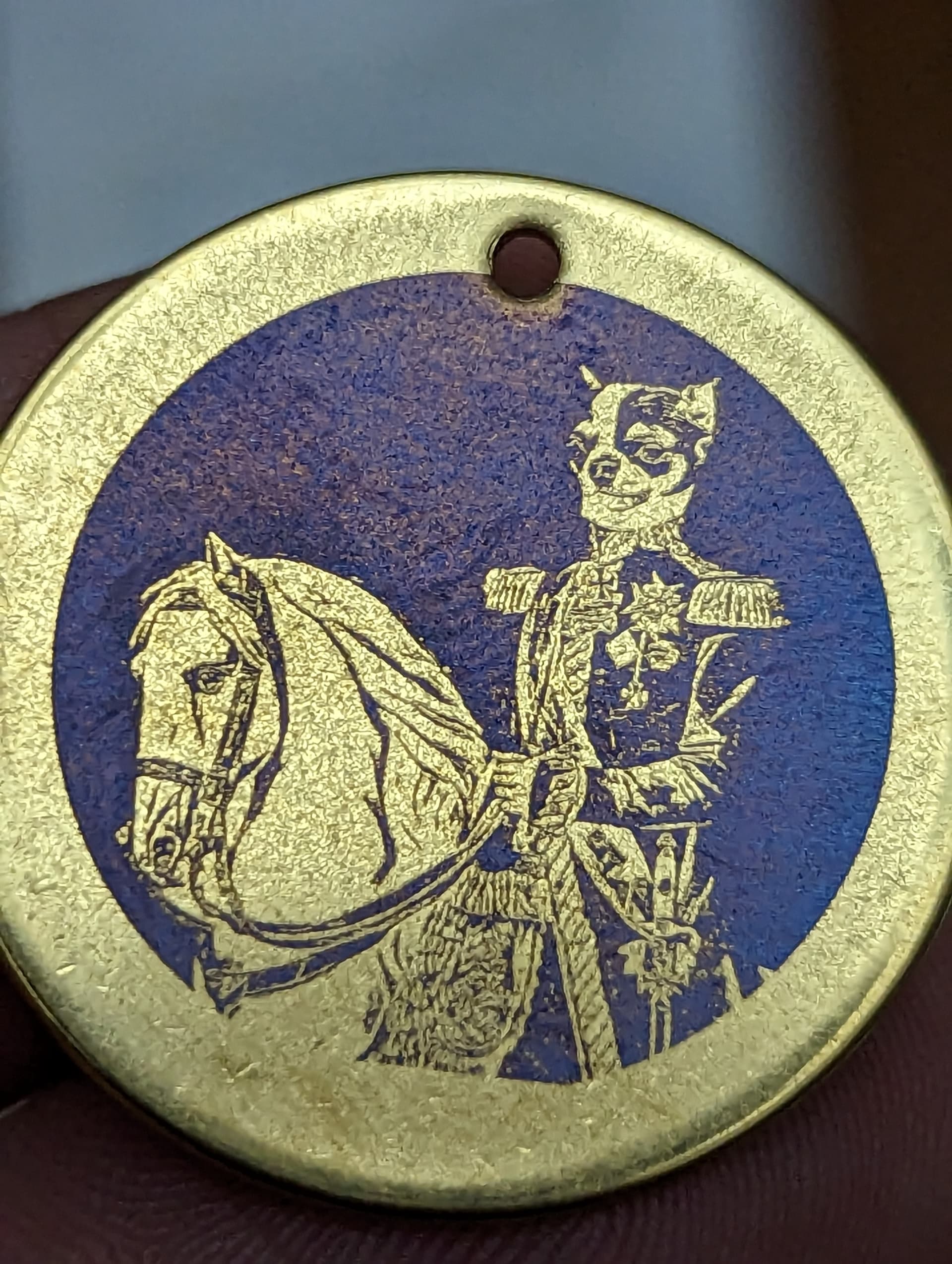

Hi all I am trying to engrave photos using my new galvo and lightburn. Before uploading to lightburn I use Image R and resize to about 300 dpi and set it to be engraving aluminum which seems to be the only near option to stainless steel. The result are okay but I am wondering how I get rid of the background to the image and if anyone had some master tips :slight_smile:

Someone may have a better suggestion, but here is the method i use for images on tumblers:
So to remove the background; Use trace image to get the shape that you want omitted. (You’ll have to adjust the threshold and maybe do more than one trace) ungroup your results and delete any lines that you dont need. Send your new shape to a tool layer, and then you can cut or mask to remove that shape from your image. If you still want that area shaded instead of bare material, duplicate the shape you used for the tool and set your desired fill.
Louisiana Hobby Guy has some good tips on cut and mask in LB. Hope this helps!
