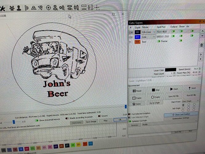

A bit more help please.
When I do a preview in Lightburn it says it will take 2.29 with the speed on 300, if I change the speed to 3000 and do another preview it still says 2.29. If I send the file to my laser it takes 4.30. What am I doing wrong.

Please attach a screenshot of Preview showing this and your cut settings.
I hope this is what you want.

If you check the time on the “Cut distance” time you can see that the time is in fact changing. I can’t tell from the picture but I’m assuming the portion of the burn set for layer 01 is fairly short.
Try changing the speed of layer 00 and see how that affects the overall time.
I have changed both speeds up to 5000 each but the time has only changed from 2.29 total and from 1.59 to 1.58 on the cut distance. does that sound right. Sorry I’m new to all of this
I can’t see your screen but the calculation is likely correct. However, the process by which that calculation is created may not always be apparent and results can vary based on complexity of the design.
In this case the speed values are so high and the overall burn time so low that you’re probably working at the extremes of the simulated values.
If you’re curious how more of this works take a look at the Additional Settings in Device Settings. Those are the values used when calculating the estimated times. They can be read from the device. If the device numbers are accurate to your actual machine performance then the estimates will be better. These numbers can be tweaked to further refine the estimate if that’s important for your workflow.
Can your machine run 5,000mm/s? You have to be reasonable about this stuff.
You machine has internal ‘speed limits’ set in the controller. For X, Y (and the others). Anytime you ‘ask’ the machine to run faster, it will ignore your request and run at the Max speed set in the controller.
I have a lightweight head, so I can run up to 1650mm/s. That is set in my controller.
Notice the Y axis is set at 500mm/s for it’s max speed.
These are always enforced and are there for the protection of the machine.
Lightburn uses values you can see in ‘Edit → Device Settings → Additional Settings’ to determine the ‘preview’ speed. You may need to ‘read’ from the controller.
