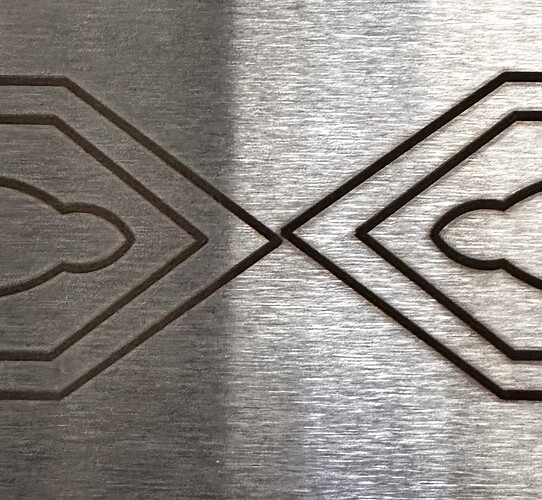

Hi
i am trying to engrave a repetitive pattern over a long SS sheet. 3 mt x 0,10 mt .
the problem is there is a slight gap between each pattern when i slide the sheet manuslly. is there any adjustment that i have to do. I am running lightburn.150 mm lens.
You could use both array tool with 0 x axis spacing and the print and cut tool. If the registration mark
s are a problem mount material on backer board and put registration marks on that.
It’s not square… are you using some kind of jig?
