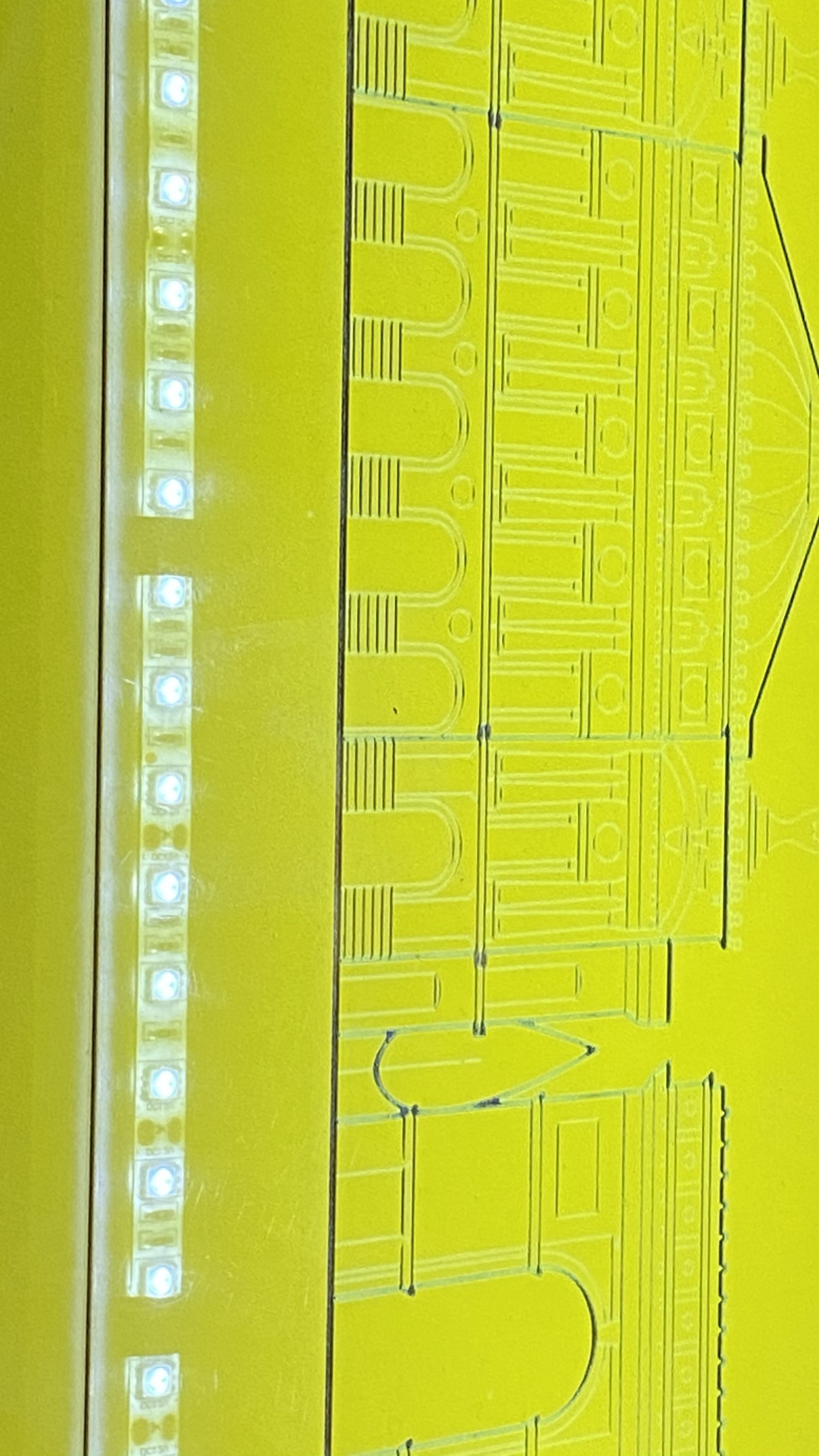

I am reverse engraving a Paris abstract line piece on reversed laminate (flipped image).
the fine details (0.5mm to 1mm thick) appear to be missed or hardly touched when its scanning across.
Machine oculus 1390
Tube 130w
(test sample on the word “test”)
power 13% speed 275. 2 passes. all clean.
“fill all shapes at one”
220mm x 550mm wide
i’ve since spent most of the day trying to get a detailed engrave.
I am now running 100 speed 11.8 power “Fill shapes individually” + flood fill. Much longer but it appears to be picking out the detail. but not sure if this is teh right approach…
help - and any tips welcome please
