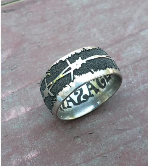

I know that diamond engraving tends to be used for engraved jewelry.
I have a 30W MOPA fiber laser and would like to engrave something like this.

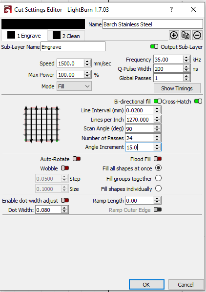

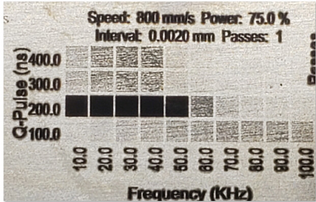

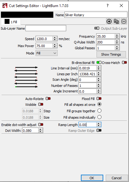

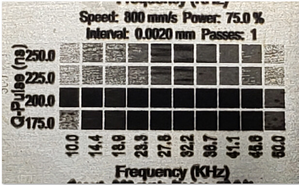

Im not near my laser right now but my setting would be around 42KHz and qpulse 200, speed would be 1000+/-?
Ill check back in tonight when I can be more specific.
Take a look at lasertips.org for some good quick parameters.

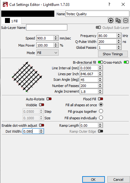

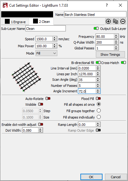

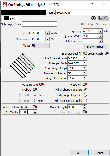

Lots of rotated passes. Angle increment
Play with these, adjust power and passes to suit. I really find lots of passes using angle increment produces best results. Like 10 passes @ 36 deg, 20 @18, 200@1.8, etc.
I ran this lots of rotations to get the depth.

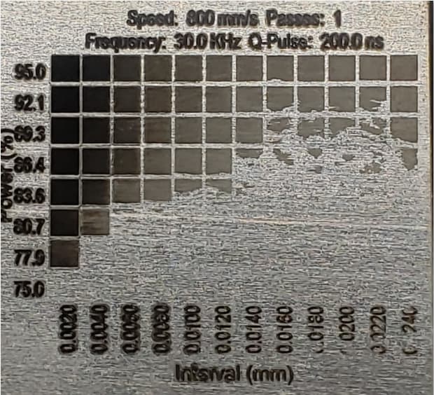

Silver Material tests.
