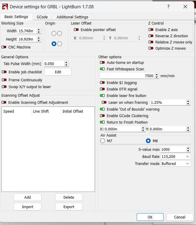

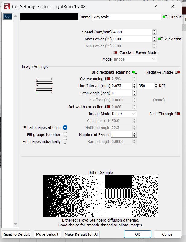

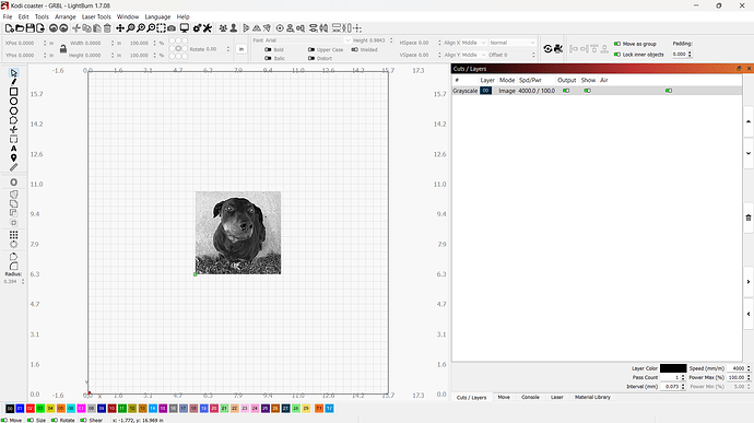

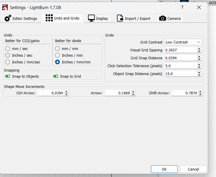

Post a screenshot (not a cell phone pic) of your entire Lightburn screen with your project loaded and the Cuts/Layers Panel and Laser Panel visible. Also post a screenshot of the Settings Window (Gears icon) with the Units and Grids tab visible and post a screenshot of the Device Settings Window (Wrench and Screwdriver icon).
Tim: I do appreciate your response. I have owned this unit for a few years and bought new from Ortur in 2022. Went through a divorce and had it put away for a while. With this said i have not tried a bunch of different projects as the projects I mainly was interested in I have not had success in. I cannot confirm it stops in the same place but It usually fails about 10-13 minutes into each project. Lightburn still says its running but the laser just stops like you pulled the power but the power is still on. I can hit stop and rehome and reset to origin accurately. Since I never know if it will stop I have a hard time getting video. I made multiple 3 passes on a project this am with zero issues but the 4th and 5th pass failed randomly.

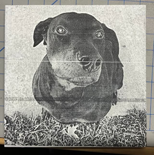

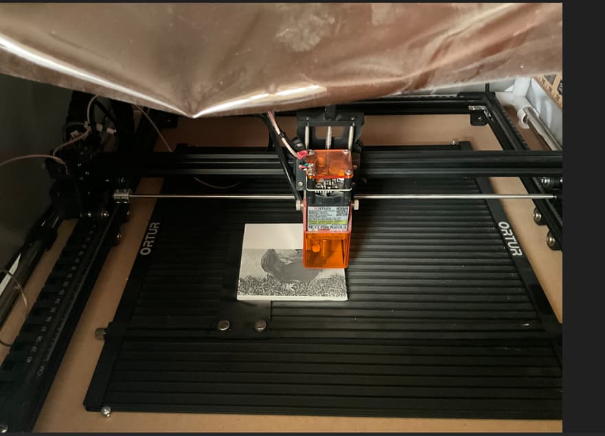

The above picture was a 30 minute burn and you can see the two spots it failed and I tried to recover. Again console is not throwing any errors and it is acting like it is still running but the laser is not moving the diode stops emitting and the cooling fan runs a few seconds and stops. I hit stop in the lightburn console, rehome and reset to origin and then can hit start and it will start again from the bottom or I can go through the preview pane and try to restart where it failed.

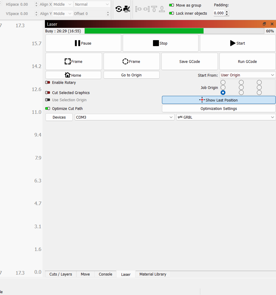

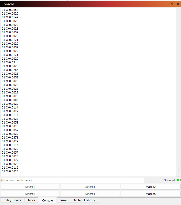

Nothing jumping out at me there. Leave show all enabled in the console and next time it fails copy and paste the last 10 lines shown.

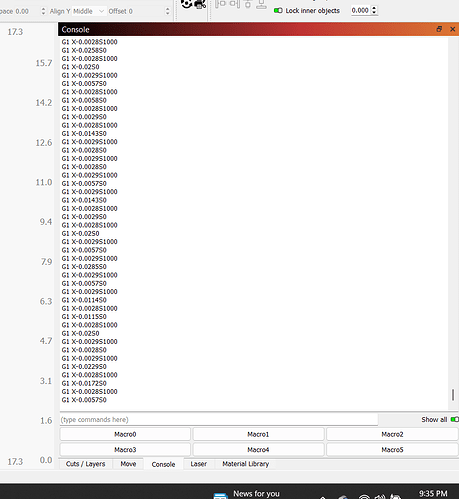

5 minutes after it stopped console said it was still busy but no change in commands sent.
It stops at 25:58

Can you try to run the same job with 0% power? - If this runs through completely it would indicate a weak power supply.

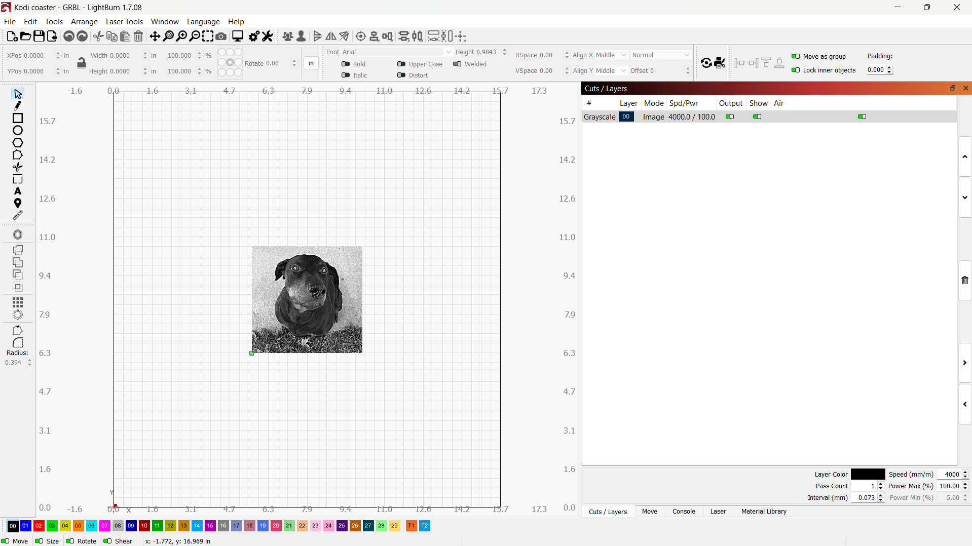

I ran this with zero power over the last failure as suggested and it failed at 22 mins in.
That is a different time, and less time than showing in a previous image.

You said 0% power, but that tile image does not show that. There would be no burned image.
Hi Mike. I appreciate the response. That’s the same tile that I have in my YouTube video. I left it in place to see if it would fail in the same spot. The power was in fact off as you can see by my layer settings. It was set to zero.. I have also Stated previously that I used a temperature gun and check the temperature of the controller board and it did not exceed 88°F. I’ve also tried with a larger desktop fan above the enclosure with the enclosure open and the fan blowing down on it while it’s burning.

That printout of G1 commands above! Is it from the moves just before Reverse move - Laser off - Stop!
I found this:-
If you need to reverse the direction of a specific axis, you can refer to the table in the GRBL Settings Pocket Guide, which correlates the axis forward and reverse combinations to a single digit from 0 to 7.4
“If the code above is the last to go through the controller, this may not apply as as they are all G1”
