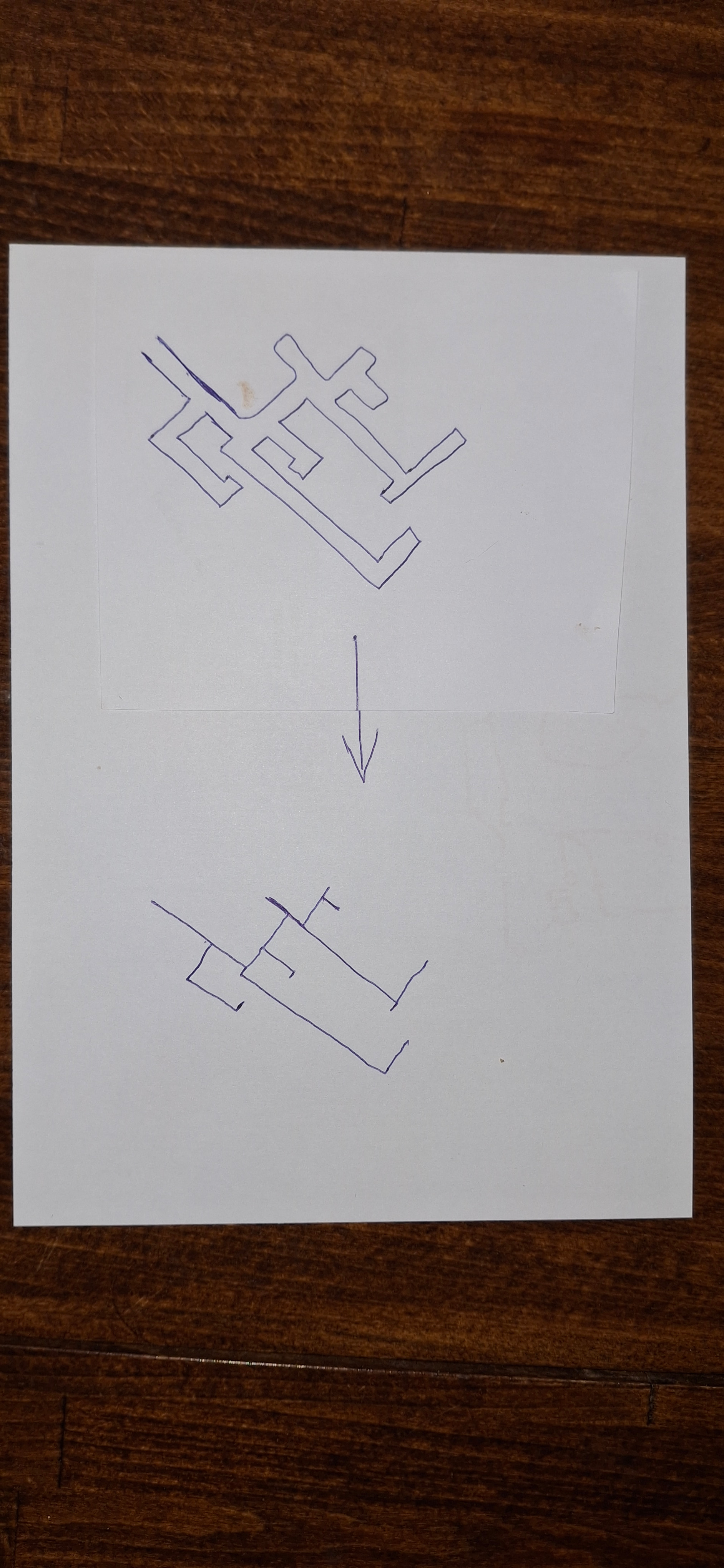

How can I turn the typical street map 9left) to a single line engrave ? (right) Can I do it in Lightburn ? I also have CorelDraw and Inkscape. Thanks

That app will try to create single lines through the middle of any solid pixelated dark colored lines like the ones you have drawn as you can see from the blue output below which is obviously not what you want.
If your street map had a different color or shade in the middle of the street compared to the rest of the map? then I could probably get the app to put lines through the middle of that instead and it might work?

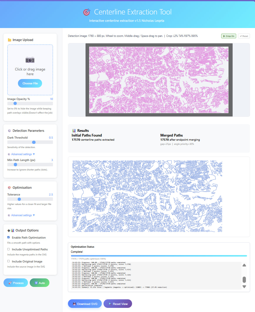

Yes you can use my web app for that, here is the output from your image:
You will probably need to lower the ā€œMin Path Lengthā€ because it’s very detailed:
There is a crop tool at the top now, so you can easily remove the black bars at the edges.
I did notice there are small gaps, when you look at it close up, not sure if that matters or not - I surfaced a lot of the background settings in ā€œAdvanced Settingsā€ so you may be able to get a better result than me.
