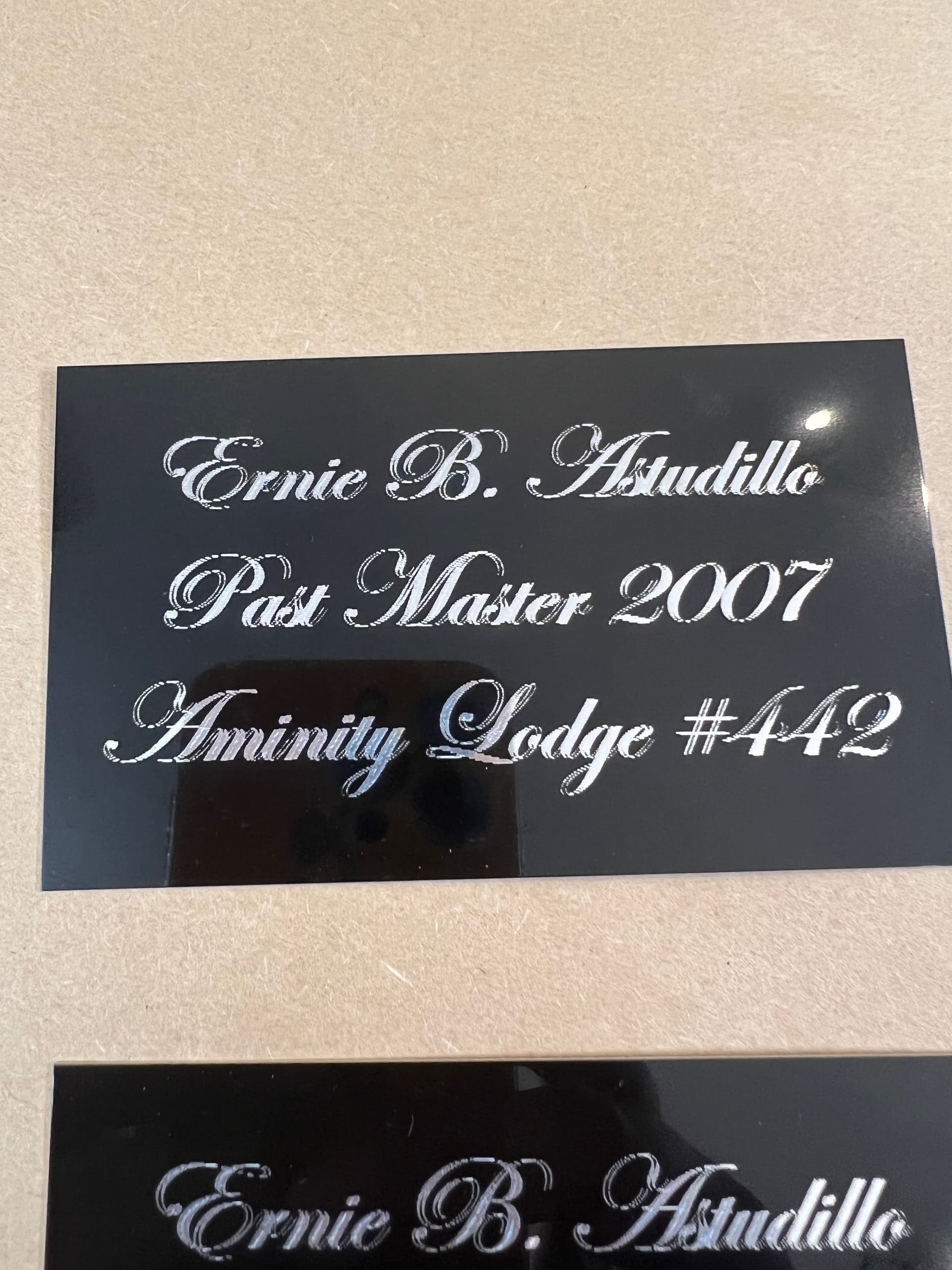

Hi All, I’m pretty new to Laser Engraving and so far whenever I engrave text, I noticed the end result isn’t sharp all around. please see attached and let me know if you have some ideas. My settings are Fill 100 and 20 with 1 pass.
It looks like you need to set a Scanning Offset Adjustment. You can find instructions here:
Thank you very much, I will give this a shot and report back!
