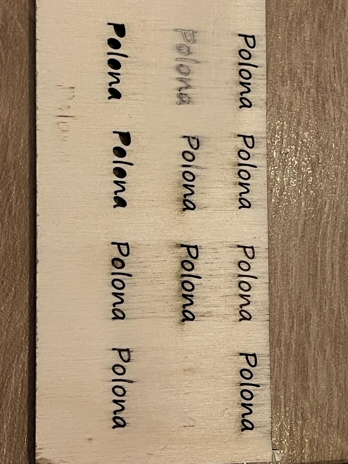

Hi,
I’m new with laser engraving. Can’t find ideal settings for text engraving. I’m attaching photos. I have Sculpfun s10 (10W).
Hi,
You may want to use the Material test generator in Laser Tools->Material Test to go through a systematic variation of settings.
I’d suggest first going through the Laser Tools->Interval Test to identify the best interval setting for that material. Then use the identified interval when doing the Material Test.
This might help as well: Settings guide - Diode Laser Wiki
