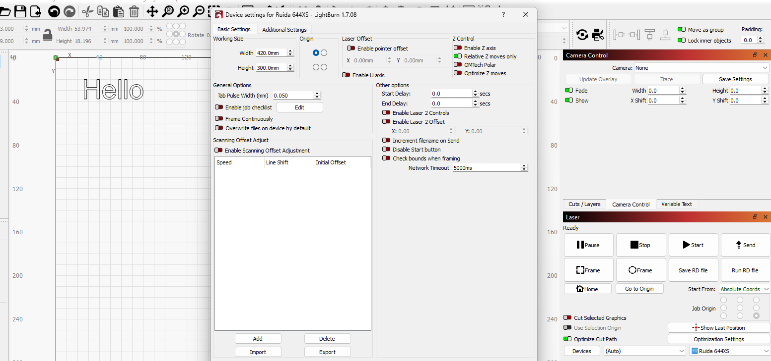

I cant get the laser to engrave text or images the correct way round. I have taken a screenshot of my settings in the hope that someone can help out.

I assume you mean the output is mirrored.
What corner does your machine home to when you turn it on? Most Ruida machines home to the right rear corner. You have the machine origin set to left rear. That would explain mirrored results. The machine origin must match the corner the laser homes to.
The laser hones to the top right at first and then centres after a 5 seconds.
Then change the Origin to top right in device settings.
