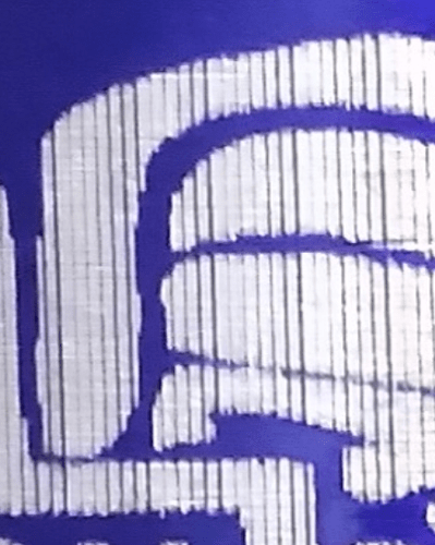

I am using an Ortur Aufero Laser 2 and an Ortur YRR 2.0 Rotary.
I cannot get rid of the fine lines in my final image.
I have tried everything that I could think of and what I could find online.
The rotary has been set up properly and calibrated.
I have tried with rotary enabled and not enabled.
Different speeds, and power. Different mm per inch.
I have even raised the laser up in an effort to make the line less fine.
I have cleaned the lens.
I have tried different graphics, and even just made a solid square in LB, always the same results.
In one attempt it burned fairly clean for about 1/3 of the width, then back to the lines, which didn’t make any sense to me.
I am engraving painted aluminum water bottles, which are very lightweight, so I tried them full of water, same results. Any advise is appreciated. Thanks

When I look at the photo, I see what looks to be each scan line…? Does it look like it’s not a single scan line to you?
I don’t know the size of your lasers beam, so it’s hard to judge…
They are also inconsistent in the thickness… That being said, when it’s a smaller thickness you end up with a more distinct and apparent line, since the coating is still there…
Some of these mugs are just dipped, there is no thickness control on them. That can make things more problematic…
It appears to me the line are a continuation of the blue coating that may have gotten hot …
This is all we have to go on, the effect on the material… What do you think? Do you know the dpi you used when you did this?
A lot of us do this… Usually we do it with the X axes aligned with the Y axes of the cup, as you’re going to set it upright when you use, read it…
This means the X axes are doing most of the work and the Y axes, just slightly moves before each scan… Cross hatch may cause more issues… I don’t think it’s needed…
Interval and DPI are directly related You’ll notice in LB if you change one, the other changes accordingly. If you choose .1mm interval, you’ll get 254 DPI. 1 Inch = 25.4mm. It’s just a conversion that’s done for you in LB.
That said, an interval of .01 is likely far too small of a value for most hobby diode laser. You should be closer to 318 DPI (.08mm interval).
You’ll need to set your interval to a value that matches what your laser can produce. If you don’t you’ll end up with errant gaps like you see here.

I changed the DPI to 254 in PhotoShop and then engraved with the settings shown
the results are better but still has the lines. As good as it gets with my machine?
I tried different dpi settings for .08 and .09 as well, but the 254 at .10 was the best I could get.
I am using a png image, I tried trace and fill, as well as image modes, pretty much the same results either way.
You’ve made good progress. The lines are consistently spaced and much better than what you shared in the first photo.
Might be. Remember there are physical/mechanical limitations with any machine. The size of the laser beam, the stepper motors. They all come into play.
You’ve clearly done a fair amount of testing. I’d say your interval/DPI is spot on. If I’m understanding your post, lower values do not improve the image. Higher values will put the lines farther apart. Think about running the interval test built into Lightburn. That will help you get to your correct value for each material you intend to engrave.

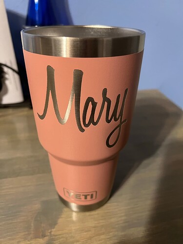

For the CO2, I found it definitely comes out less clean with high power. I did the below cups @ 70% power @ 500mm/s on a CO2 80W… You can see the lines clearly that you’re talking about.
The sweet spot was the cup I linked above.
I just remove the powder coating without marking the metal with those settings.
That’s expected since you said you have a 20w. :slight_smile: 70% of 20W = 14W, where mine is 80W. I run it at 25%, coming to 20W.
