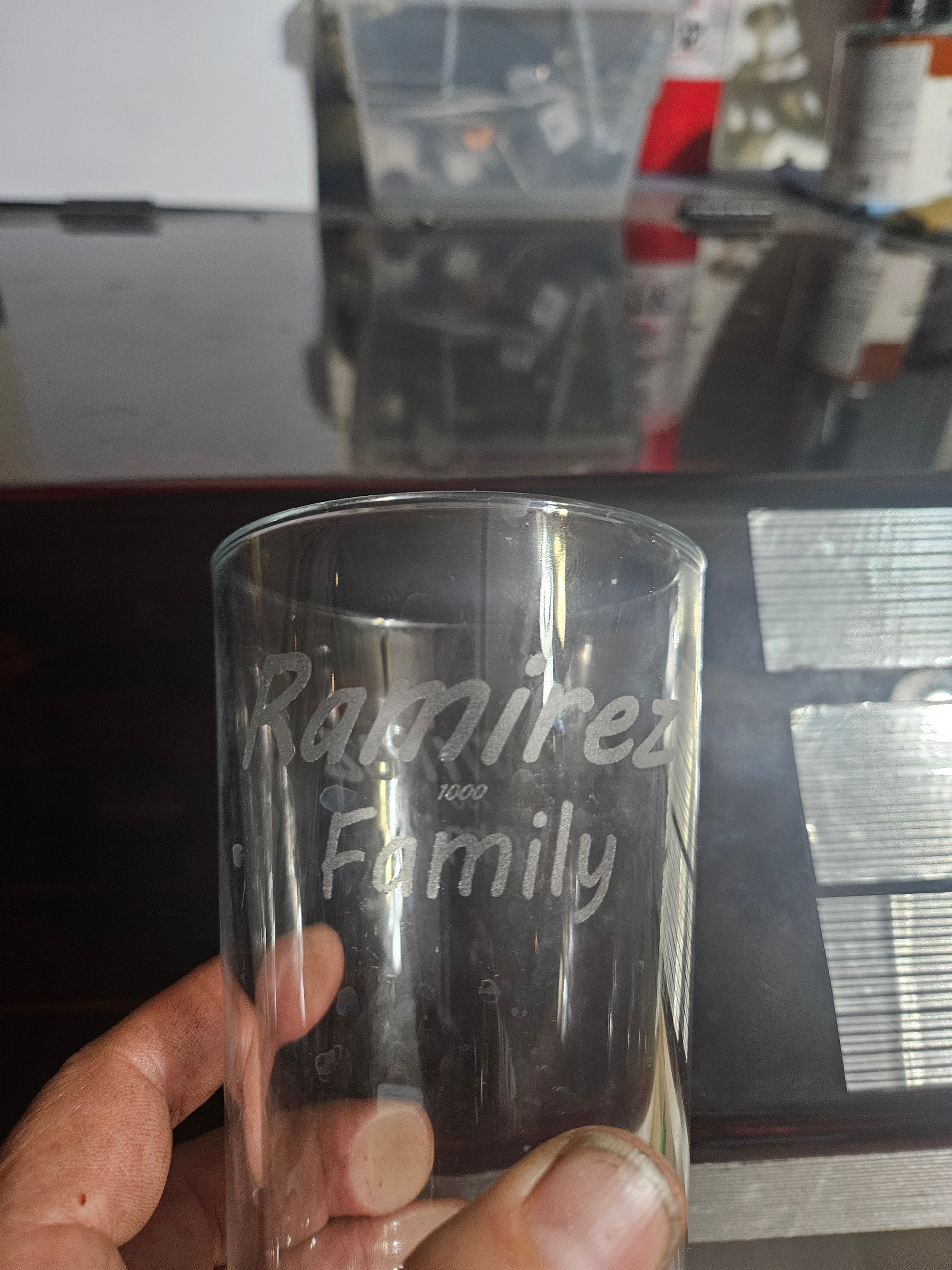

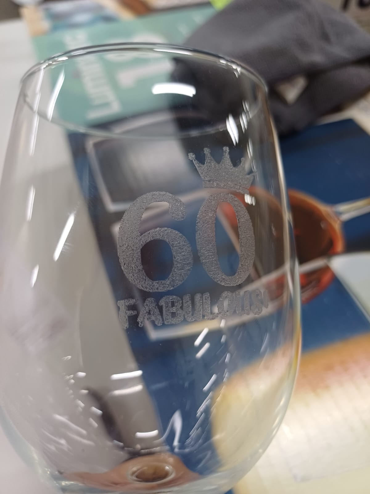

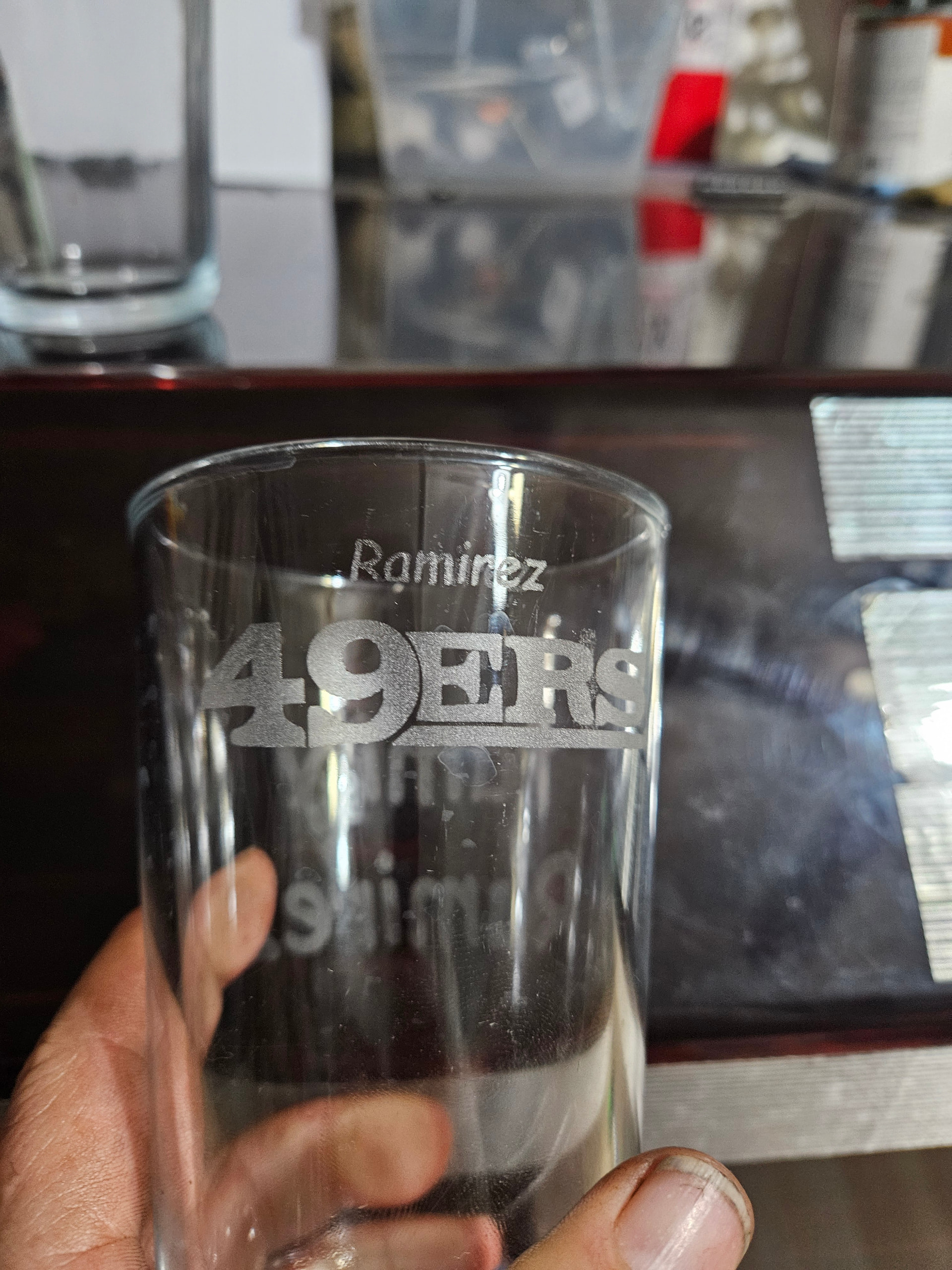

Laser engraving on glass
These are the results I’m getting

That looks pretty good to me. You are not satisfied?

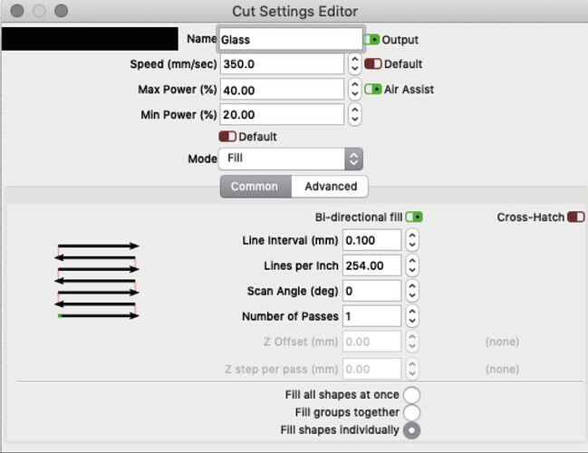

what works for me is i convert it to bitmap 500 dpi then use newsprint with 700 dpi. the speed and power you have to play with it i have a 80 watt co2 speed 400mm and power 15% . since the dpi is high the low power creates micro dots one on top each other. the key is low power just enough. you can play with the dpi , this glass with newsprint 1000dpi. but 500 to 1000dpi dont make to much deferent
