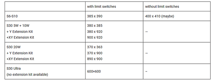

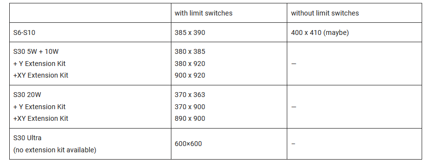

You need to know your exact laser workspace, and you need to measure it specifically for your device. There is always some millimeter difference. I guess you set your workspace to 400×400, which is not the case for most models. Here are some “common” workspace sizes of Sculpfun lasers:
So try settings your size to 380×385 if you have an S30 Pro. You can get additional information about this and how to find your size here:

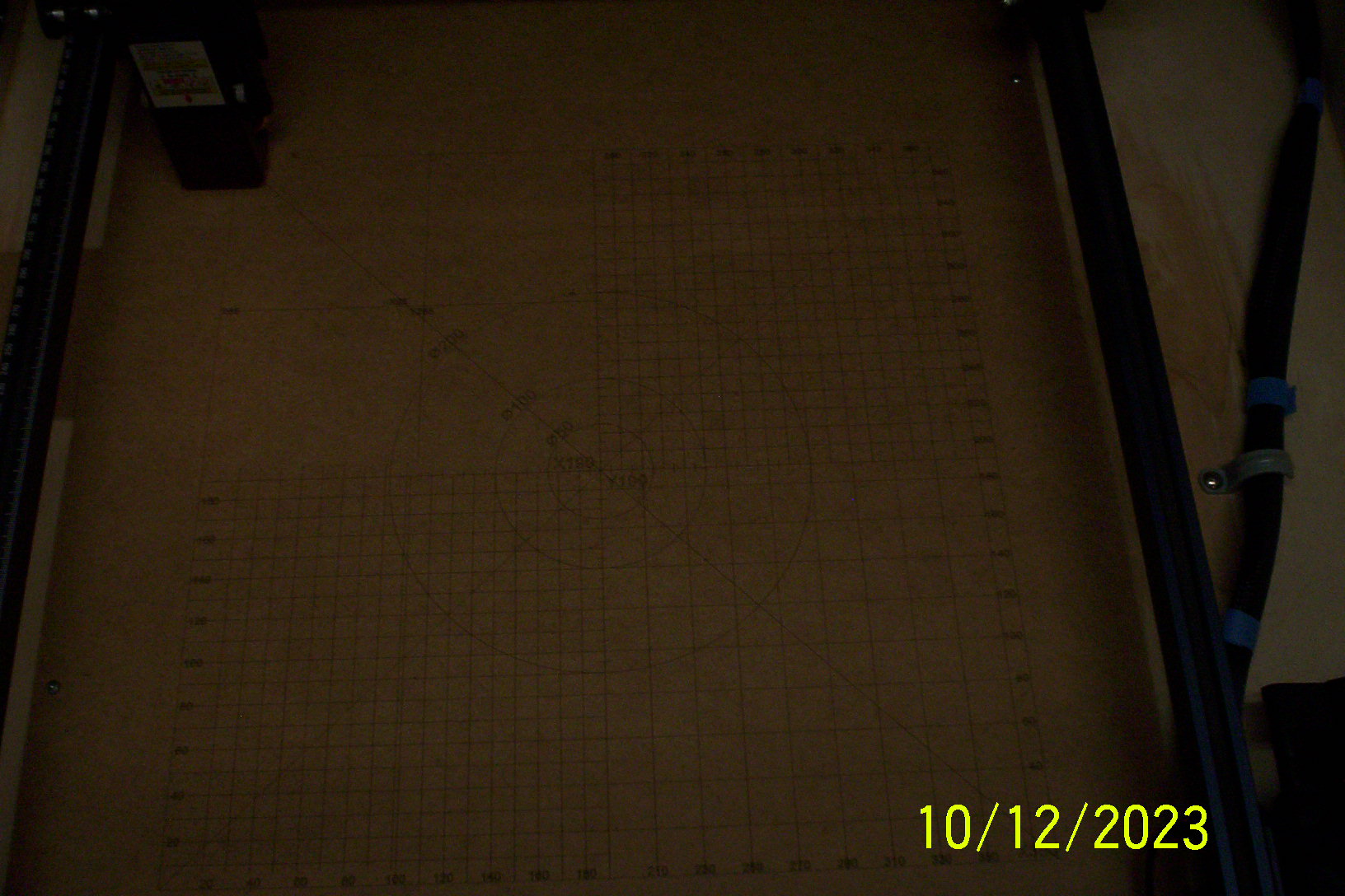

Sculpfun S30 Grid + Extension Grids file by Buster Beagle 3D - seem to work good.
Here’s a picture of the workspace the file burned - hope you can see it
