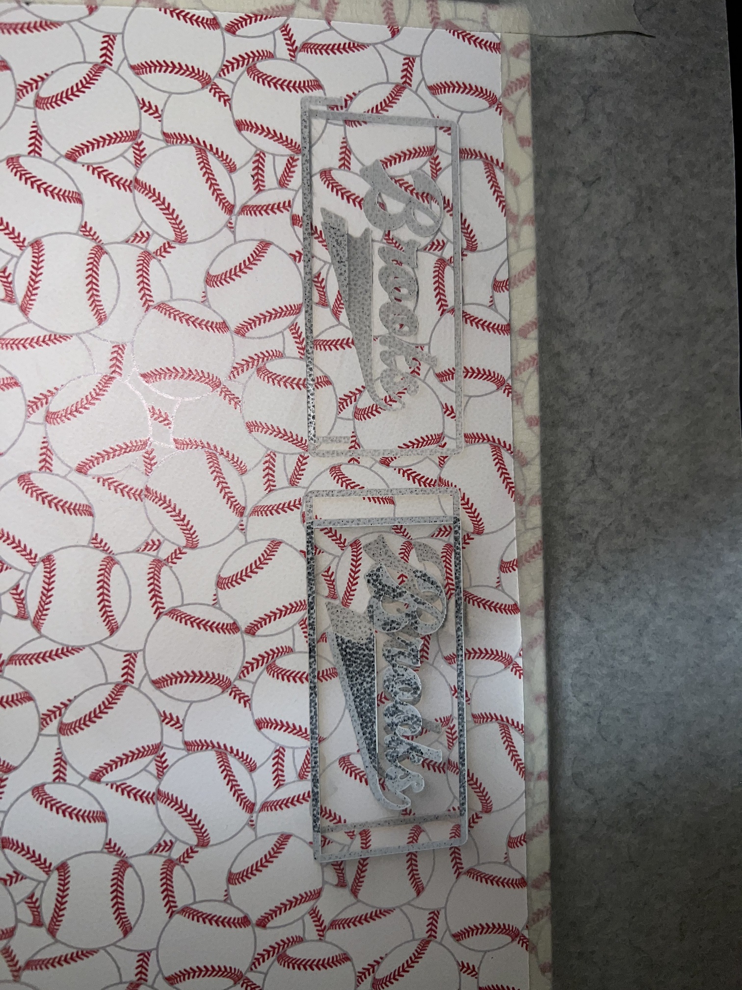

Engravings keep getting off
So I have a XTool D1 Pro gantry and all day iv had cut and engravings getting off. It was top to bottom at first so I adjusted my X axis belts then it happened again so I made sure that the Y was even all the way across and fixed the belt tension again and now this is happening and iv never had this happen, am I running it too fast? I did nothing to the y belt but the tension seems good
I would make sure all set screws on couplers and drive pullies are tight and laser is not loose.
I didn’t realize that the D1 Pro doesn’t go all the way back to the corner when you send it home and I had moved it by hand which put it off
