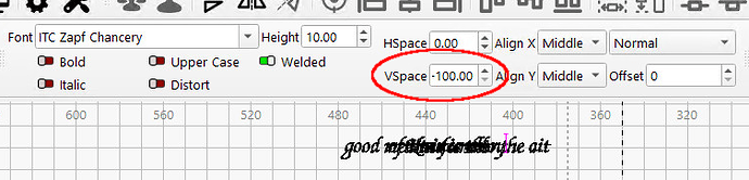

We have been using our ComMarker B4 machine for several months with no problems. Some how a setting was changed and now we cannot “go to the next line” and all the text stacks on top of each other. I have not been able to find the setting to fix this. I assume it is something simple.

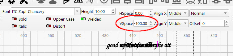

Although this seems unlikely to happen by accident, I managed to overlay successive lines using a totally bogus Vspace value:
That reduces the vertical spacing by 100% of normal, so each line overlays the previous lines.
If that’s not what happened, upload the offending lbrn2 file so we can examing the settings.
