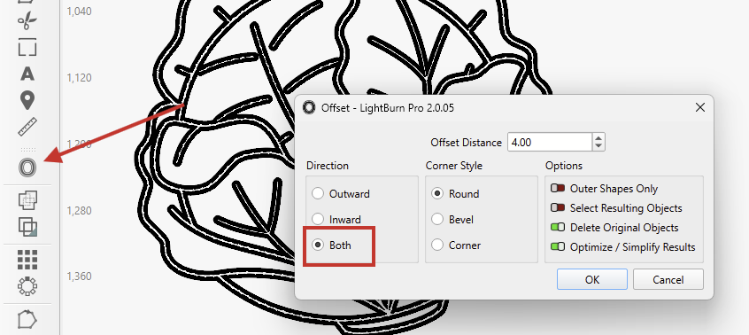

Est ce possible de grossir l’épaisseur des traits d’un logo vectorisé, comme dans Inskape?
Is it possible to increase the thickness of the lines in a vectorized logo, as in Inkscape?
The Offset Shapes Tool should work for that!
Select the shapes and hit Alt + O
Choose “Both” as the Direction option:
Set your layer to use the Fill Mode
You might want to also set the View Style to “Filled” to see the results better.
