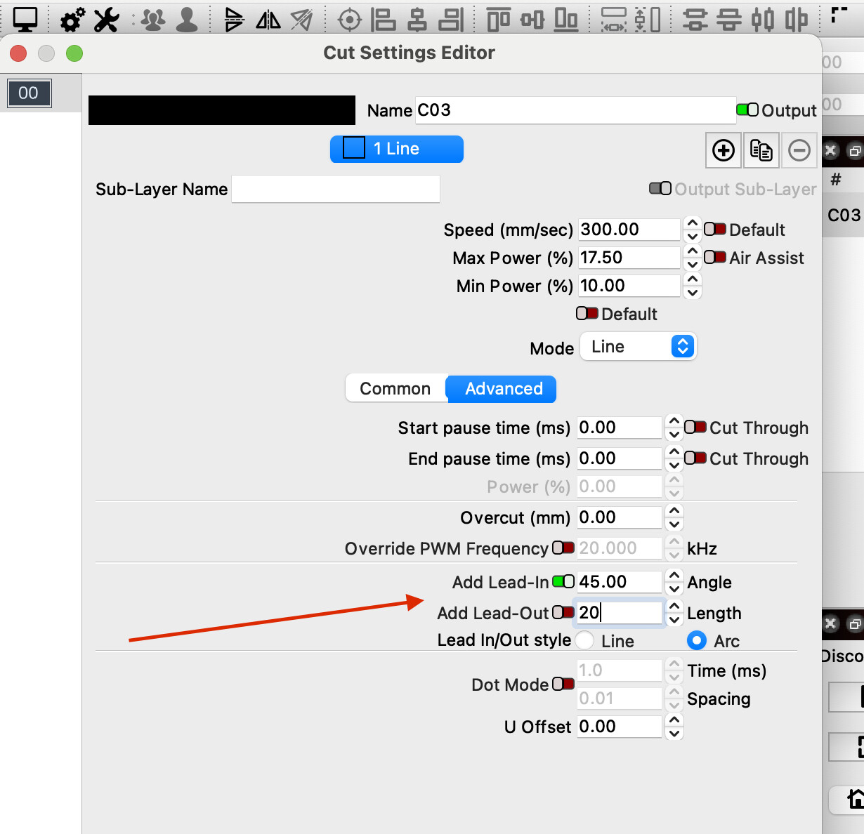

I’ve been working with laser machines for some time, both for metal cutting and marking, and I recently bought a co2 one as a part-time toy.
I’m here for the following I know that it is almost impossible to hide the entry point in a circle of a c02(130w) machine
I wanted to know if it is possible to do it like the cutting machines and start the point in the middle outwards or start from the outside inwards as if it were a metal cutting machine . without having to change the project
Yes, there is the same option as with the “big” machines
thanks for the tip. this should solve the problem. thanks for the quick reply have a nice day :+1:
