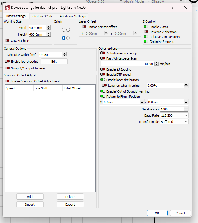

I recently purchased my Ikier 5 days ago while testing i needed to adjust the height of the laser module now it wont autofocus it goes to the top but does not complete the cycle and go down to the material, now when i reset the machine and try to start the setup procedure it does nothing and displays ‘‘machine exceeds maximum range of motion’’ I have tried the suggested settings in LB but when i try to set up the machine i constantly get this error, I never had a problem at all with my Ortur LM2 pro I’m considering sending the Ikier K1 pro 24W back and upgrading my Ortur.

Can you take a couple pictures for us

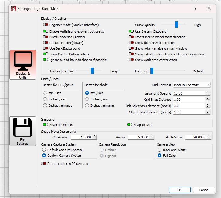

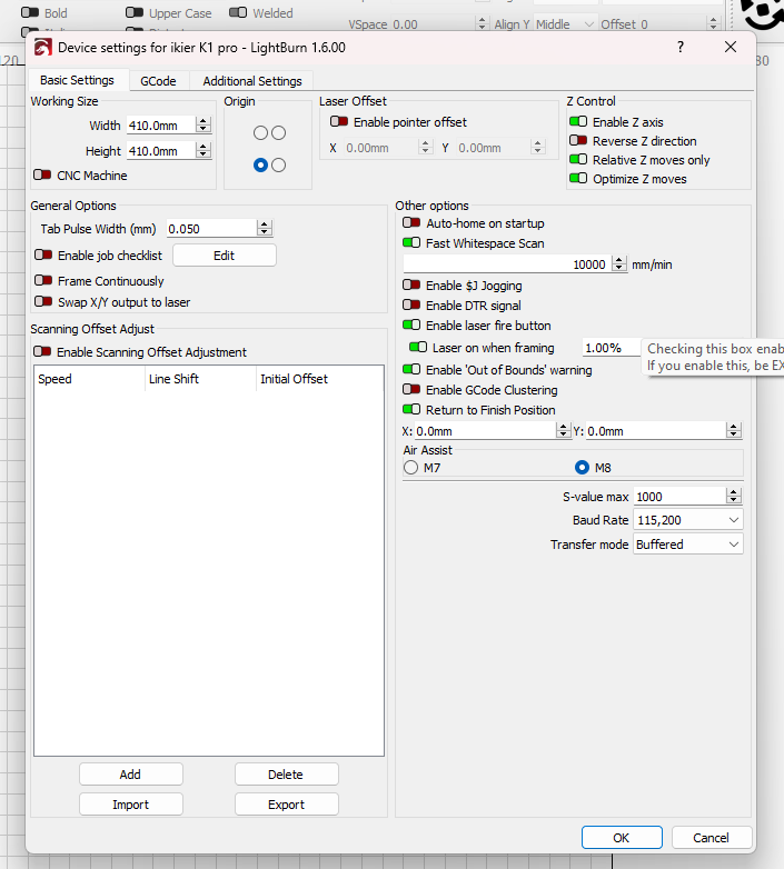

EDIT > Settings
Edit > Device settings.

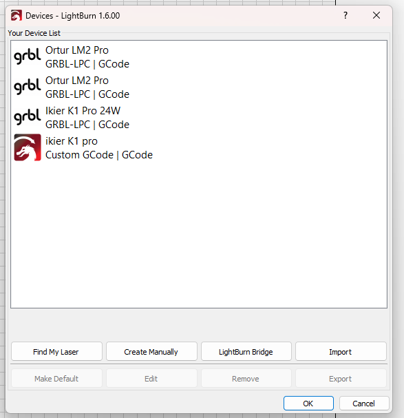

I think you are on GRBL LPC or GRBL M3
Try this please
GRBL Types
Which one you have selected?
Did you use Find My Laser?
mine says custom gcode???
All are GRBL-LPC all are incorrect
They must be TOP Grbl selection
Or they wont work correct
Double click eah profile and change from GRBL - LPC to GRBL and OK

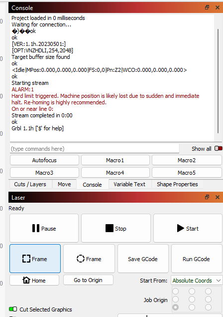

done that but the machine as soon as I ask to start a project it comes up with MC exceeds max range of motion it framed ok i manually focussed and then after start it says this???

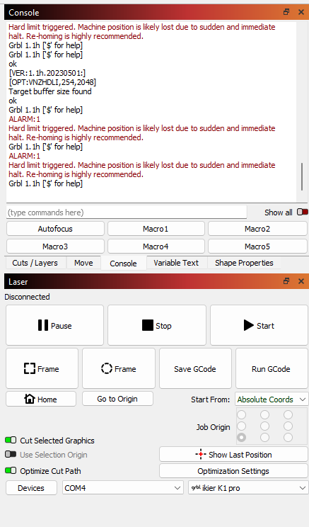

here is the last console reading after homing and focussing
TC
I would triple check the belt tensions, they are not always correct from factory

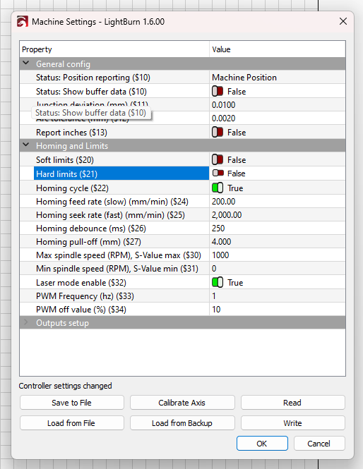

Also you can disable alarm 1 if they give you problems
Help > Machine settings > hard limits toggle off and Write

as soon as I ask it to frame the machine halts with same warning

also I cannot find this setting
TC
Type in console
$21=0
Press enter
here is where it is now
TC
Remember to click write.
Then try engrave again
yippee it now seems to be working all I have now as a problem is for Ikier to sort out why it will not autofocus and they are on holiday for the dragon boat race!!!
