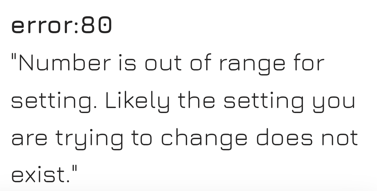

What does error:80 mean? I’m getting it when I try to use $141=600 to set the voltage for my Ortur YRC rotary chuck on my Atomstack A20 20w laser. Can’t find anything about it anywhere online.
It’s not a standard error. Therefore, you need to ask Ortur. I guess the value is out of range. Did you try other values? You usually don’t need to set the voltage anyhow. Steps/mm are the setting to change.

Ahh okay, so that’s an error being thrown by the chuck and not the engraver itself? That is helpful.

You need to find the range as @misken said:
No. The chuck can’t give an error. The laser firmware does.

Okay, that’s what I thought–I need to contact Atomstack instead of Ortur, then–like I said, the engraver is an Atomstack and the chuck is an Ortur. I’ll see what I can find out!
