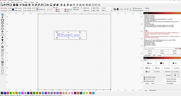

Error 9, alarm 3, 1, 9
ALARM:9
Homing fail. Could not find limit switch within search distance. Defined as 1.5 * max_travel on search and 5 * pulloff on locate phases.
ALARM:3
Reset while in motion. Grbl cannot guarantee position. Lost steps are likely. Re-homing is highly recommended.
Every time we attempt to run our machine now it is throwing these codes. it is not homing framing or moving side to side at all. I have scoured the internet, but we are just not tech savvy, and I’m lost when it comes to troubleshooting in this tech code. we love the laser when we can get it working but its becoming very frustrating to not be able to figure out how to fix issues and use our beloved machine. Honestly it hurts my head trying to figure these things out right now.
I also cannot for the life of me figure out what limit switches are or where they are located on our machine ??
Can someone help a not too nerdy nerd out??

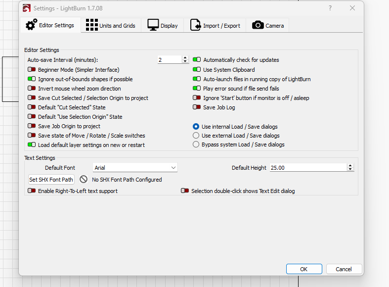

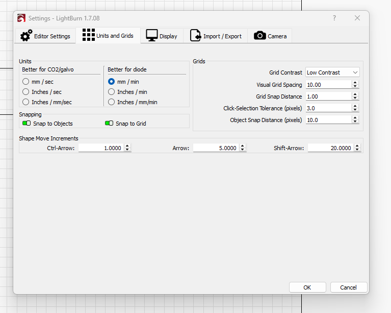

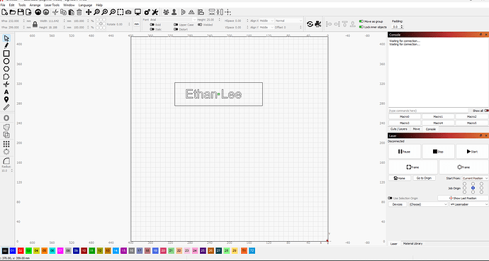

Need some basic info about your setup before going further. Please post a screenshot (not a cell phone pic) of your entire Lightburn screen with your project loaded and the Cuts/Layers Panel and Laser Panel visible. Also post a screenshot of the Settings Window (Gears icon) with the Units and Grids tab visible and post a screenshot of the Device Settings Window (Wrench and Screwdriver icon). In the console window type $$ then press enter key. Copy and paste all the output in the console window in your reply.

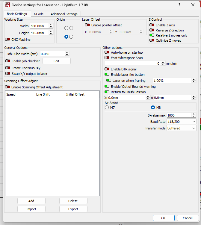

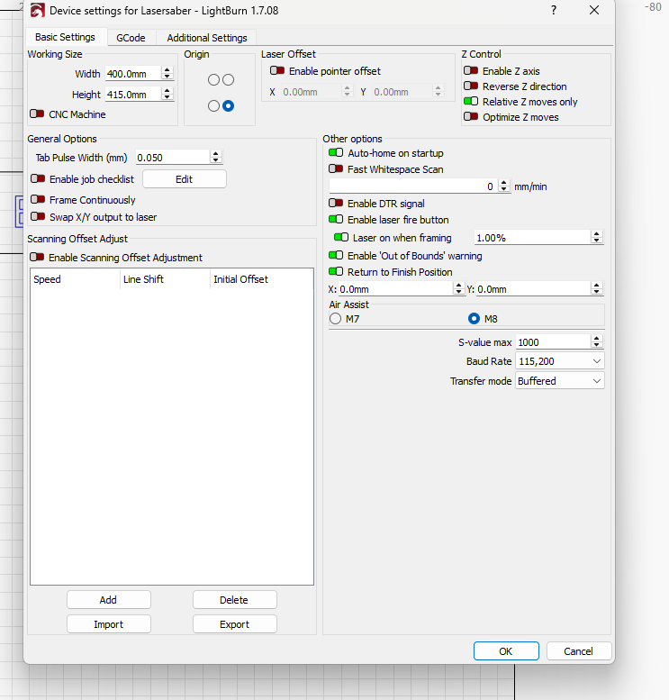

One thing that jumps out t me is you have your machine origin set to front right. That should be front left. That’s where the majority of diode lasers have their origin and I believe you stated that’s the corner it goes to when homing.

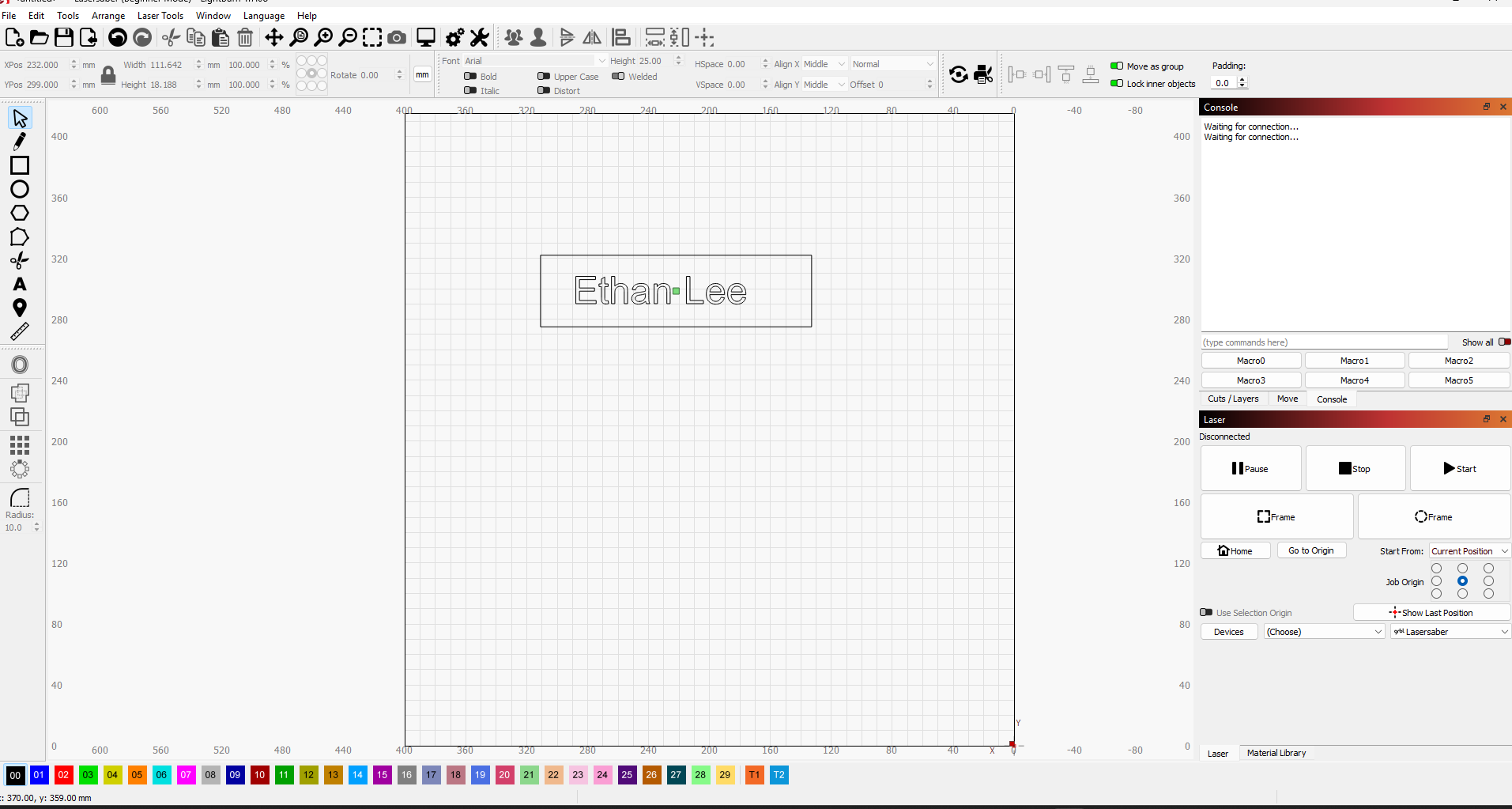

Try this. Set the origin (in device setting ) to lower left. Turn off auto home on startup. Turn off the laser. Slowly move the laser head to the front left corner. Turn on the laser. Using the arrows in the move window,move the laser head to near center of the work area. Try to engrave Ethan Lee. Report any errors or successes.

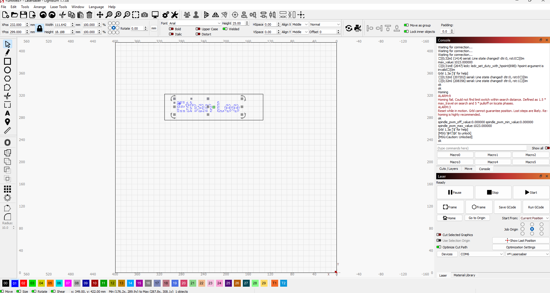

I did this and this is what the alarms are saying. So usually it alarms when I turn it on but When I first turned it on it did not but when I pressed the move buttons it started.
I then attempted to follow your directions again, made sure the settings were still correct and shut off the machine, slowly moved the laser to the front left and turned it back on (Because it said to reset the machine in the error code) and turned it back on to this.
[MSG:Reset to continue]
ALARM:1
Hard limit triggered. Machine position is likely lost due to sudden and immediate halt. Re-homing is highly recommended.
