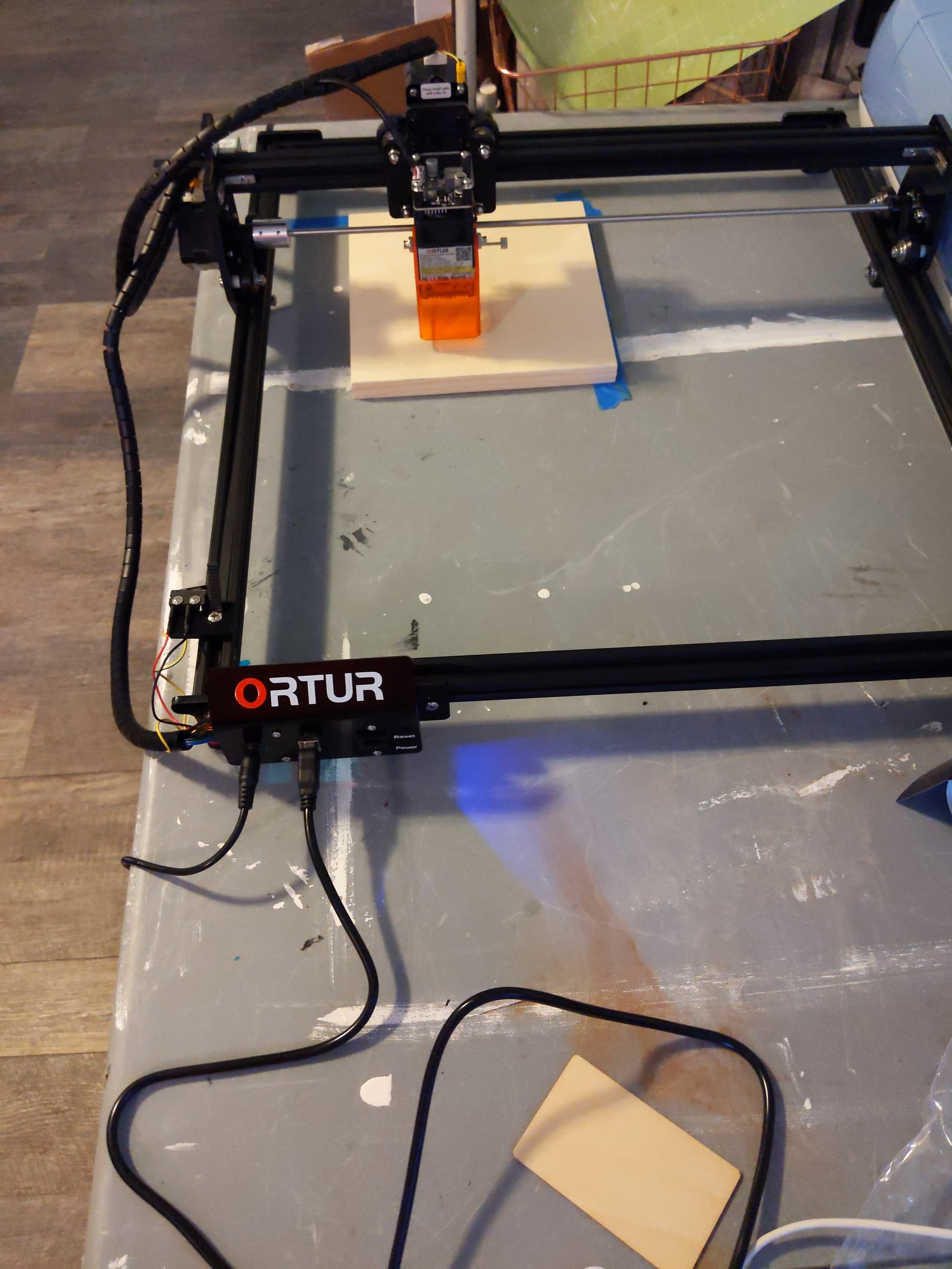

Hi I keep getting g-code motion target exceeds machine travel machine position safely retained alarm may be unlocked. I’ve read all of the other advice for this error code. I can confirm:
  1. that it is set to absolute coordinates
  2. I can confirm that there is nothing in the machines way
  3. I can confirm that I’m asking it to operate within the confines of the machine space. I’m not sure why I keep getting this error but it’s very frustrating me.
What speed are you trying to go, and do you have Overscanning set for that layer? If so, what overscan setting do you have?
