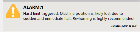

Hi, I am a newbie, so apologies if i have this wrong. I have a Blaze M Pro 10w diode. I have configured and connected to Lightburn on GRBL. When i unboxed 2 weeks ago i managed to burn a very poor test. Unable to aligned correctly etc etc.
Today i am attempting a test piece and when i tried to Frame it gave me the following error.
Hard limit triggered. Machine position is likely lost due to sudden and immediate halt. Re-homing is highly recommended.
the laser will move an does re-home, but i can not get rid of this error! Ive tried everything i know. Can anyone help please.
Thanks
Hi Andy
Check are you using ‘Absolute coordinates’, if not set it that way and retry.
