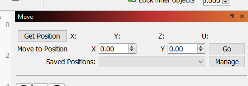

In your move window at top should be X0, Y0 at home. Set your work area here.

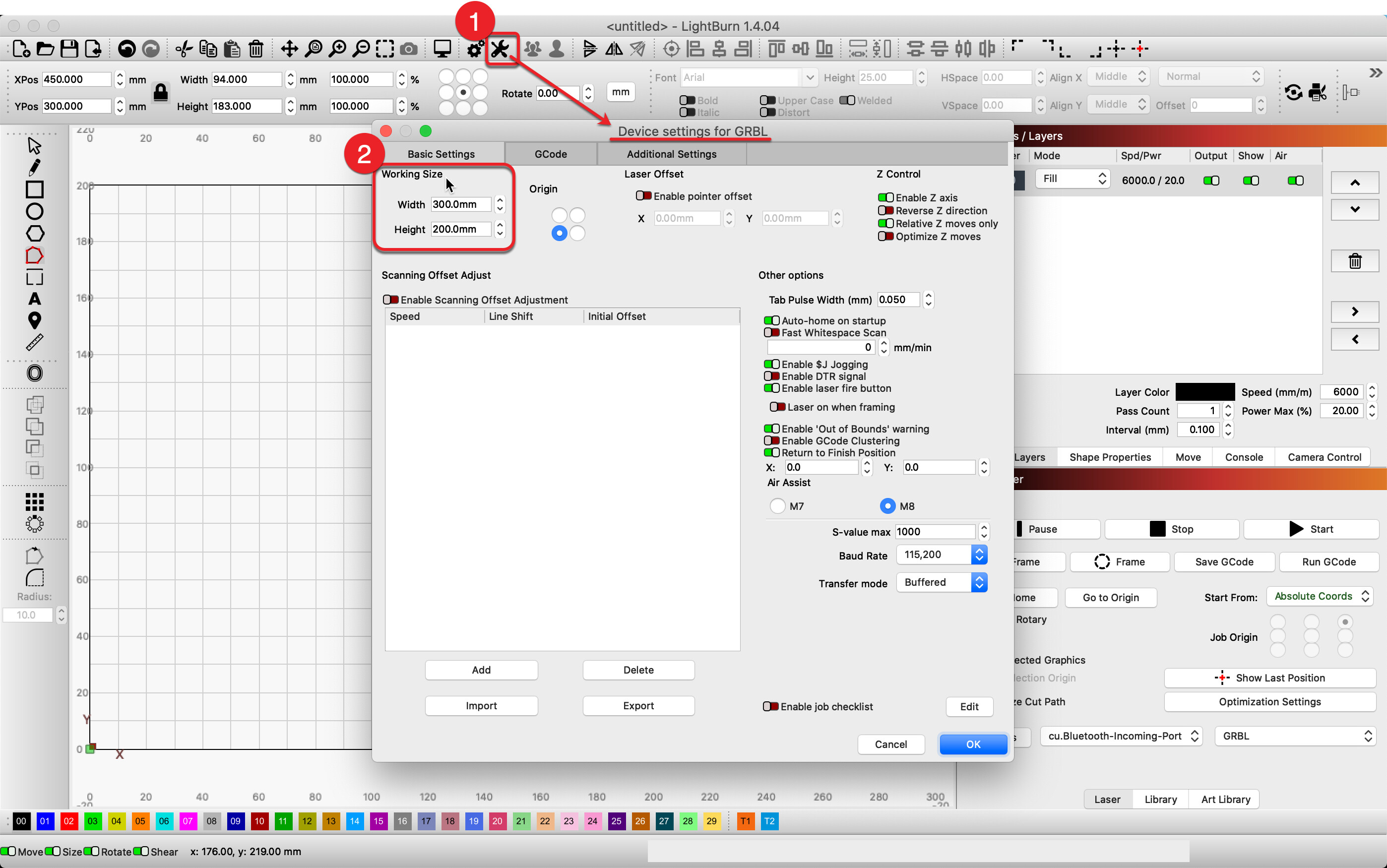

I guess what I am asking, How does Lt burn set the limits to the work are and how do you adjust those limits?
I don’t have those options in the move window
Your move window looks like this?
yes it does
Home it and click get position. What does X, Y report?
0,00 and o.oo
You can change the workspace from the ‘Device Settings’ window for the selected Device Profile. Click ‘Spanner / Screwdriver’ icon near top-center.
