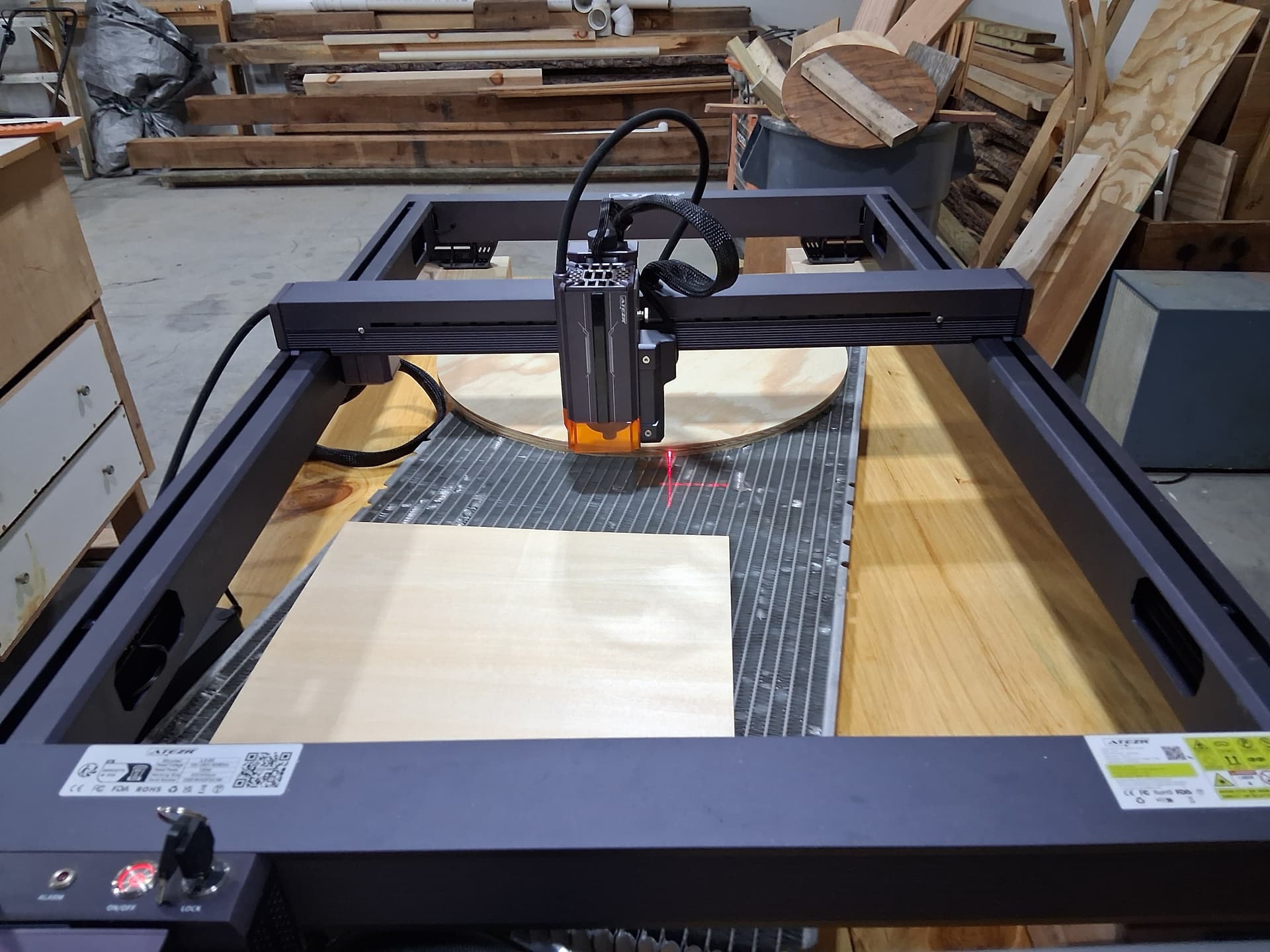

Error reading with my Atezr L2
I admit I am clueless to this. I had it running and then installed the extension rods. Now I seem to have this all messed up. I have tried changing the x,y axis coordinates and also reset the lazer I don’t know what to do now. Can anybody help me out?
definitely check your wiring first. It could be the limit switch is connected incorrectly after you added the rails.
Have you already gone ahead and adjusted the length in your firmware settings?

I would change these back to what they were
Yes I have I think I have adjusted them through the Lightburn but I do not know how to adjust them in the firmware. When I added the new bars there were two places to put the limiter switch maybe I put it on the wrong end. I put it on the end near the head but it could go on the other end I think. I tried adjusting them back in lightburn but I am really getting confused. Sorry I am an old gut and not good at this computer stuff
I am beginning to think it is a hardware problem. I found that one of my limit switches was not plugged in and when I plug it in I still get the same alarm but now the head will not go anywhere. I tried it with an old project in Lazergrbl. The head when to the center easily and then stopped and would not go in any direction after that. Any suggestions
