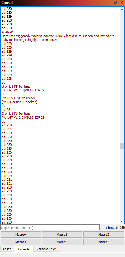

Surprised Hard limits are on
I suspect the issue you have is the pull-off is a bit too close for confort
Or your belts are a bit loose

Those errors output are not normal

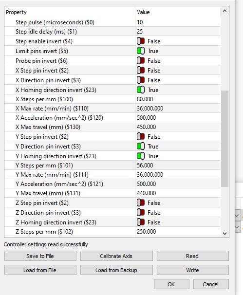

Once I tried to connect Rotary Roller, and I set "Y steps per mm ($101) to 56.000 (using manual guide). When I disconnected Rotary Roller, I hasn’t changed settings back (because I didn’t know what settings were before). Maybe this is what causes this problem. I am very new to this. I am lost ![]()

make sure $130 and $131 are the same value 80

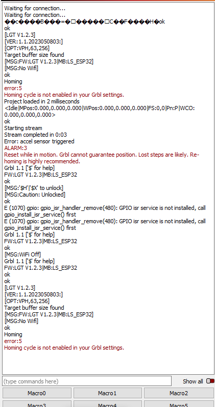

I did all steps and worked. But then I tried to run it again, and I got errors like in the screenshot.
Also, I changed $130 and $131 to 80. It was 450 and 440.

ok lets pick this apart
Few things that seem odd

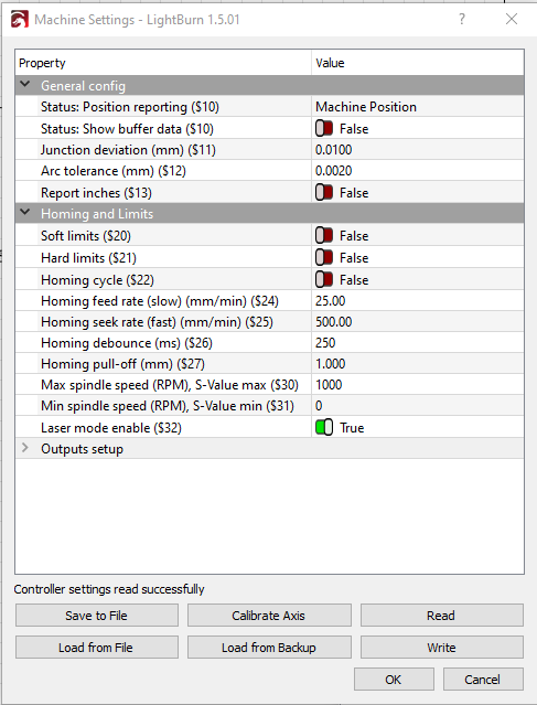

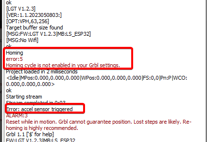

a) your homing is disabled, meaning your $22 is set to zero
b) you getting an accelerometer sensor trigger, this might be as machine smacks against something
did you $RST=*
And if so does homing get disabled

Yes, I did $RST=* and immediately errors stopped. Then, I entered $21=0, and I changed $130, $131. And ran a test.
Longer B1 40W. Yes, it has limit switches.
How to enable $22? What settings should I input?

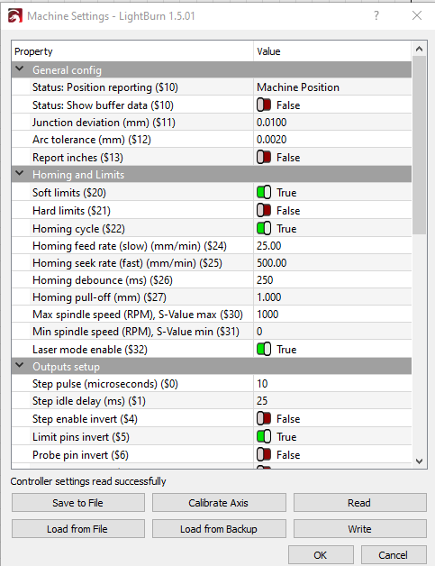

Update:
do this and NOTHING else
$22 should be 1
$21 shoudl be 0
by defaults
So just do reset defaults command and touch nothing else
SEe how it homes
