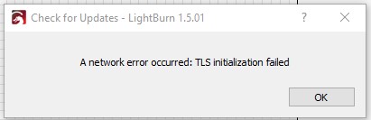

This is the error that I get when I try to update my machine It is a Microsoft windows 10 32 bit machine
Screenshot_2
lightburn error 2
That’s a well-known bug with version 1.5.01. Just download the current version from the website.
The second box, I’m assuming you went to the LightBurn website and downloaded the latest version. Unfortunately, 1.5.06 was the last version of LightBurn to support 32 bit windows. 1.6 and later are only available for 64 bit windows. 1.5.06 is available here:
https://release.lightburnsoftware.com/LightBurn/Release/LightBurn-v1.5.06/
