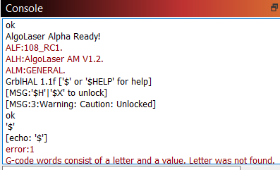

Error1 issue since updating to latest version
prior to updating to latest version , havent had any problems with laser or software now i get this error, if if i try a material test same error, any help pls
Check if “gcode clustering” is enabled in device settings. Looks like the gcode dialect you are using is incorrect.
Hi yes for some reason it was unchecked
when i turned it on it said need firmware ?
whee would i find the firmware
No, it should be turned off in most cases. So just leave it off. A new firmware is usually not required. Maybe you selected the wrong laser type?
